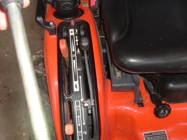

Danny, good to hear from you, the building is new, cheap and quick. I have slept since I put the lights on so I had to run out in the cold to refresh my memory and now you have really put me into a quandry, if I tell you how I did it, the safety police will be knocking on my door and I can't fight them off with one arm, and if I don't, you'll be over here twisting my bad arm to get the info. /forums/images/graemlins/tongue.gif I'll take my chances with the safety police. I used the wire under the seat for power and put a switch in the panel on the right side of the seat, then I drilled a 5/16" hole in each side of the ROPS down close to the bottom in the back and a 1/4" hole up where I mounted the light and fished the wire through, the lights are grounded at the mounting stud. I mounted the lights with a 5/16" self tapping bolt.
