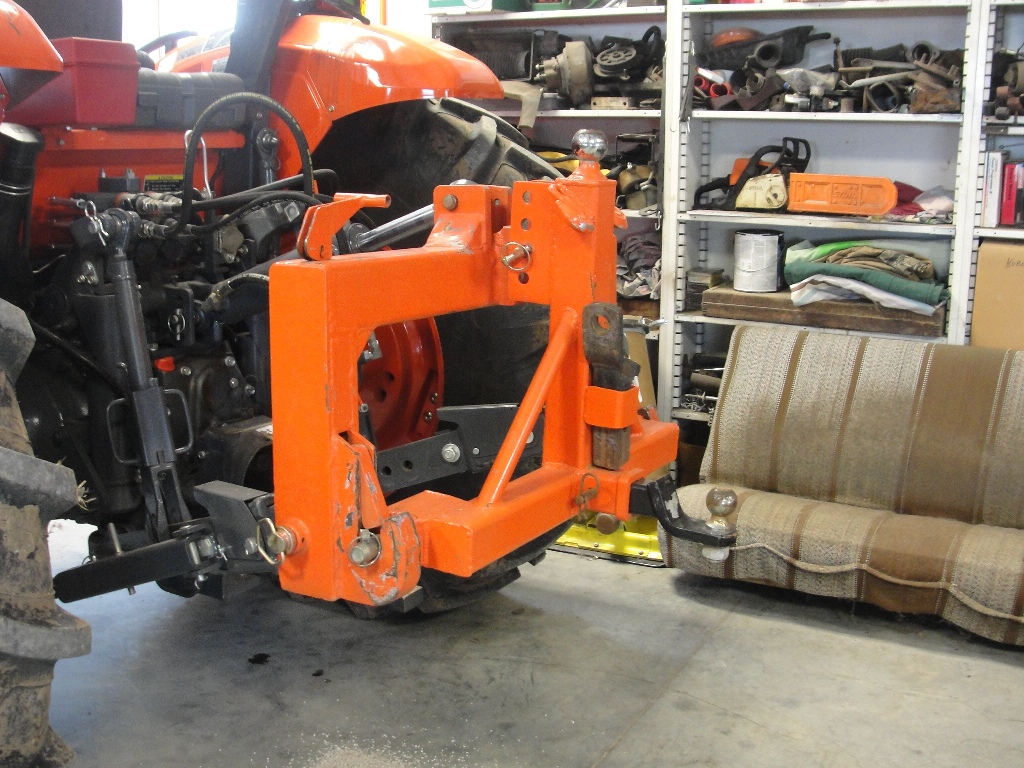

Nice build. Very useable attachment. I built one a few years ago as a Winter Shop Project and use it more than I ever thought I would. :)

Here's the best I've got now of the top link area. I think you are missing a critical part there.
