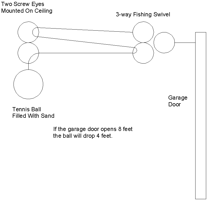

I'm going to try this. If the garage door opens 8 feet, the ball will drop 4 feet.

   / New Product for crowded garages. #18
I may be mistaken (wouldn't be the first time) but from the diagram you show, when the door opens 8' the ball will drop 16'. Just backwards I think. After I looked again I think It'll drop 24'. You have 3 runs of 8' that will copact to 0' when the door move 8'. 3runs x 8' = 24'.

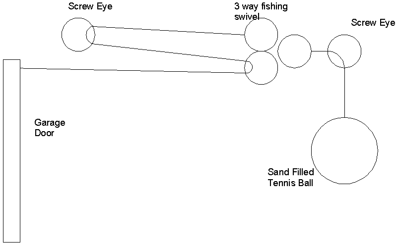

   / New Product for crowded garages. #19
DOH! Would this be better?

   / New Product for crowded garages. #20
According to the diagram, when the door opens 8' the ball will drop 8'. You have to think like it was a system of pullys or block and tackle. The correct way is to tie off the end that now has the tennis ball on it and attach the tennis ball to one of the loops with a screw eye. You then can adjust the ball drop by the number of loops you make between the tennis ball and the ceiling. That is the same principle as a block and tackle. That is why when you pull on the rope 10', the object you are lifting may only go up 5' or 2 1/2'.
