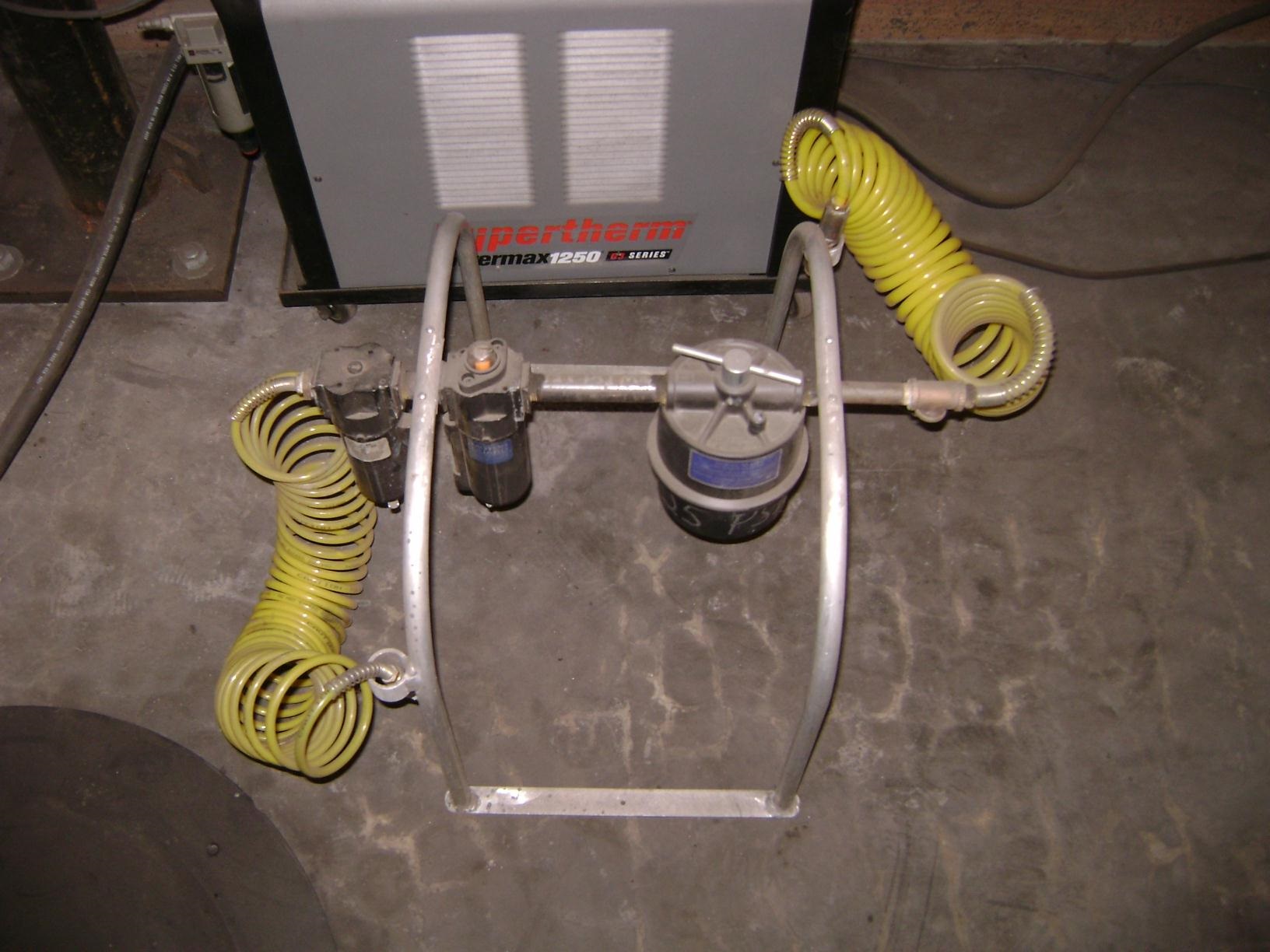

Here's an example of what I WOULDN'T recommend doing:
Many years ago my on staff farm mechanic plumbed together a "home brew" version of an air dryer complete with cooler and wired to eject moisture at the end of each cycle.
It has worked flawlessly so far and does an EXCEPTIONAL job of providing dry air for painting and plasma cutting.
BUT. The day my compressor packs it in I'm left with a bunch of miscellaneous hardware. In retrospect it would have been cheaper in the long run to purchase a refrigerated air dryer similar to the one Shield Arc has. ( Carl, please post pic?)
Pic of "what not to do":
Terry

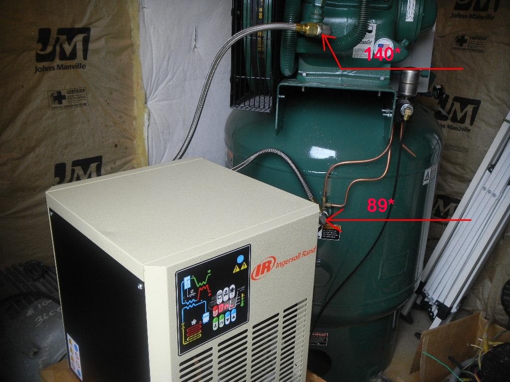

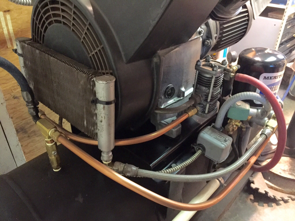

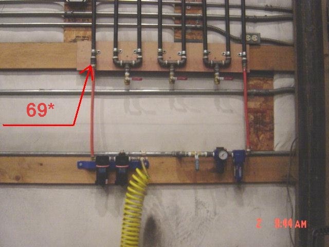

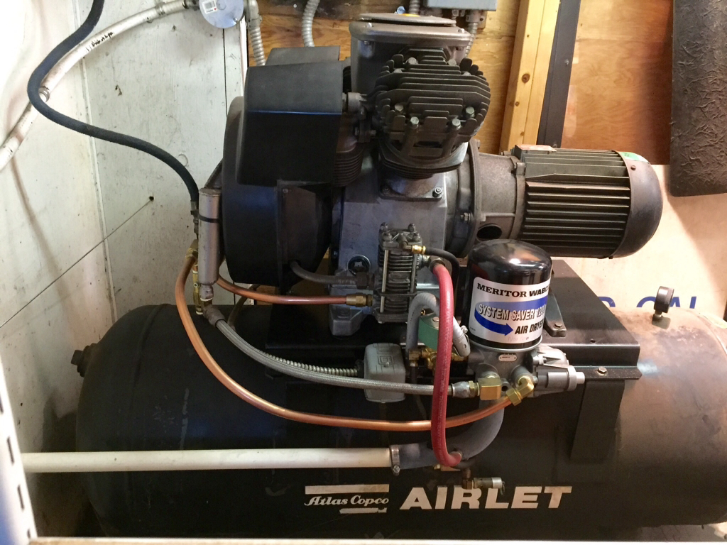

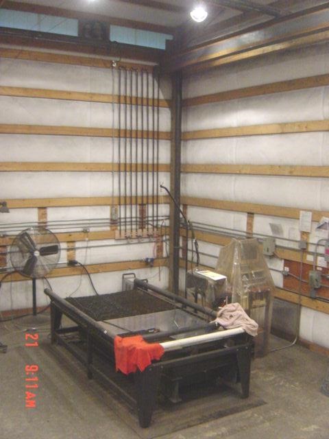

You mean these? :D
   / New Powermax 45XP! Crap... I was just about to pull the trigger! #10
Shield Arc:
Thanks for the pictures. I am in the process of installing a home-made black iron pipe cooler and water separator much like yours. I can't decide between vertical pipes like yours and horizontal pipes. That's because I am not sure what is actually happening in the system.
It seems that the air is cooled by contact with the pipes, so the amount of cooling should be about the same in the vertical and horizontal configuration. I read that the moisture is removed by the changes of flow direction; i.e., the elbows, which explains why you have a drain valve at the bottom of each turn.
The horizontal configuration would actually have each pipe section on a downslope in the direction of air flow of 2-4% so that all condensation would naturally flow to the bottom section and a single drain valve would serve.
I can't decide whether vertical or horizontal would work best at removing water; there is probably no difference.
If there is no difference in cooling or water removal, then I have to weigh the few extra drain valves of the vertical configuration against the hassle of having each horizontal tube actually slope down a couple of degrees; I think that would involve actually bending the pipe after putting the thing together,which seems like a lot of work for no or little gain.
I would appreciate your thoughts.
