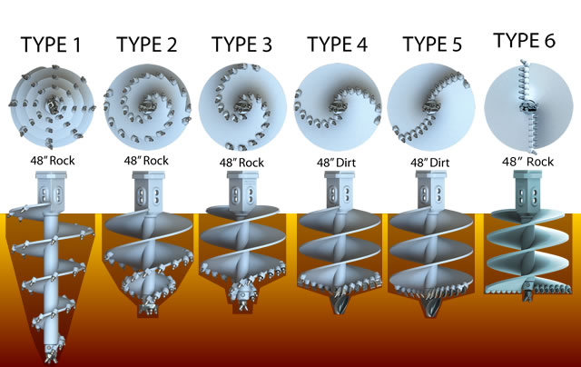

If you want to auger holes in rock, you might try these.
