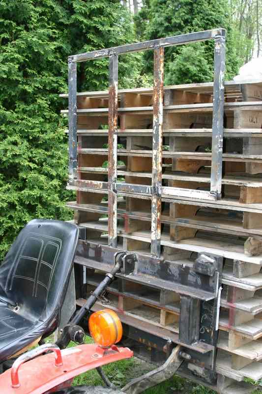

Here is a forklift I made with 3' forks I got off ebay for $120 + $75 shipping. I have another $45 in it for steel. This is on an 18HP Yanmar. I just ordered a John Deere 4310, which will lift a lot more. I ran a stress analysis on it and see that I will need to beef up the upper angle iron a little. The width between forks is adjustable. One I get it finalized, I will sandblast it and paint it JD green.
