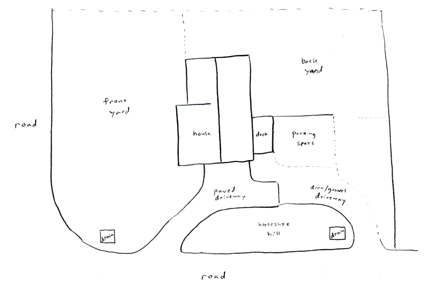

I'm planning to use the tractor to finish grading the unpaved half of our horseshoe driveway and dig out some parking spots next to the deck. Removed dirt will be used to make the slopes down to the roads a little more gradual (they probably average around 45 degrees, but have some flat portion at the bottom that I'd gladly sacrifice for a more gradual slope overall). Pretty much everything on our property has some amount of slope except for perhaps a very small portion of the front and back yards closest to the house. I've got a 6-foot rear scraper blade, the scoop, a middle buster plow (also going to make a ripper tooth for that), and a 4-foot box blade with scarifier teeth. Hoping I can do what I need to with those implements. I'm sure a loader would be nice, but we'll see what I can do with what I've got for now.
