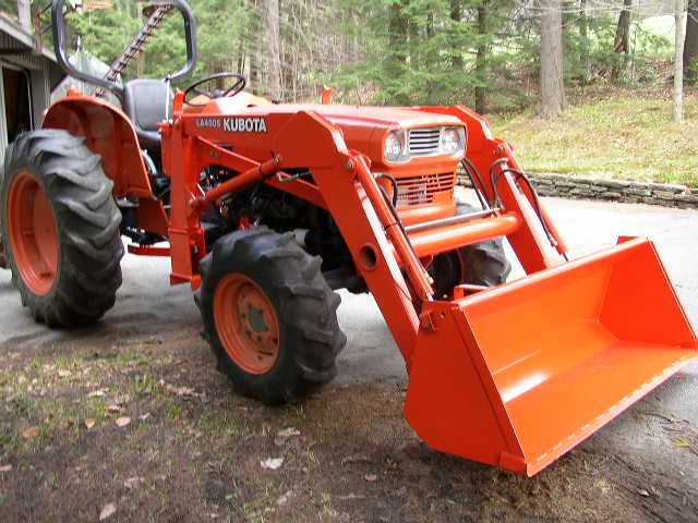

IMHO the L295,L305 L345 and L355 showed the well-above-average build quality that earned Kubota its reputation. Even at more than 30 years old, they often sell for almost the same dollars they sold for new. I think you got a nice deal. Regarding transmission oil, general purpose tractor hydraulic fluid from Agway or WalMart are fine. (don't use 80w - much too heavy for the hydraulics) The best manual I've ever found for these models is the original Kubota illustrated parts list. It has nice drawings of every inch of the machine - makes working on it easy. Welcome to the club and good luck with it. Dick B

Now THAT'S a nice lookin example of an old L.:thumbsup:
Hadn't thought about using a parts list in this application. Don't know why, I use'em on boat motors. :duh:
Thanks for the heads up on the fluid. It's tough tellin the actual level of it with the dipstick cause it's just way clear.
The prices I was seeing on other tractors when doing my research led to a quick decision on this one when I tripped over it at the dealer. And the 30 day trade back was also key. But I don't think this l'il bugger is goin anywhere for a while. :cool: d:^) Schneeks..

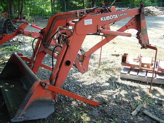

The LA450 loader really does lift off easily. Only a few frame parts stay on the tractor. 2 wedges on the uprights and two levers in front - then the whole thing tilts up and rests on prop rods. - if the bucket is whole and the pins/bushings aren't too egg-shaped it may be worth grabbing. It's rare to find a easy-fit removable loader for these early Kubs. Some people look for years and finally settle for a high price or poor fit, or both.
