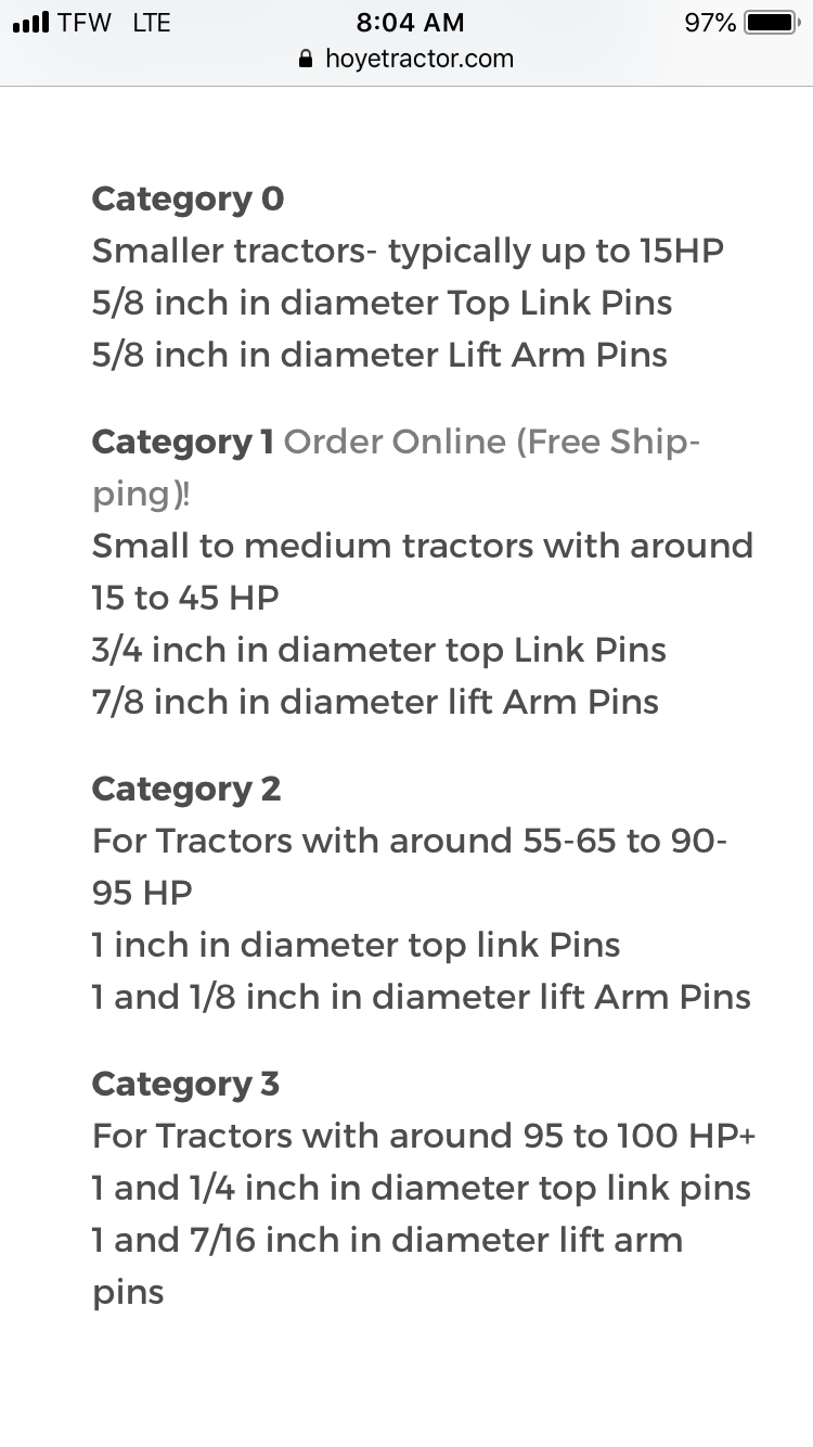

I have a message in to Hoye, but does anyone know where I can get a category 1 adjustable side 3 point arm for my Yanmar YM165?
What I see on Hoye appears to be a Cat 0. What I have right now is a Cat 1 as it fits all my Cat 1 attachments.

I believe the Hoye link is a category 1. What does your existing one measure?
   / New Owner of a YM165
#108
Not able to measure at the moment, but I will take a measurement soon. I am pretty confident it is 7/8” though.
Here’s a screenshot from Hoye that makes me think the arm they are selling is not Cat 1.
   / New Owner of a YM165 #109
The top link and lift arms showing in your Hoye attachment does not reflect your adjustable side link size. Different animals.
#110
Wow. I feel stupid. I understand what you’re saying.
