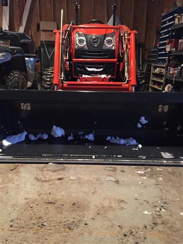

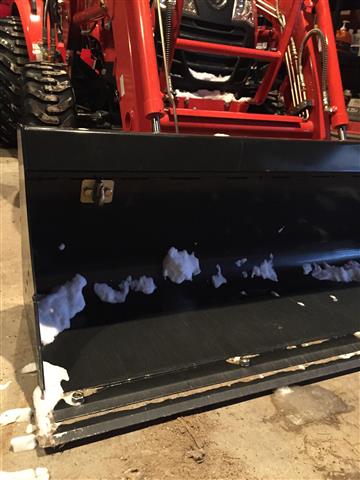

I have just purchased my first tractor and I ordered bolt on bucket hooks when I went to install I noticed the top of the loader bucket is double walled and has a void that I won't be able to get a good hole thru I have a ck35 with the kl4010 loader anyone come across this issue before I guess I should have looked at the bucket a little closer before buying the hooks

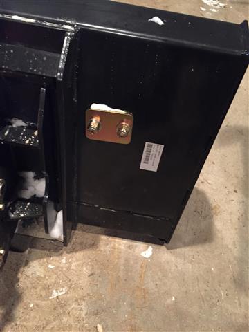

I actually used your hooks I bolted them thru the back side of the bucket and the hooks are inside the bucket they will actually work well and have the support of the QA ribs near them

This is how I did mine I may convert the back plates to clevis hooks

Pics from Lt706:
