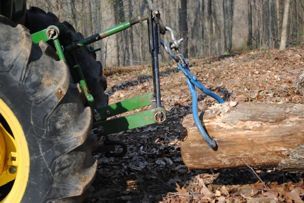

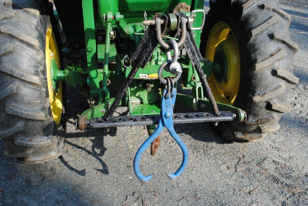

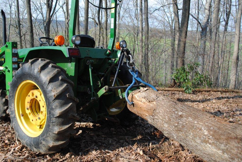

I am looking at dragging some fallen trees out of my woods to cut up and sell for firewood and having not owned a tractor before I am unsure of how to do it and what potential risk of damage there is to the tractor.
(Really what it comes down to is I don't know the limitations of the tractor)
I pull logs out of the "bottom" with my 870 and had a pretty severe learning curve. Initially I pulled them with the drawbar but by the time they finished rolling around in the dirt the bark was stuffed with mud and that was murder on the chainsaw. Also the front of the log digs in and really cuts down the size of log you could pull. I came up with this gizmo to pick up the front of the log a bit.
But like most things, there is a downside-
My tractor pulls like a mule and the temptation to pull too big a log is always there. A load that's fine on level ground will quickly bite you in the behind going up a hill. Don't even think about going across a sideslope. If one of these guys decides to start rolling your tractor probably will be right behind.
Don't pick the log too high. 3-4 inches is plenty (early on, I found myself looking at clouds when the front end got light.) I usually cut a 5 foot log to put in the bucket to help keep things where they belong.
Wear your seatbelt and take your time.
Don't overload your tractor. I'd rather make a few more trips than pay for $$$ drivetrain repairs.
Here's a neat website that allows you to calculate the approximate weight of a log:
Log Weight Calculator at WOODWEB
Have fun and stay safe!

The 870 is rated at 28 HP and weighs 2670 lbs.
The 3038E is rated at 37.1 HP and weighs 2087 lbs. (Both w/o FEL.)
All things being equal, (through the magic of gearing), the heavier tractor will usually pull a heavier load. (Not busting your machine, of course.)
The log in that photo was actually run of the mill.
