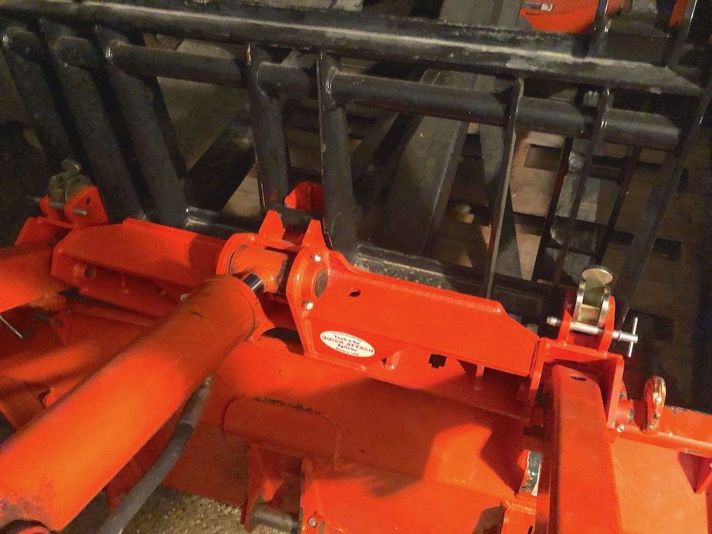

If you go with a used or new BX, I can highly recommend Jery's Tach n Go. I bought the QA and also the adjustable forks. Researched a fair amount and was impressed with the light weight design that did not significantly reduce the lift capability. Two simple levers and quick release pins. I routinely swap out my bucket and forks without hesitation.
