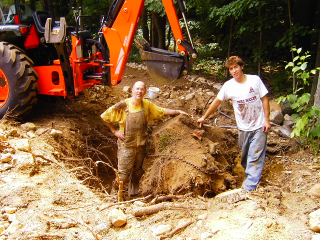

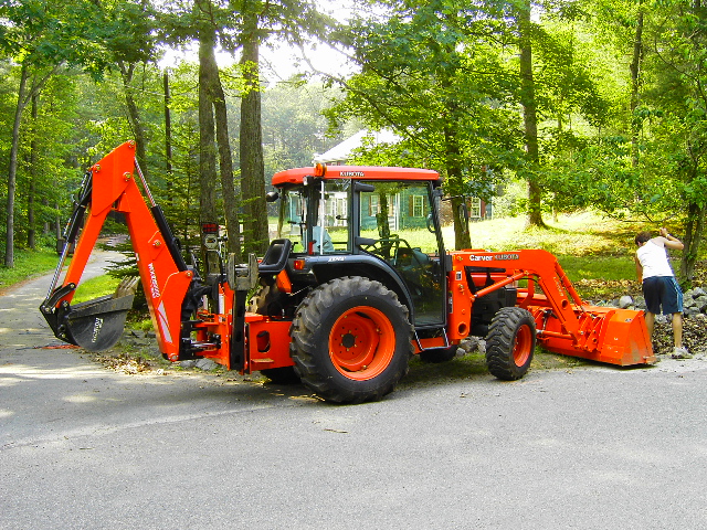

I have the attached set up. It includes a 2005 Woods BH9000 back hoe with about 20 hrs on it. I love it but I am selling the BH to get the newer, BH90 with the hydraulic thumb. Anyone looking for a unit like this, I doubt you will find one with so few hours on it. They are powerful machines. I dug up this full size oak tree stump in about 45 minutes. It was a new stump. I cut the tree down the day before.
