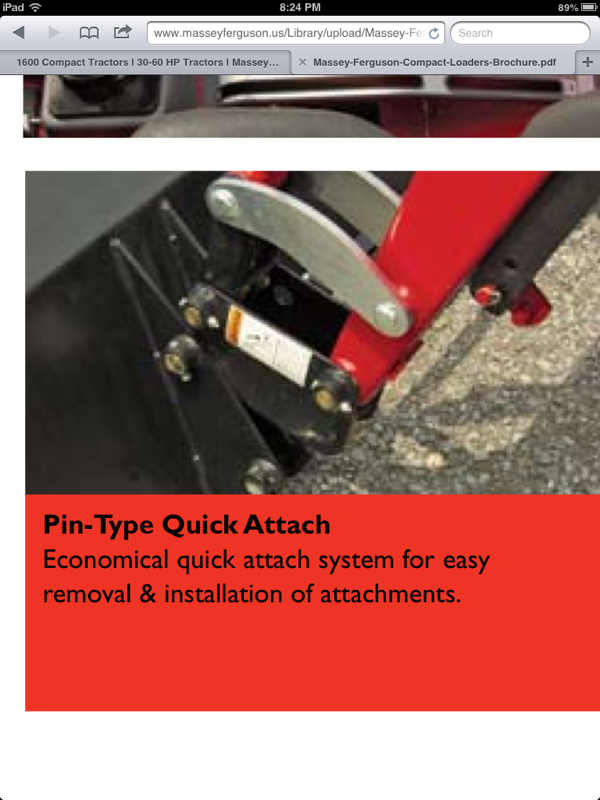

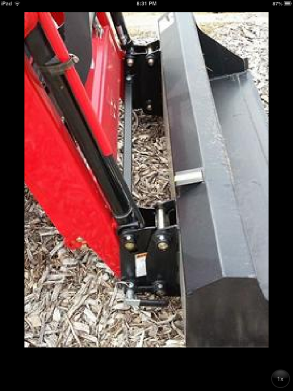

Dumb question probably ... is the skid steer quick attach different than the normal quick attach?
   / New MF1635 on Order - Accessories? #15
well someone will correct me but my MF had two options, the SSQA and the "pin" attach. The pin attach has about 7 pins on the bucket that hold it on in various places, that have to be R&Red when you change attachments. The SSQA has two springloaded pivot arms that you swing into position, easy as pie. The SSQA also is a std that allows you to get many attachments from different vendors instead of perhaps being tied to ones only from your tractor brand.
there is a penalty i think in that the SSQA is heavier than other systems (big steel plate on front).
   / New MF1635 on Order - Accessories? #16
The SSQA does not use a plate. Will upload pics.
2 levers with SSQA, or 4 pins without - Go SSQA.
With the lift capacity of the DL loaders, and the axle capicity of the 1600 series, you will not notice the minimal loss from the few extra pounds.

Here is a couple of pictures of a pin type quick attach. I really think the SSQA would be a lot stronger
