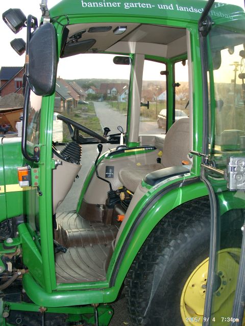

Another pic from the cab

Another Cab Pic from the other side

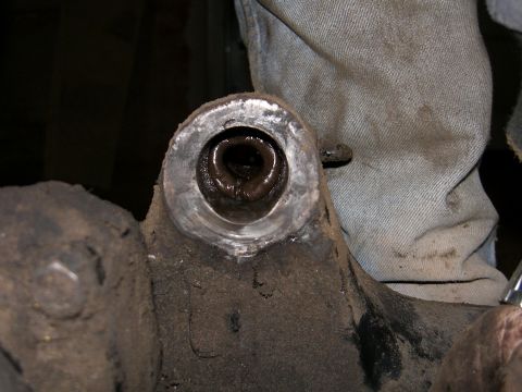

Front Axle housing from a 955 wear out by neglected greasing; could be repaired

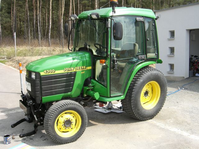

955 without clothing; ready to get new colour and total service

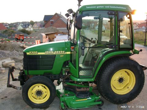

sorry but my cab doesn't have the escape roof; I think it's only on the 20 series and not on the 00 or 10 series tractors.
About the front hitch i would say it's not necessary if you have a fel but if you don't have a fel it's a pretty useful thing; i have a knob on my dash where I can electromagnetically switch on my front pto even if I have the MMM on the tractor; that's only possible because my tractor has a separate gear box in the front which is driven from the crankcase ( I hope I used the right words ).

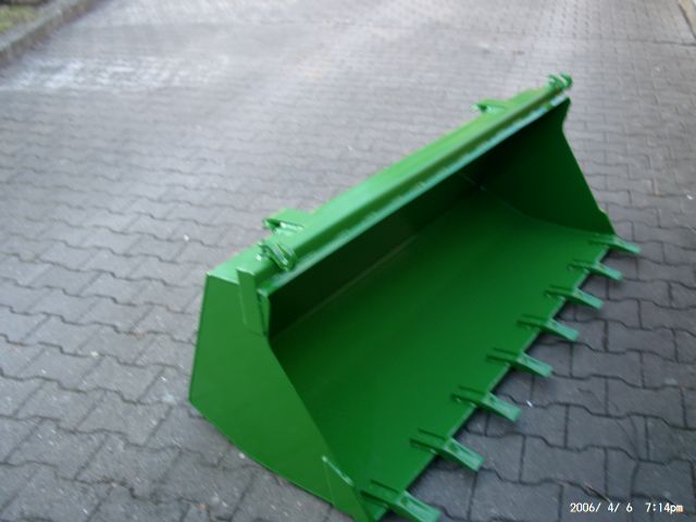

Your home made bucket looks great. I can't wait to see the grapple! I am going to add one soon, i hope.

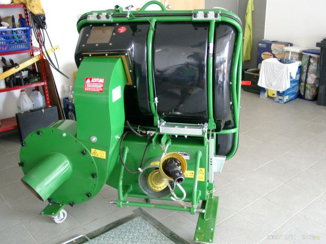

The rear pto goes into a gear box where are several drive belts and one of them goes to a turbine with 8 shovels packed in an iron canal who goes in a fiberglass box with perforated lattice where the air, produced from the turbine, can go out from the fiberglass box because the turbine produces a lot of air !!! The grass is moved because of the negative pressure produced from the turbine from the MMM's right side through the hose into the turbine canal and then into the fiberglass box. If you put the hose away from the turbine and bring your hand near the turbine it will cut all your fingers and you wouldn't realize this. It's like a knife, a green knife !!! an an expensive knife. You can get several collection boxes with various cubic; i have an 550 liter box, the next one is a 750 liter, then 1200 liter and the highest has 2000 liters!! If this box is full you even get problems with an 3720; last week I drove a 3720 with emty 2000 liter box, 300 CX loader and 72" MMM and it really bogged down when i suddenly went to max speed; after a while the rpm's raised up to 2700 per minute and I was able to drive about 33 km/h.
Attached is a picture with a grass collecting system built in Germany; the tractor is only a 455 and not a 4300 but they are also availible.
