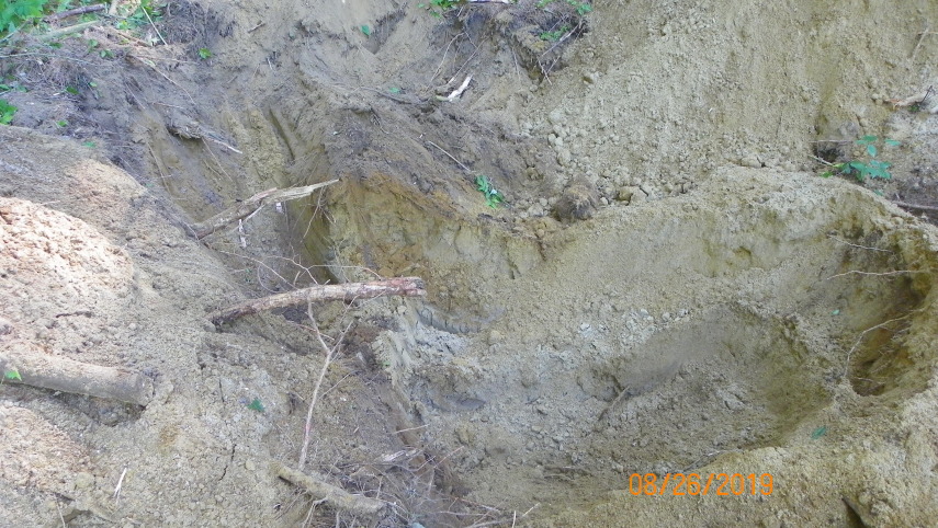

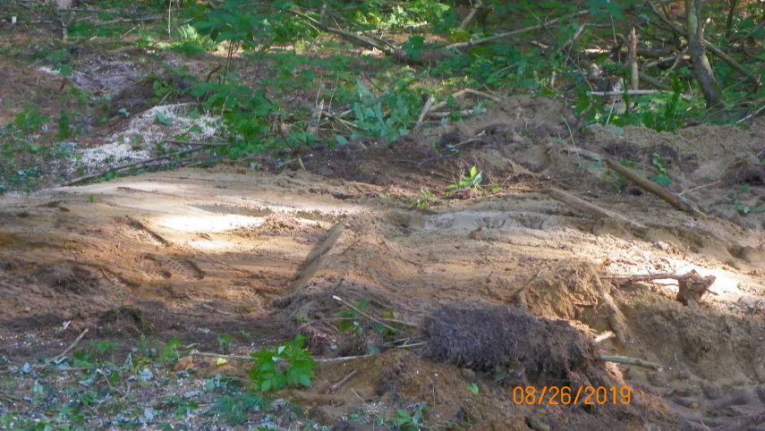

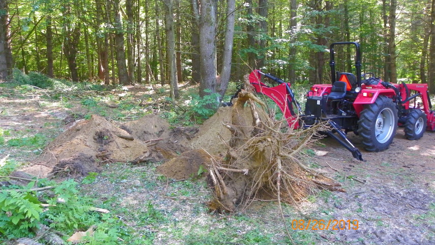

I pulled a stump today from a new area we'll use for a walking trail and snow storage in the winter.

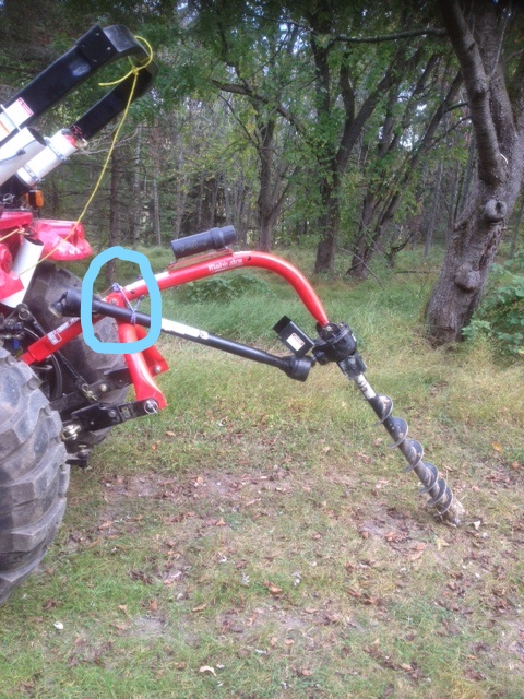

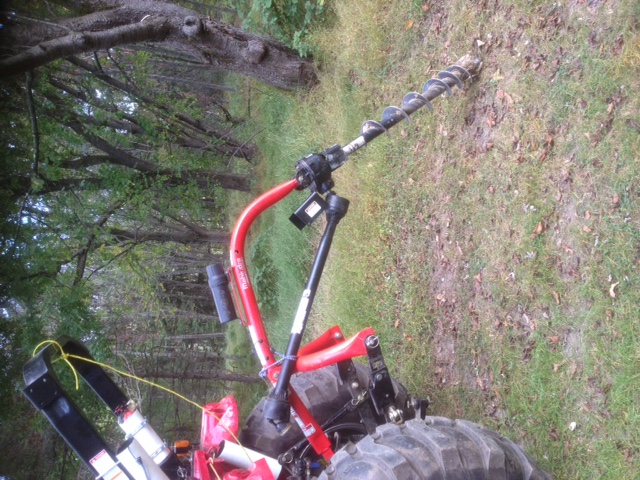

Welcome rifleman, not sure what PHD you have but if it is the one like mine where the top of the bell bolts through one of the holes on top boom i would weld additional support on top of the boom right over the holes. my boom bent right above the pivot . seems to be a weak design. i noticed other PHDs are designed differently. good luck and have fun.

I値l check it out whenever I pick it up. Dealer didn稚 have any on hand and had to order it. Kinda surprised it is taking so long for suck a common implement. Mind shooting me a pic of what your describing?

you can see where the bell/loop top bolts through the top boom. that is where you can see it bent down some. you see it circled. InkedIMG_0891_LI.jpg

That is a very weak design and I hope mine is different. Since he didn't have any in stock, I didn't get to see what it looks like. Most others have a piece of plate welded on that actually has the bolt holes for the loop. Bolting them thru the actual boom is shoddy at best. Looks like I'll have to do some reinforcing for sure. Thanks for the heads up.
