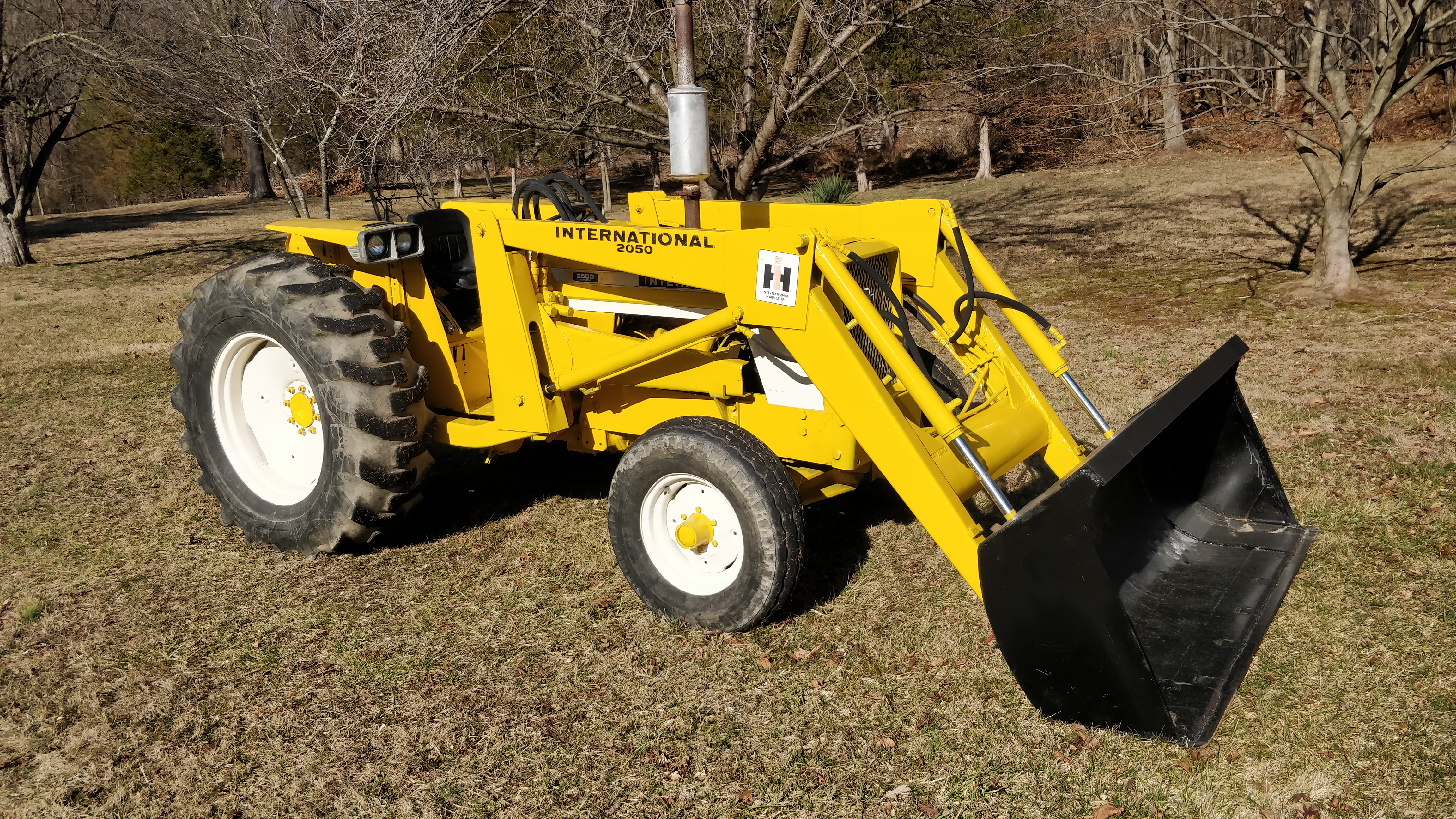

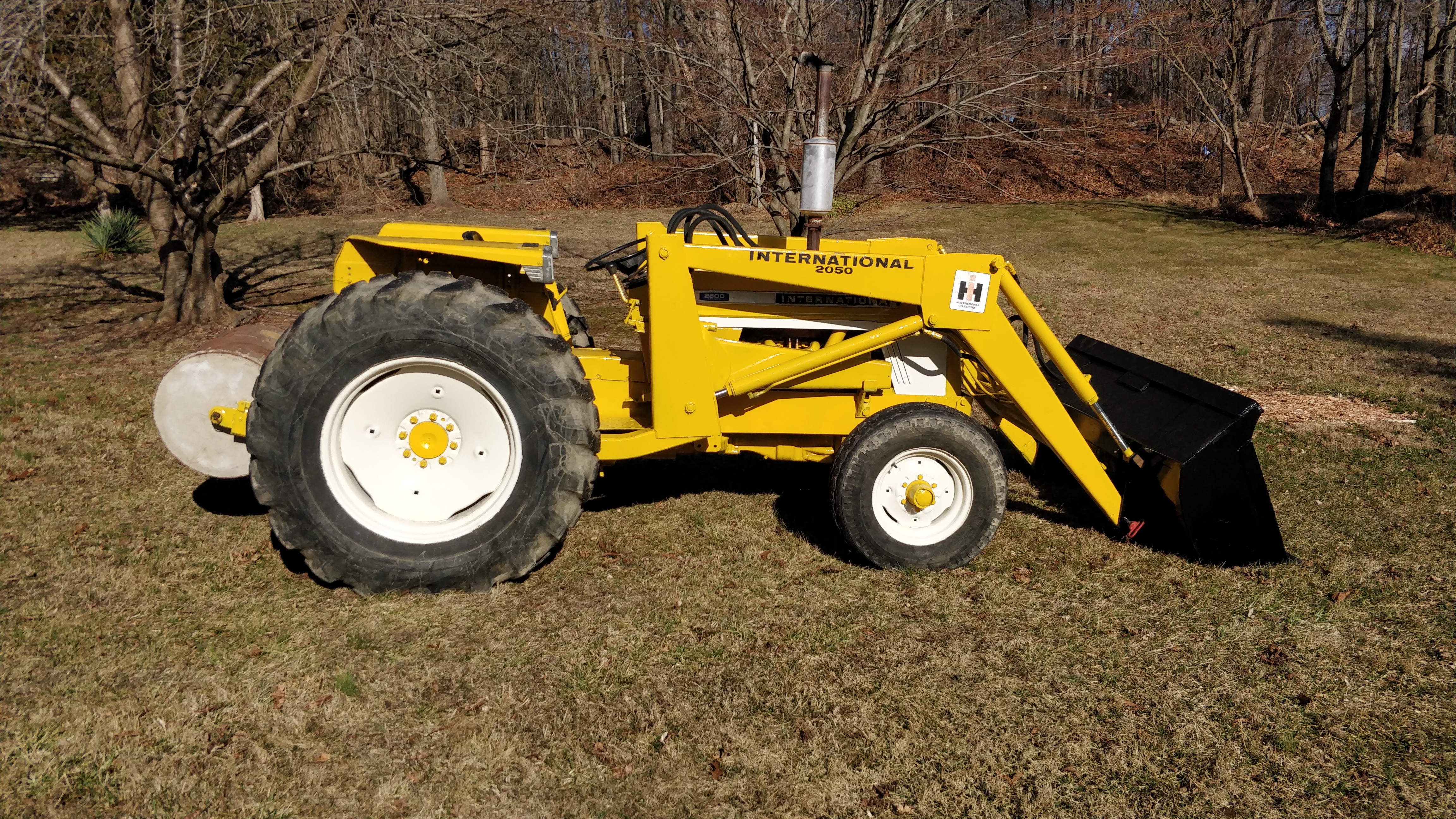

Hello!
I've just purchased a 2500a with 2050 loader. Photos attached.
The PO did a 6-foot paint job (looks great from 6 feet away), installed new clutch, water pump, and resurfaced the flywheel. Overall in pretty good condition, gas C-200 engine.
The seller claimed it's a '77, but I'm not so sure--TractorData (for what it's worth) shows the 2500a only up to '74, and then the 2500b. Before I went to look at it, I was sure it must be a 2505b, but sure enough the number plate says "I2500-A" and all the badges say series A. Ok then.
The serial number is broken at the bottom left corner, but near as I can tell the first digit is '8' making serial number 8340013U000780.
I bought the operator's manual and chassis parts manuals from Jensales. The parts manuals treats the 574 and 2500a as identical.
I sold my '64 Ford 4000 to put some funds towards this tractor, and the controls of the position/draft control are a good bit more complicated but I think I'll get used to it. I loved that Ford but this IH feels like a step up in heaviness of build and capability.

Thanks for any suggestions you can offer, and if anyone is looking for a part number (for the 2500 or 574) please feel free to message me. IMG_20200214_145735.jpgIMG_20200214_145720.jpgIMG_20200214_145708.jpgIMG_20200214_145735.jpgIMG_20200214_145720.jpgIMG_20200214_145708.jpg
