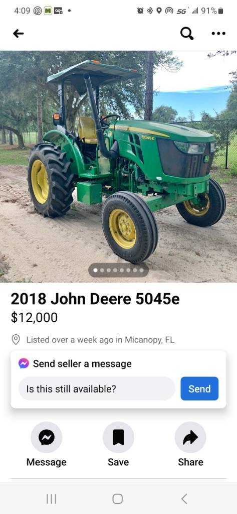

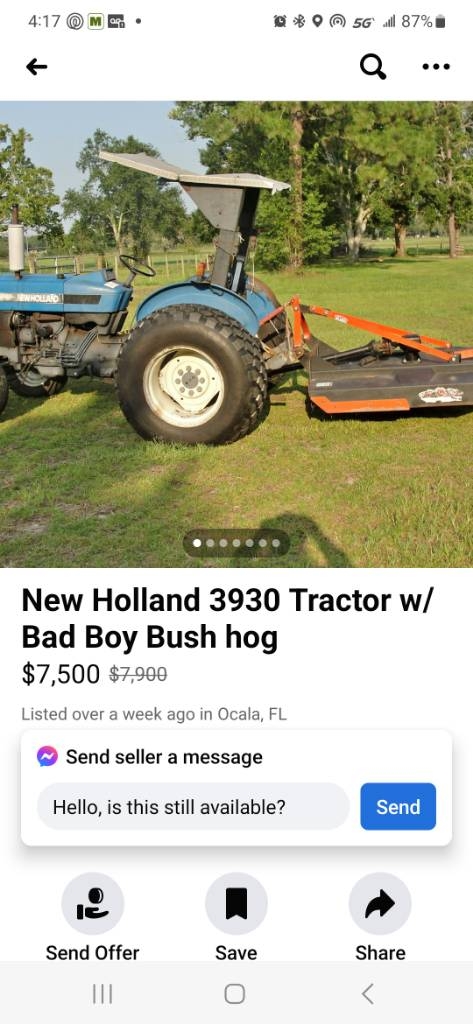

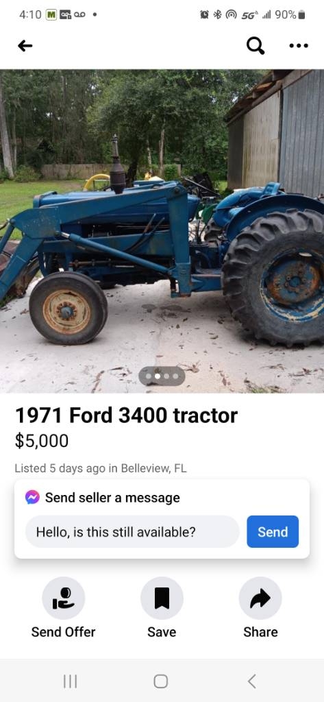

A local sample (not affiliated). 1971 Ford 3400, with loader (bucket needs some welding, it's rusted through in corner) for $5000, it's gonna handle Maybe a 7 ft (prob a 6?) cutter; and a very nice 2018 JD 5045, that Might pull an 8 footer (prob a 7?), for $12k, no loader. And, I feel, the middle of the road, best deal, a New Holland 3930, with 6 ft bush hog, in great shape, $7500. If you can live without a cab/4wd/loader, you can get a lot of machine for under $10k

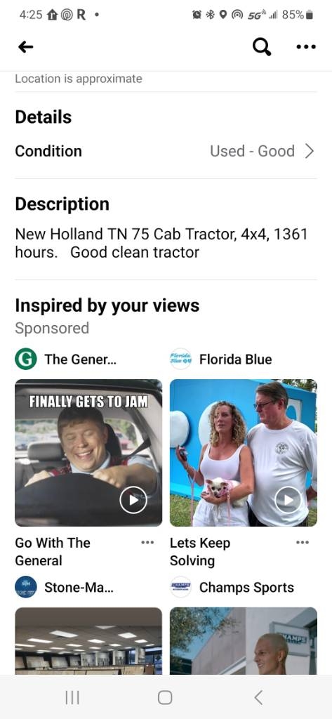

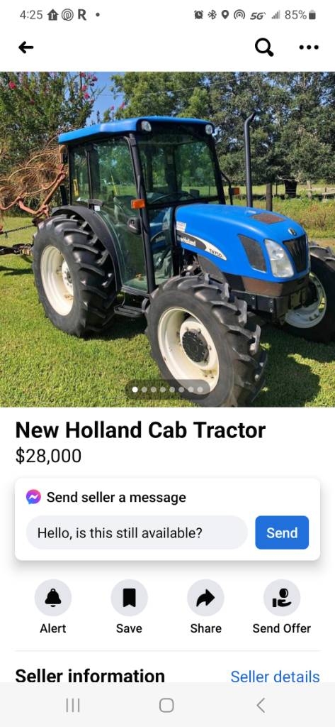

On the nicer, more expensive, and better large machine. A good shape 4×4 75hp NH for $28k, with can, but no loader
