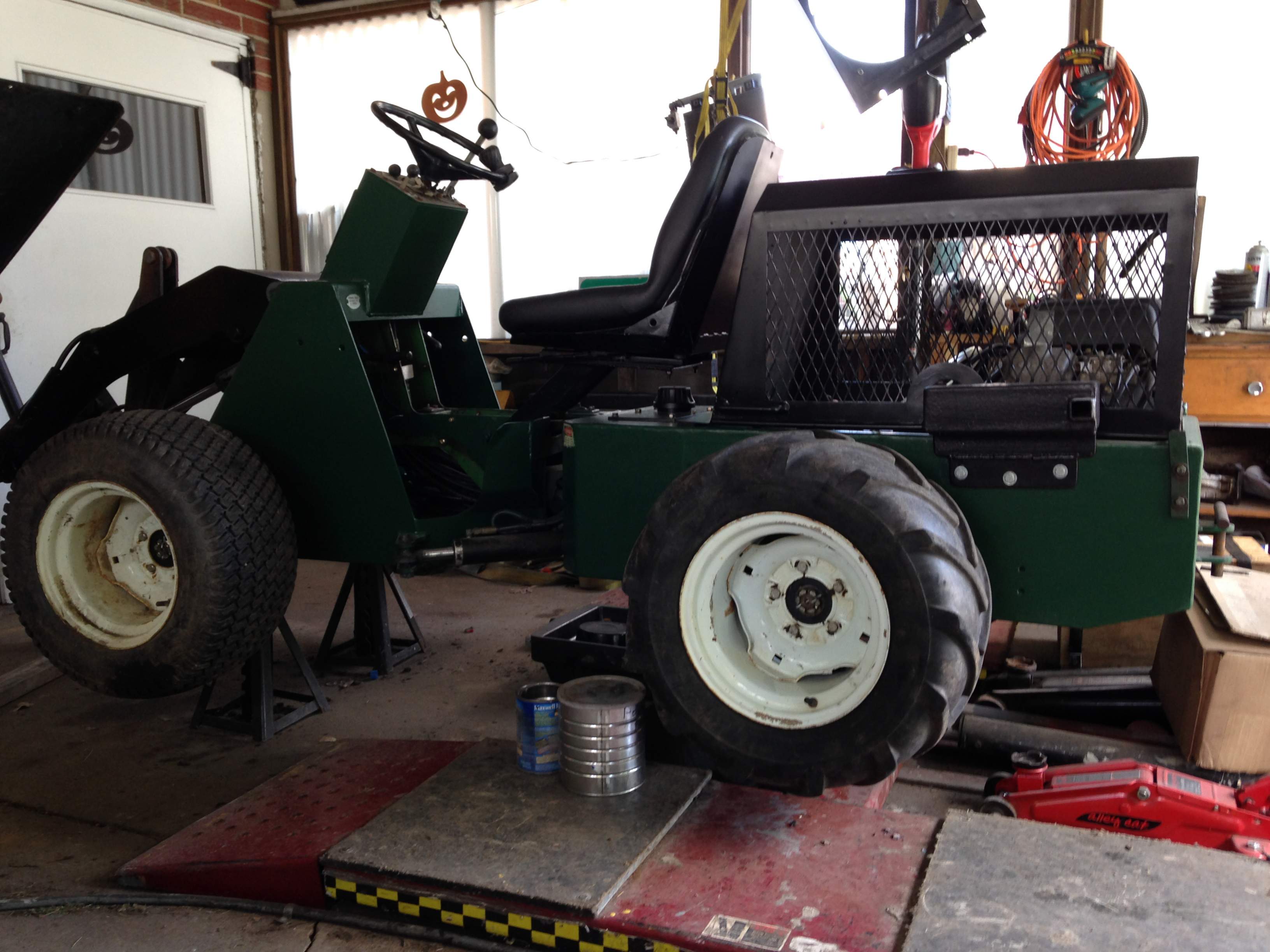

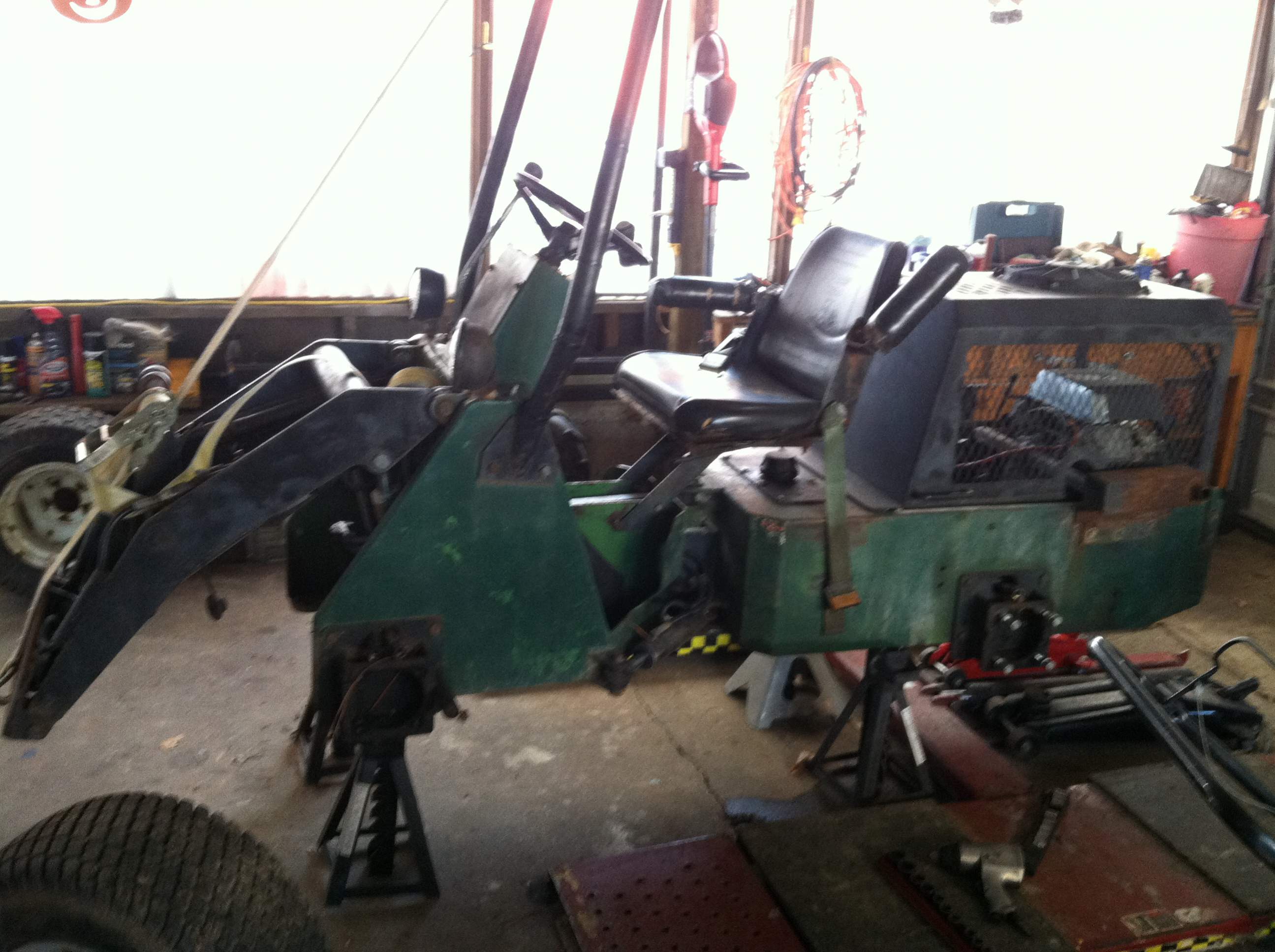

Hi All,
A long delayed update on the 425/pump/wheel motor saga:
I had two wheel motors rebuilt locally, bought 2 wheel motors and had the pump rebuilt from PowerTrac. I've been afflicted with a bad case of "...might as well...", so I've been cleaning,painting, and repairing things as I go along since the repairs have been pretty invasive anyway.Today I bled the tram pump and fired her up for the first time. I had to tighten up some fittings that I skipped on the pump install and tighten the gear pump bolts, and we have propulsion!! I still have a cooling fan to replace, the rollbar to reinstall and a lot of cleaning to do in the engine bay but things are looking up! Thanks everybody for all your help over the past few months, I'll keep you posted...
JZ
   / New Member, New Owner of a 425
#39
Here's a before and after shot. When he's back on the ground and buttoned back up I'll post some more. I'm making some small mods during the re-assembly. I have an overhead console that mounts between the uprights of the ROP to hold a tilt meter, switch panel and some gauges (oil temp and motor head temp when I get that far). The unit came with 4 driving lamps mounted to the canopy, two front, two rear. I'll be adding red LED tail lamps on the rear so I'll be more visible when plowing snow.
