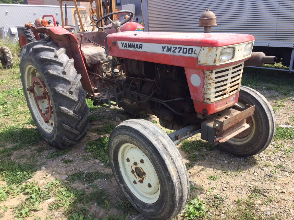

There is a 2700L, I have no idea the difference between it and the 2700. The 2200 and 2700 also were odd in having glow plugs instead of the thermostart system.

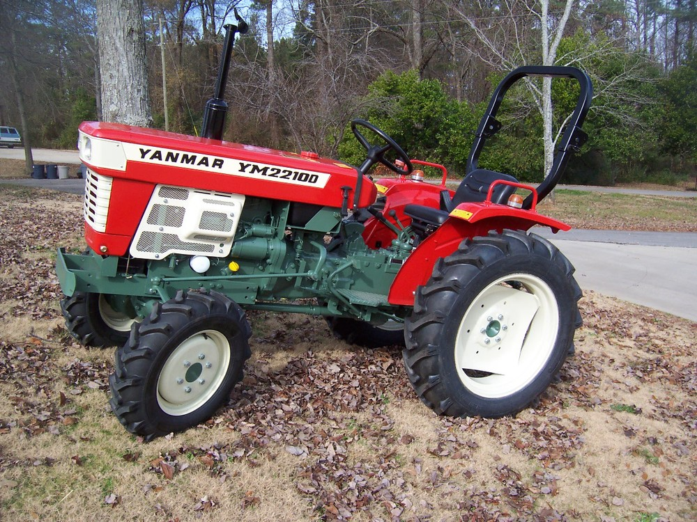

Here a 2210D Basicly a 2200D. They did a MFWD on it. 2200 with all the Bells/Whistles. the 2500-2700 was such a rare model MFWD 4WD pics. of that model may not exist? Does the 3000 use the same MFWD 4wd. on it? Yes is my Guess. The YM2500 was a Fredricks refurb. also.

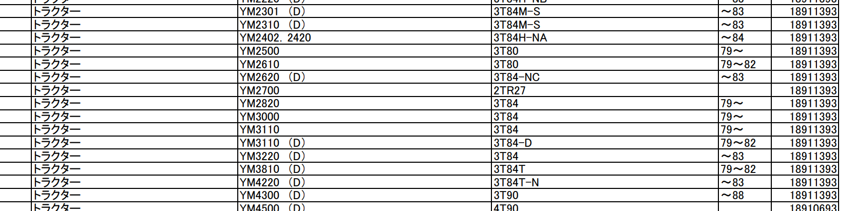

Per Yanmars official listing on the Japan site before their refresh, I snagged a PDF showing what they did make. Here is a clip of that section,
Only a 2WD YM2700 is shown. Yet, this info seems to be vague. I know for a fact there are plenty of YM2610D machines out there.

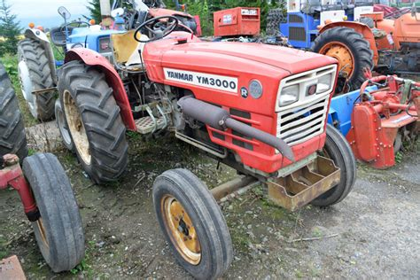

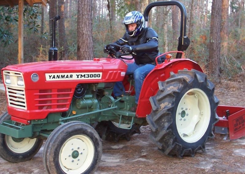

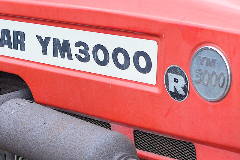

There is a YM3000R We joke around saying it's the Yanmar Racer.
Do you recall Robin who had a YM3000R, it got restored and the R was left off, he posses with his racer of a Yanmar,

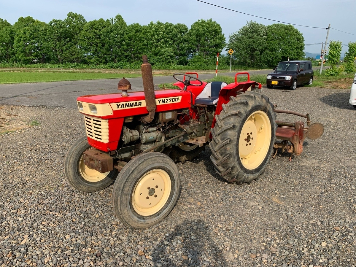

The simplest distinction that makes YM2200 and YM2700 unique is the air cleaner sticking up through the hood, and the exhaust on the left side of the block.
Some of the claimed photos above don't have these features.
