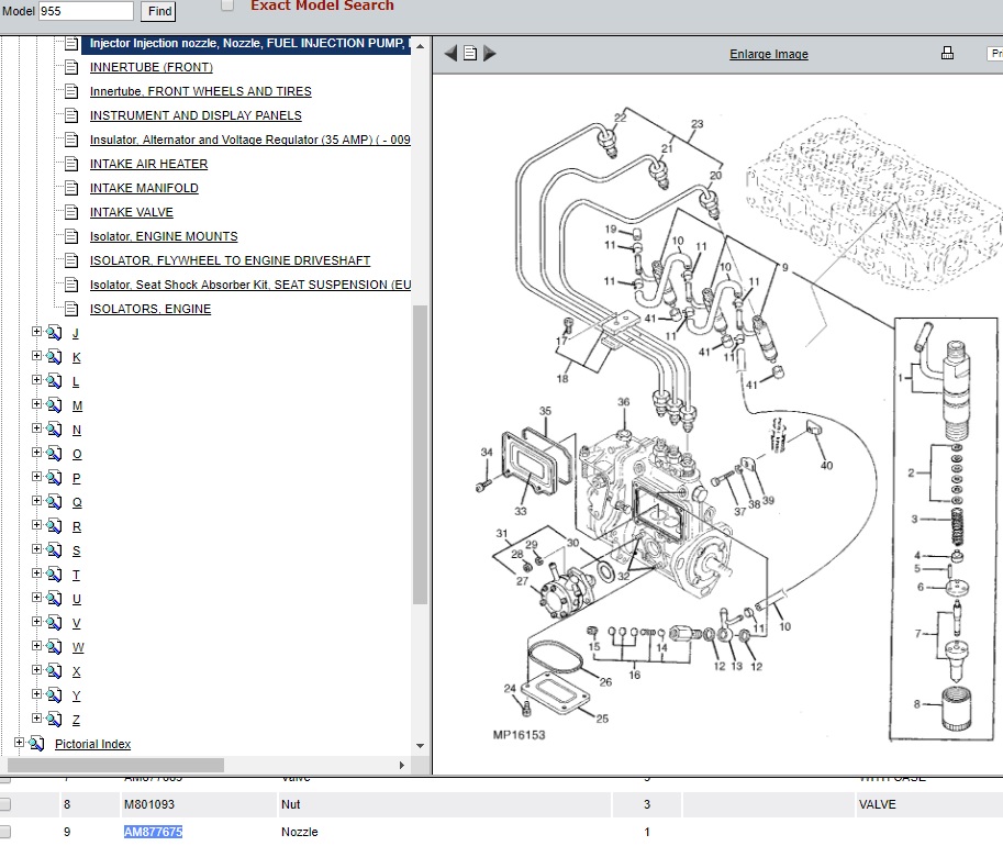

I am very new to forums and such so please be patient. I live on the Island of Moorea in French Polynesia and have recently just purchased a John Deere 955 for our permaculture garden project.
I was wondering if somebody could help me with the part number for a john Deere 955 injector, it seems a very elusive number.

Thanks Wagtail,
I can see the injector part number but the pump looks different and I dont see 955 on the list. Im thinking this injector may be different to the 955 unit.

   / New member / injector #9
From jdparts, the injector nozzle part no. looks to be AM877675, on Amazon for $180 USD
Schematic looks like this.. hopefully will help you find what you need.
Thank you "beenthere" just what I was looking for :)
