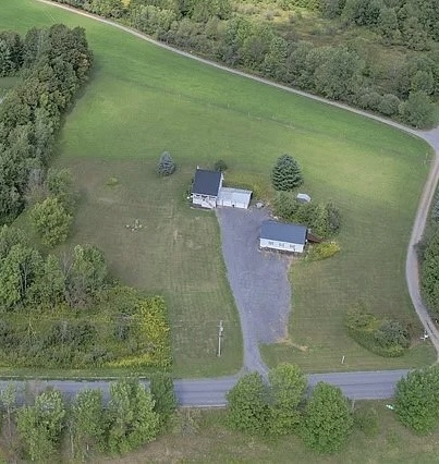

Here's the scenario--the house is about a hundred yards uphill from the road, the driveway and turnaround are both pretty wide. We will need to get a 23' trailer in there and parked along the contour where the turnaround is (perpendicular to the driveway). Also will need to remove the snow that comes off the roof of the detached garage, that's where the dogs will be and at least some sort of fenced outdoor area in that spot until we can build a real kennel down the line.
Here's the unit available nearby, 1200 hours so still has a lot of life left. Figure the bucket will come in handy for moving snow as well. If I go this route I'm thinking of getting a finish mower to pull behind it, that would save me $10k on a new mower, plus an auger would help me put in dog fencing. And with turf tires I'd use chains for sure.

Looks like a decent pairing for what you described/show. Are you sure about the Snowblower width? Specs show a 51" & 63" blower as available, which would be more in keeping with the 24-25 PTO HP. Not sure about the total acreage or plans for the wood lot, but a 60" finish or flail mower should handle the visible lawn just fine. See you have the cab & visibility seems good (at least to the left when coming down the drive). Drive doesn't seem that steep, & in a worst case, FEL could function as an Emergency brake (albeit maybe at expense of driveway or bucket ... but better than the possible alternatives). If you'll be dealing with the woodlot to any extent, a small grapple might make sense, & if you have plans for extensive trails in the woods, maybe a stump grinder. Can't tell from the pic ... is the drive asphalt or gravel? If gravel, a box blade or rear blade for after spring washout & general driveway maintenance.
How mechanically "adept" are you? The only real issue with older, used equipment is you don't know the quality of previous maintenance/repairs. Granted, you can take to a dealer but the costs add up pretty quick if out of warranty. At a minimum, get familiar with basic things like changing the fluids & filters, bleeding the fuel system, etc. so normal maintenance can be done at home by you instead of at shop rates. Enjoy the new place & hopefully new tractor.

Looks like a decent pairing for what you described/show. Not sure about the acreage or plans for the wood lot, but a 60" finish or flail mower should handle the visible lawn just fine. See you have the cab & visibility seems good (at least to the left when coming down the drive). Drive doesn't seem that steep, & in a worst case, FEL could function as an Emergency brake (albeit maybe at expense of driveway or bucket ... but better than the possible alternatives). If you'll be dealing with the woodlot to any extent, a small grapple might make sense, & if you have plans for extensive trails in the woods, maybe a stump grinder. Can't tell from the pic ... is the drive asphalt or gravel? If gravel, a box blade or rear blade for after spring washout & general driveway maintenance.
this is helpful. Gravel driveway. Actually the lot the house sits on is only 4 acres. The big lawn uphill behind the house belongs to the adjacent club, which they mow; and part of the attraction of the property is the system of atv trails on that property that shut down for atv use in the fall through the winter. We've checked with the club and they're okay with us using the trails in the winter for dog sledding. So no real woods work at the new house--here at home in the Finger Lakes though, we've got 12 acres of swampy woods along a creek, I've always managed without a tractor but there have been times when I wished I had one. Always ended up getting friends with tractors to do my work for me. :ROFLMAO:
That unit also has a jerry-rigged heater that runs off the engine radiator, it's a big box that takes up space in the cab, but heat is good.

oops, good catch on the blower width, I think I measured 62" and brain farted 72". Wider than the rear wheels at any rate.
