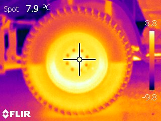

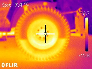

if you have access any thermal imaging camera, and want to know how much liquid ballast your tires contain, all you need to do is move the machine (or your liquid tank, if doing a fresh fill) from one temperature extreme to another, and wait a few minutes for the air-filled part of the tire to change temperature. In this case, I moved the tractor from a warm shop to 16F outdoors, and waited 20 minutes. You can see my dealer got my tires filled pretty close to the 50% (400 lb) I requested:

Which thermal camera did you use? Cost?
It's an old FLIR, purchased more than 10 years ago, I am sure they don't make that particular model anymore. I think I paid about $11k for it at the time, but they're much cheaper now. I am told you can rent them by the hour at Lowes Depot today, but I never checked on that myself, since I have several at work.
This really isn't a practical thing, if you don't already have access to the camera. But since there are tens of thousands of these cameras in the hands of everyone from scientists to mechanics to insulation contractors, I figured it would be useful to enough readers of this forum.
