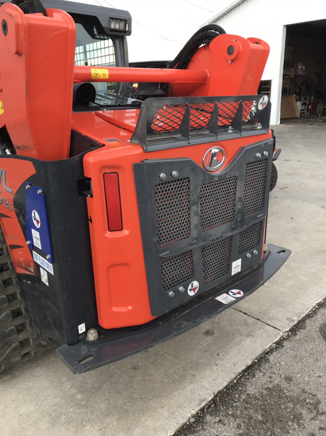

I wouldn’t be against a live demo but I’ve already seen enough to know I won’t be owning a blue skid steer. The side hinge door would be enough to turn me away. I can’t stand those. The loader arms look artificially over built to make a box for the hydraulic couplings. Just moving that safety brace would make it a lot better. As it is the side visibility looks almost completely blocked. Rerouting the hoses off the back and off the top of the boom would also help visibility. I don’t think it would take very long for a tree branch to remove the hose loop on the back The rear visibility looks pretty much non existent. The Kubota skid steers have a 3/4 thick plate that sticks past the door for a bumper that also serves as a tie down place. I don’t think the little stamped bumper would hold up as good. The back hatch needs a complete redesign. I don’t think a live demo would leave you impressed. They’ve already screwed up so much so far my expectations are pretty low for the rest of it. I saw a Kubota with an optional forestry guard in which I thought was a pretty nice option. IMG_7451.JPG
