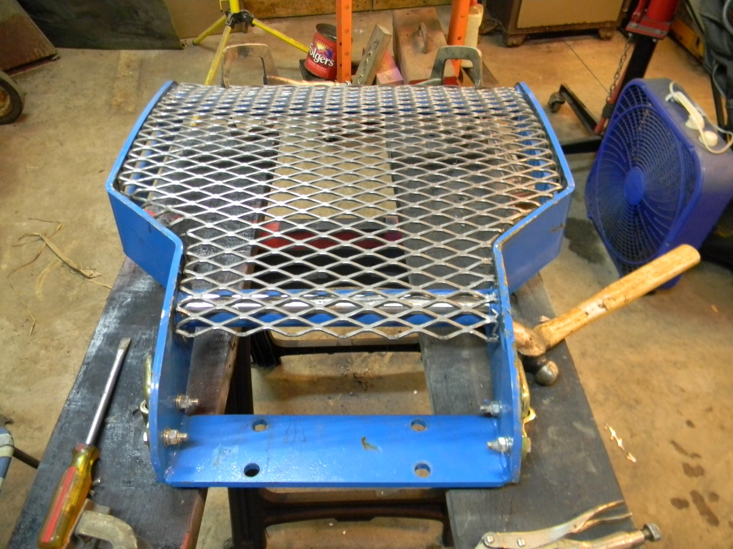

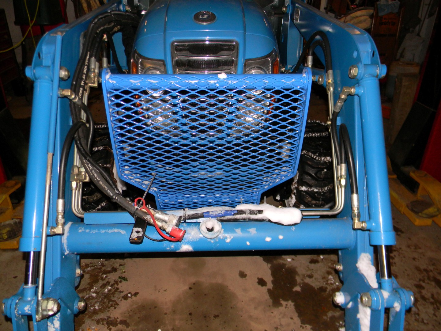

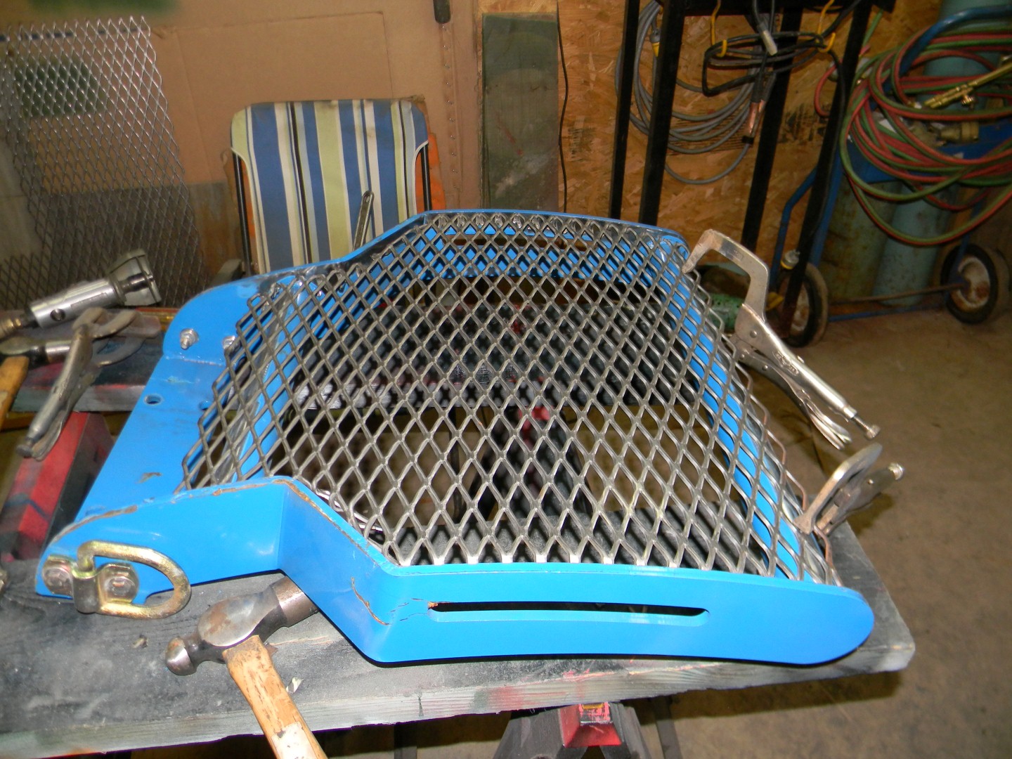

I've added D-rings for securing the tractor to the trailer, LED lighting, mirror relocation, tool box, front and rear cameras, bucket hooks, front hyd. thumb for bucket and forks, Woods backhoe sub frame attaching brackets, and probably a few I can't think of right now.

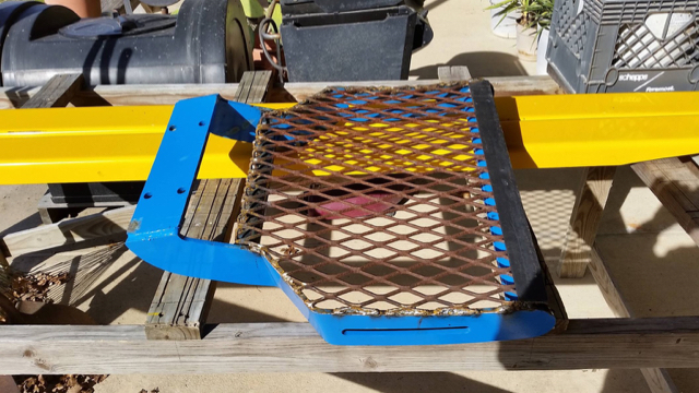

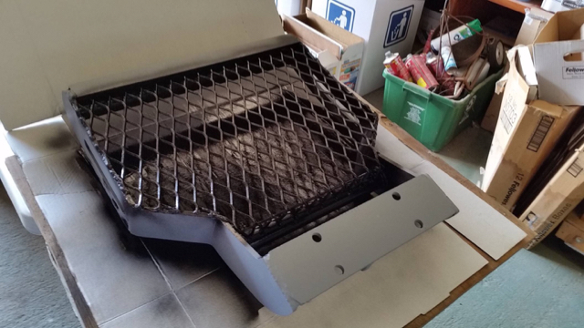

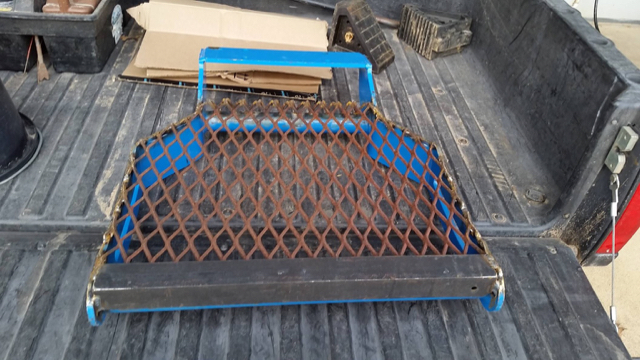

You did ask about the brush guard. I Welded in some heavy expanded metal to mine.

Thanks for the response and for the pics. That's exactly one thing I will be doing is adding some expanded metal.

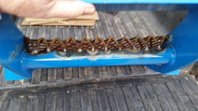

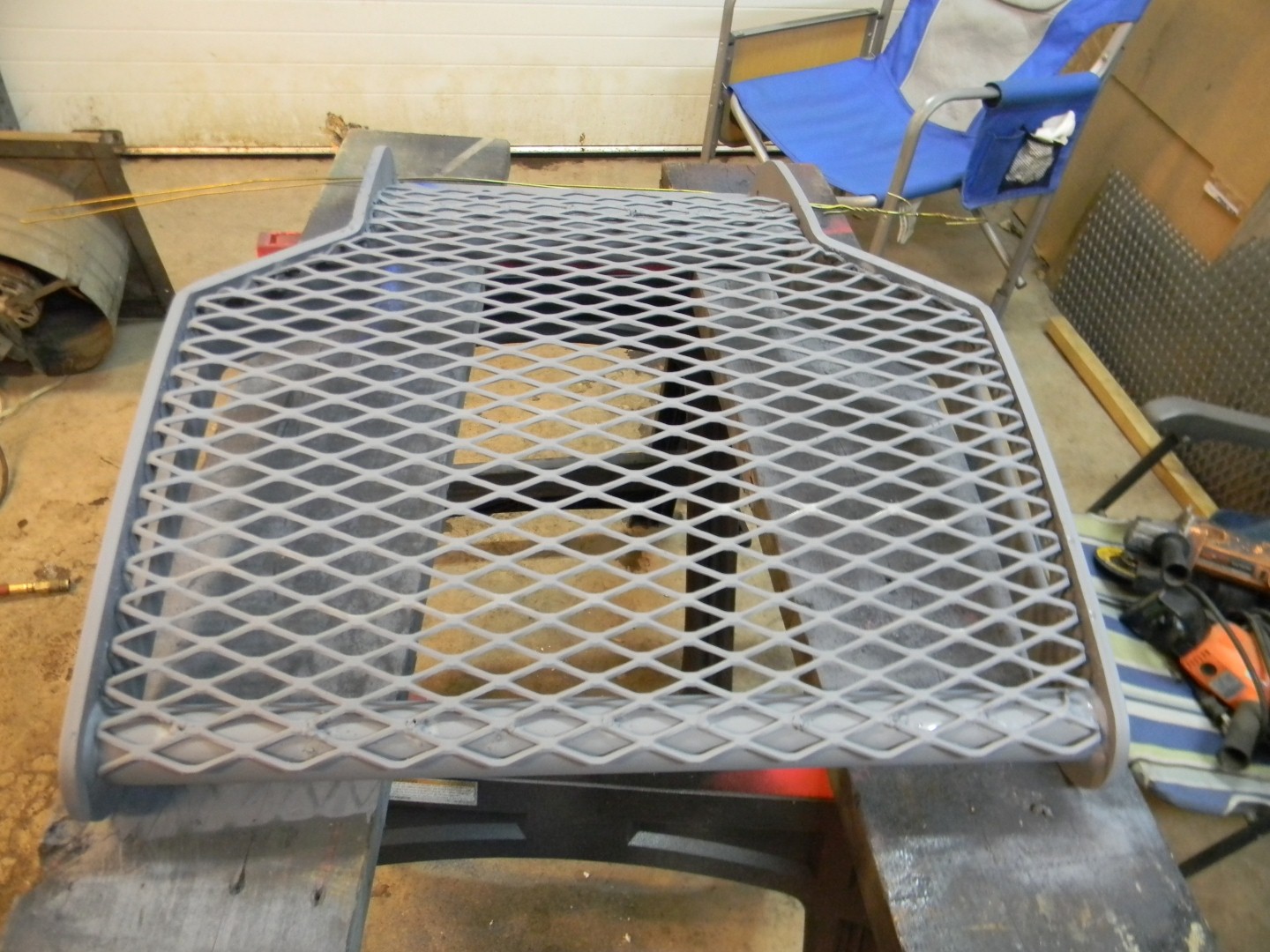

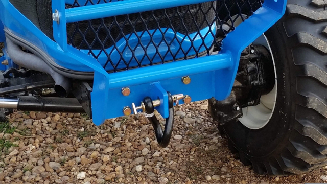

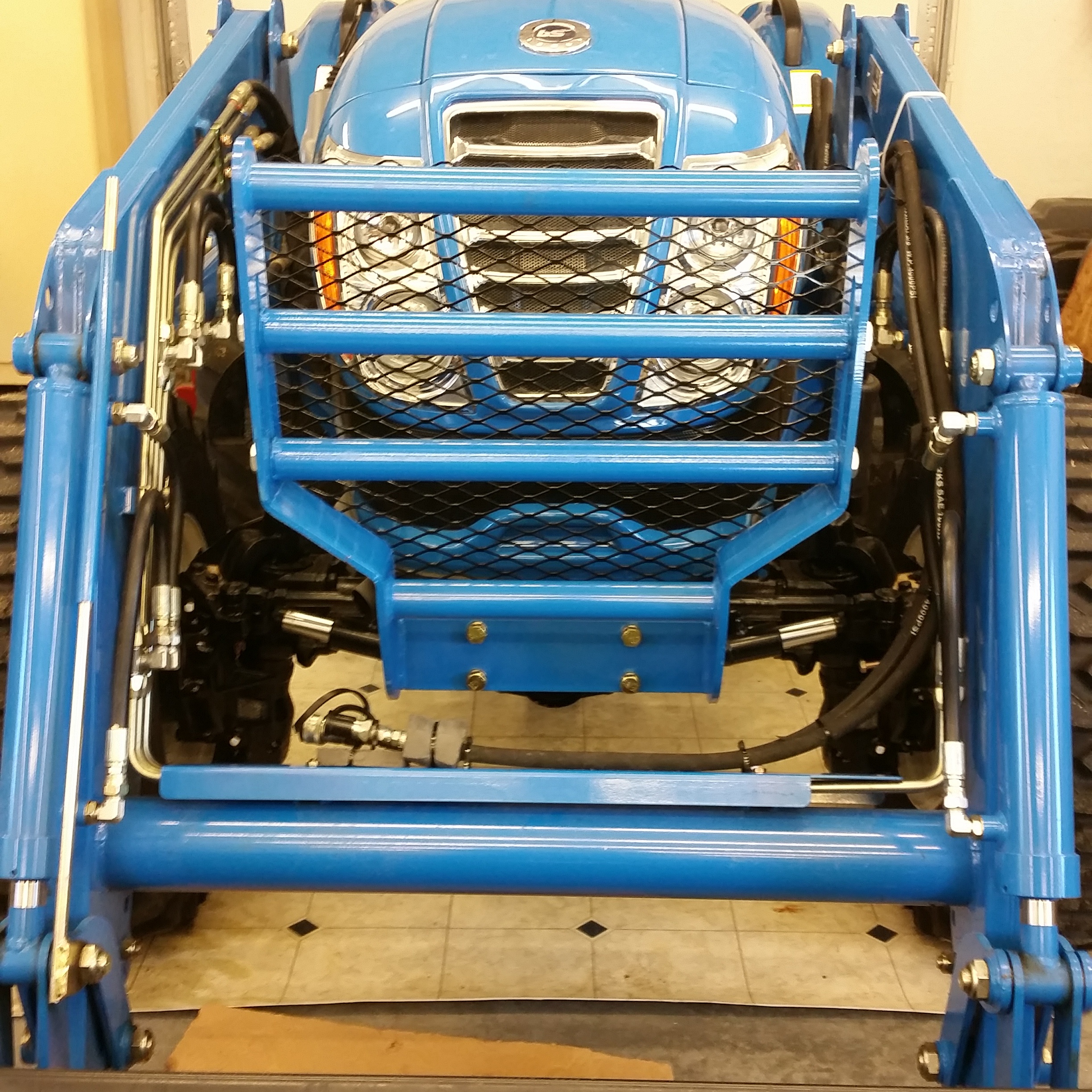

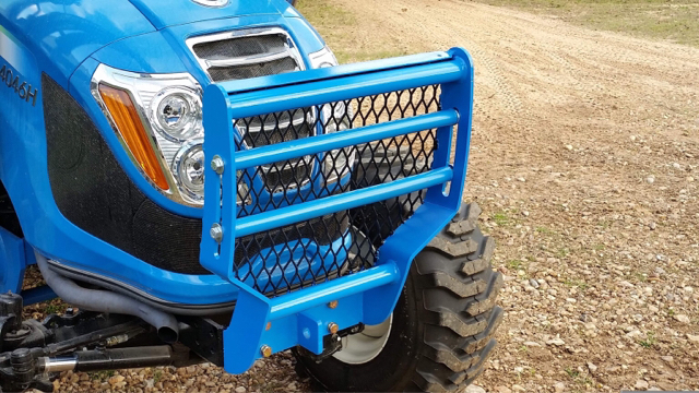

Here's how I modified my XR4046hHC brush guard. I install the Clevis when trailering the tractor, just run a chain thru it. I install a Clevis to drawbar to secure rear end.
Fit-Rite Hydraulics (Mountainviewranch) is excellent supplier of hydraulic top and side links. He builds all welded cylinders which IMHO are better than rod type cylinders.
   / New LS owner with a few questions: XR4046
That brush guard looks great! Going to copy it almost exactly if you don't mind! Do you happen to remeber the gauge of the expanded metal you used? Looks to be 1.5" opening. Thanks.
   / New LS owner with a few questions: XR4046 #9
It was some expanded metal that I had. I'll find some more pictures from construction that might help.
It was all made from scrap materials I had.
