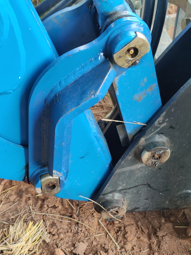

I've had my MT573 CPS for almost five years and have had no mechanical problems with it. Last year, for some unknown reason, the driver's side door shattered into a thousand pieces upon closing. It was not unduly "slammed" or otherwise mistreated. Anyway, I really like the four-wheel drive and the FEL. I had to reinforce a section of the FEL after possibly exceeding its capacity - see photo. It easily operates my eight ft. Hardee rotary mower with a grapple on the FEL. M2M, congratulations on your new LS MT573.
   / New LS MT573cps
Not a bad idea for a brace ! I kept a close eye on the bolts and frame gaps as I moved 50-55 yards of 30 year old clay ditch tailings.
