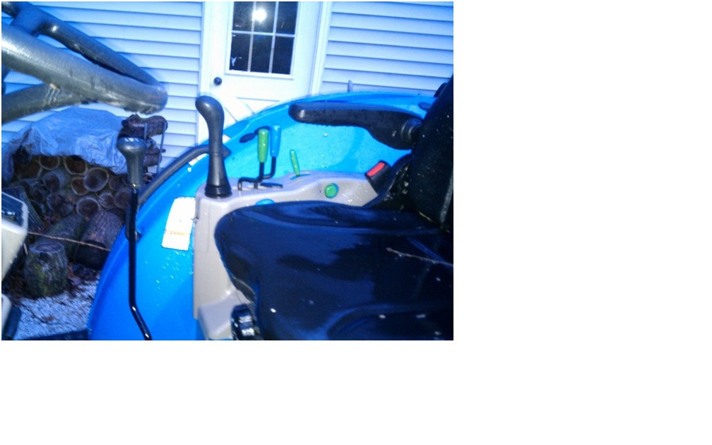

I choose the shuttle shift because it was stronger and cheaper than the HST. The shuttle shift makes going back and forth almost as easy as a HST. First gear in low range is a true creeper gear; plenty slow for cutting into a pile of dirt or gravel. Fourth gear in high range is too fast.
I use my tractor for road maintenance (snow plowing, surface grading, etc.), materials handling (gravel, dirt, rocks, mulch, etc.), log dragging, landscaping, and anything else that comes along. I'm very happy with it.
