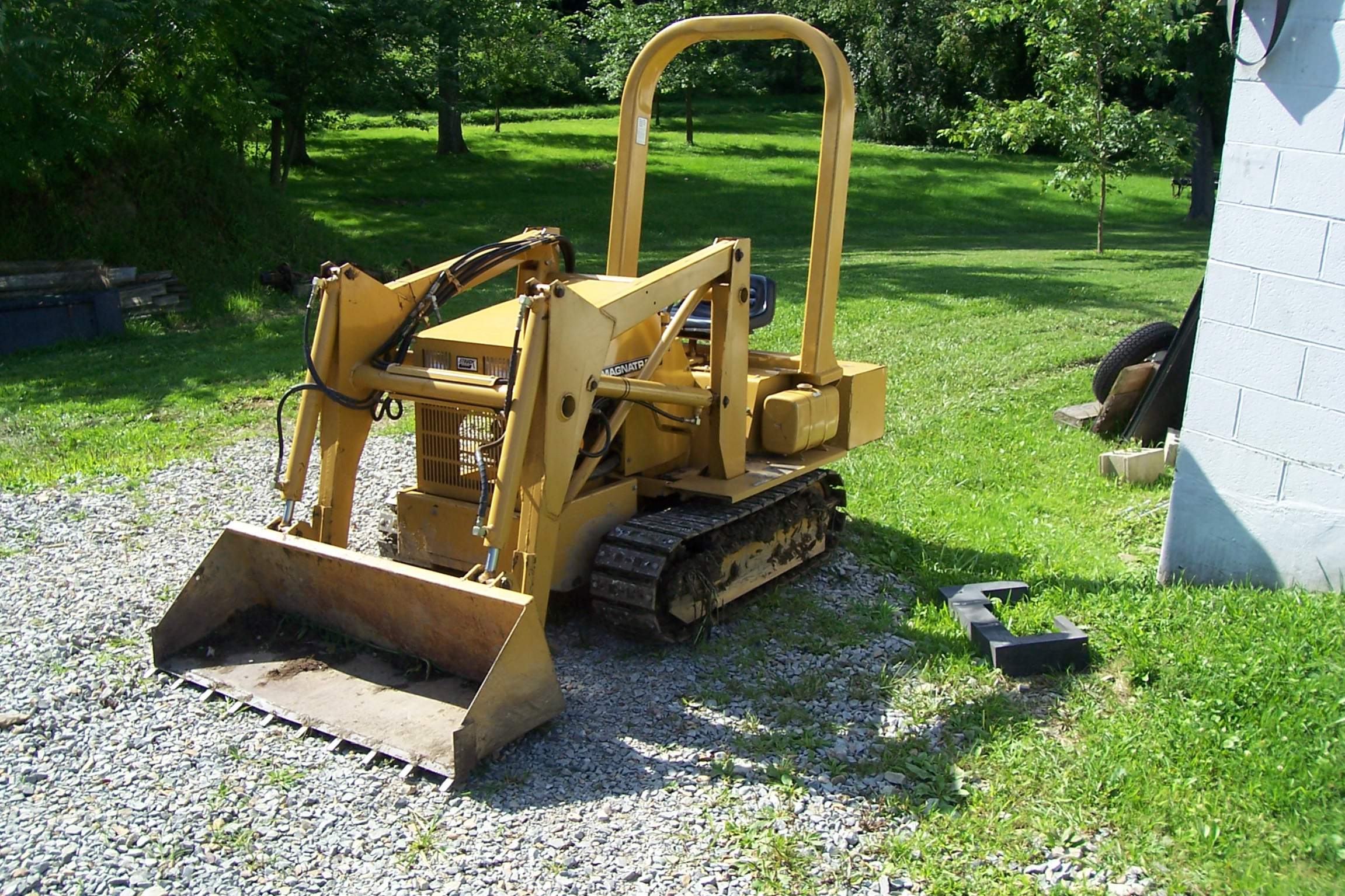

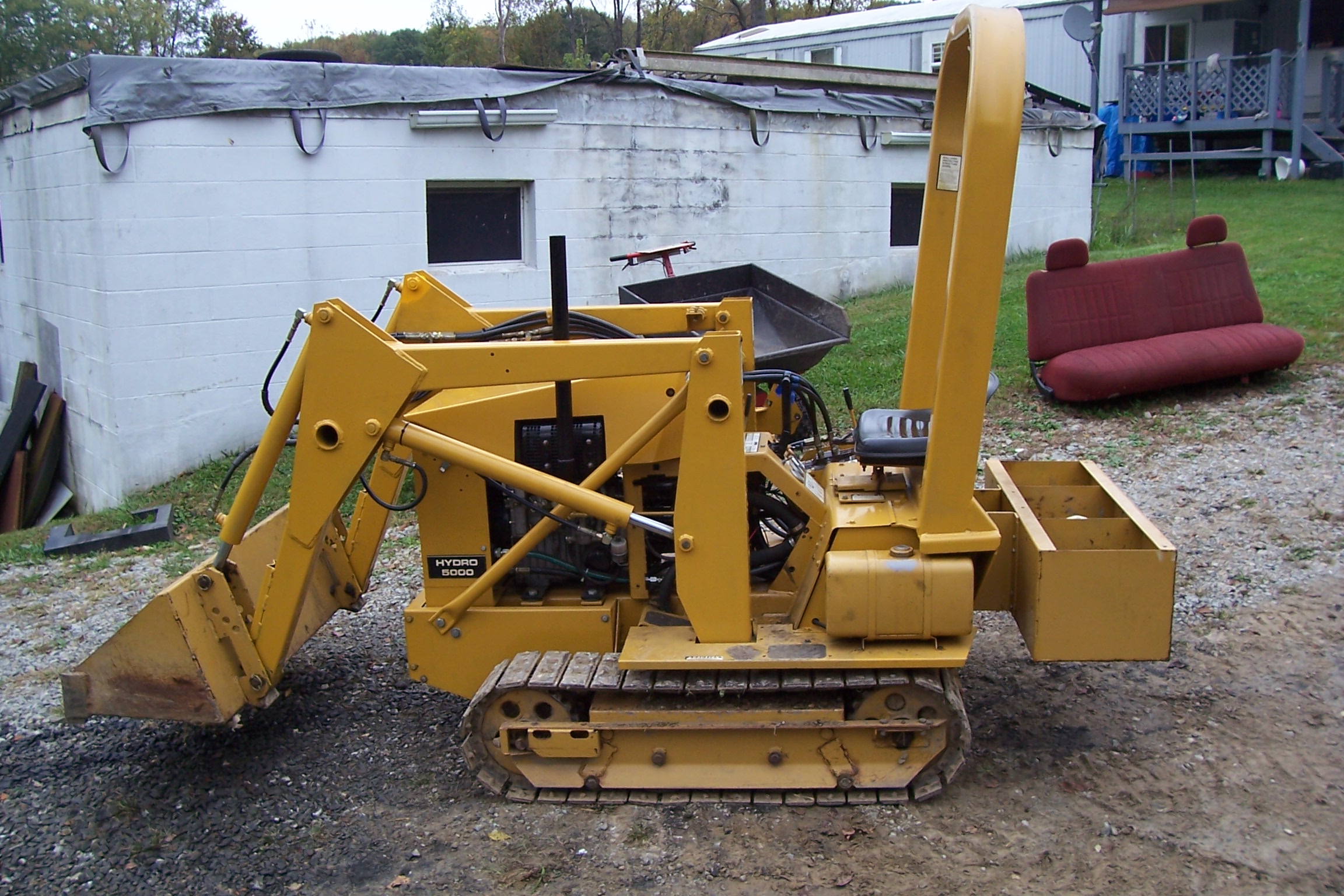

Fedup: I spent a lot of time racking my brains and researching all kinds of different hydraulic components and comparing original stock machine specs to make this thing work. I am only trying to figure out why my loader circuit is giving me a problem. The machine drives, steers and runs well. I was hoping to find intelligent posters like J_J and Farmerford and the like to chime in and give me there opinions. Im not trying to start an argument.
Farmerford: I will post some pics tomorrow of the whole unit with the loader on. I had an idea on how to rout hoses and mount components but it all fell in place as I went along. There was a lot of figuring out one piece at a time. There isn't much room in this thing to work with. lots of hoses to deal with, but im overall happy with the outcome. Thanks for all the input Guys. Hear is a before pic of the machine. Also a couple after the diesel installation without the loader installed (center pics).

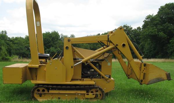

Actually, the speed might be a little fast for the available power. I should of got a smaller pump. But im learning by trial and error. But I wont know that for sure until I get the loader to work properly. I still cant turn up the divider valve like I want to. There is something causing a strain on the dump function. I was looking at these Magnatracs for quite some time and always wanted one. I also dreamed of re powering it with a diesel and modifying it to my needs. I could never see spending what they want for a new one and I finally found one used in good shape and everything is working out well. Im no engineer just trying to make something work. How do like the 1800? At least theirs less hydraulics to worry about on that one. I agree, slower and more power. Here is a few current pics of the machine.
