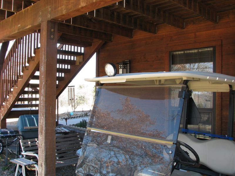

I just mounted one of the 18W Ledstores lights on my brother's golf cart canopy. It looks like a cyclops.:D The single light is perfect for driving pre-dawn or at night. By drilling the front lip of the canopy, the light mounts at a perfect angle and the flexible canopy provides shock protection, I believe better than a rigid mount. It's the perfect low current draw, but bright light addition to the golf cart.:thumbsup: The one thing I wished for is a longer cord on the light. I didn't want to attempt dis-assy, so I just spliced in an old power cord I cut off of an old B&W TV. I ran that down the canopy front support to the center console where I installed a weather proof toggle switch. I'll try to get some photos and post them. I took cellphone photos, but they were just lousy. I really like these lights and will buy more in the future.

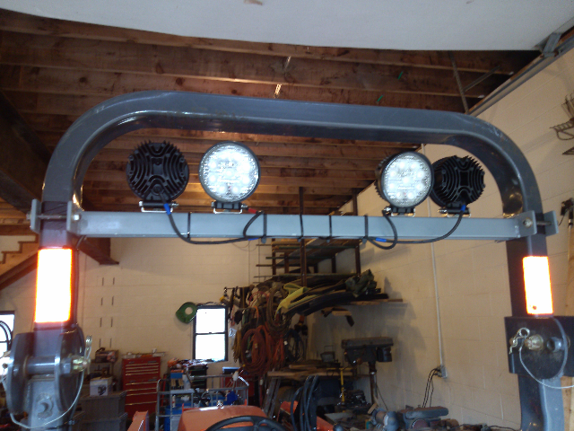

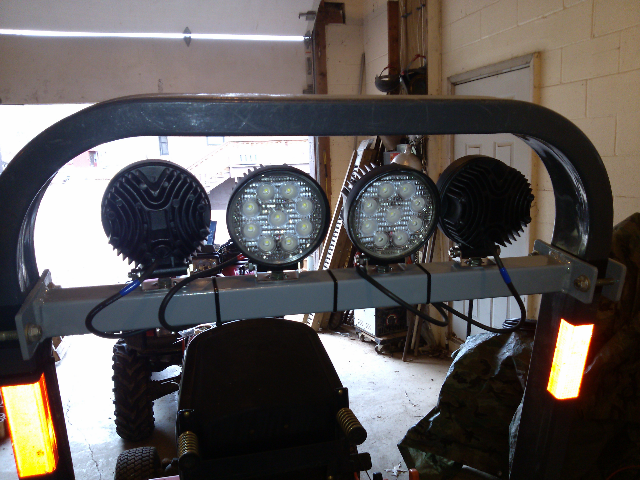

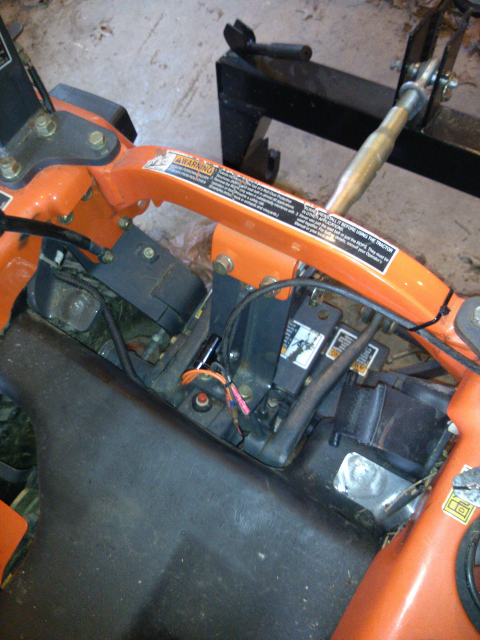

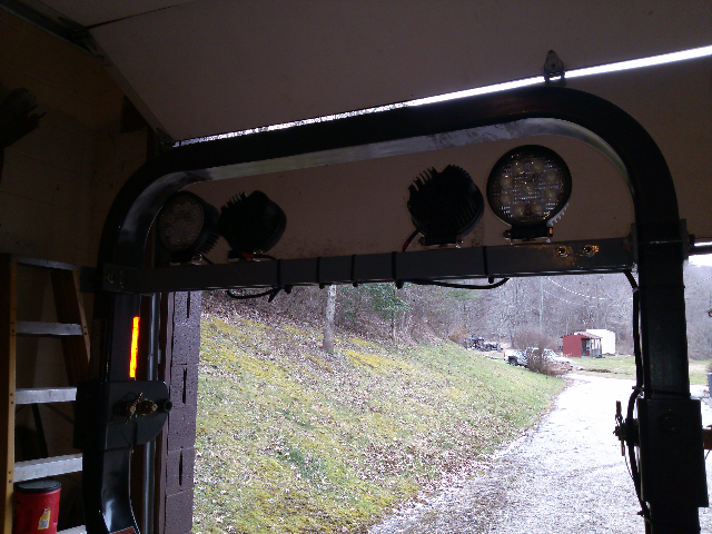

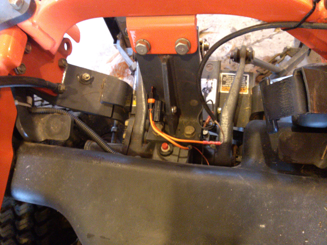

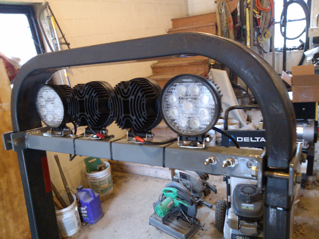

Sorry about the order of the pics as I was posting from my phone. Here are some pics of the install of the 27Watt Leds from LEDstore. I mounted 4 on my L4400 and 4 on my BX1500. I Tied into the work light circuit on both tractors and I used a 10Amp fuse at the point where I tied into the factory wiring. I used toggle switches that are mounted into the light bar and I need to find the rubber boots that make them weather resistant. The light bar clamps on without drilling any holes into the ROPS.
L4400 light bar
BX1500 where the power is picked up.

I placed the Lights under the roll bar to try to offer them a little protection. I also used plastic washers at all friction points so I could tighten the bolts and still move the lights around when I wanted too.

dex3361: Thanks for the pictures. Looks good!

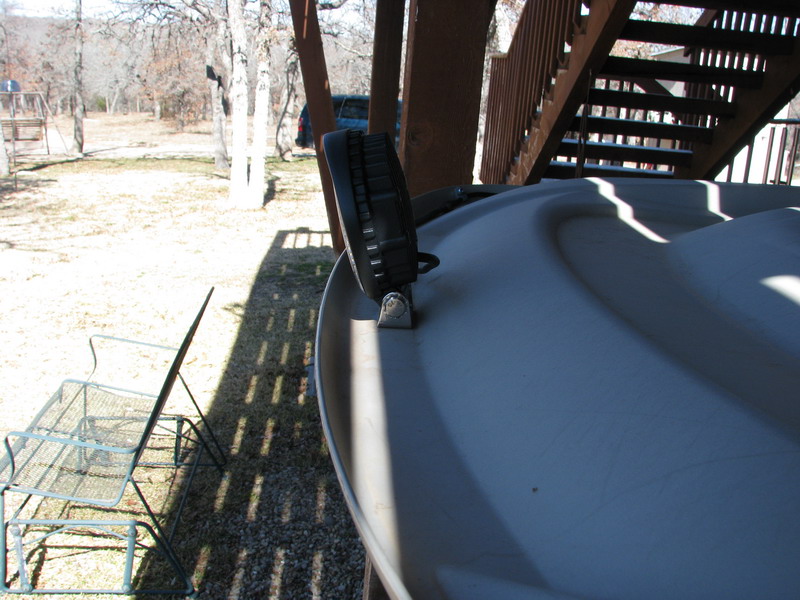

Here is the single 18W light I installed on my brother's golf cart. It is the perfect light for this application.
