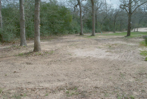

I found that the wheels allowed me to "level" the dirt better. You can put the 3pt in float and the wheels will keep it at the height you want based on how you have them adjusted and will keep it level from side to side. I don't know if I could have gotten the results I wanted without them. Attached is a picture of some of the area.

Thanks Jack and Bill.
OK, I think you convinced me that the wheels could add beneficial results with the finishing work one tries to do. But, I guess another related question I have and it pertains to Jack's comment on using the wheels and rake on uneven terrain conditions. Do you think a tractor's top and tilt would be able to compensate somewhat for the lack of wheels? I ordered my tractor with the top and tilt kit as this would help me in the use of other implements. With the landscape rake, I thought about the situation of using the rake on uneven terrain, and I have plenty of this, and for the need to adjust the links to avoid digging too deeply and maybe doing damage to the rake's tines. My thinking though was I could avoid these potential difficulties by using the tractor's top and tilt functions and manually raise or lower the 3ph when needed to compensate for degree changes in terrain. Of course, this would require a bit more time in any job I do as I would have to pay much closer attention to changes in terrain conditions than if I had the wheels but I thought I could do this, save the $250 I would have to spend for wheels, and use it on something else instead. While I ordered the rake without wheels, I'm trying to get info from the dealer on whether I could purchase the wheels at a later date if I think I really need them.
Thanks for your insight.
Bob
/ New Landscape Rake #9

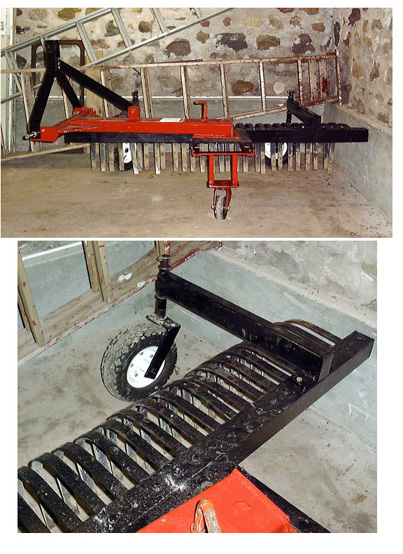

Bob, I just made my own set for my rake. Got two wheels and tires from Harbor freight for $12.00. And welded up the rest from scrap metal I had laying around. Attached is a photo of them.
/ New Landscape Rake #10
Top-n-tilt is useful for many things, but I don't think it would be very practical for controlling the rake to achieve levelness. You could tilt it to one side to clean out a ditch just as you would with a rear blade or box scraper. Most of my experiences with a rake have been in final stages of soil finishing in preparation for seeding or sodding. You make several passes in different directions to comb out small stones and sticks and produce a level surface just as you would with a hand rake in preparing a garden seedbed. During the first pass or two, the ground the tractor drives over is not level. Gauge wheels on the rake are close to the tines and help keep the rake as level as possible independent of what the tractor is doing. Note that these wheels run over a surface that has already been smoothed by the rake tines so they don't encounter as many bumps. I'm sure the wheels can be ordered any time as an accessory. My bet is that you will ultimately decide they are worth the cost.
/ New Landscape Rake #11
Bob, The wheels make the rake work much easier. The effort required to make an area with high and low spots smooth without wheels is considerable. I don't think top and tilt would make much difference. Without the wheels the 3pt height has to be constantly adjusted to account for the uneven terrain that the tractor wheels are driving over. A small bump under the rear tractor wheels results in a larger movement of the rake because it is cantilevered off the back end. Without constant adjustment the bumps will actually get bigger when using the rake. With the wheels all that is required is adjusting the wheel hight relative to the teeth and then just drop the rake and go. No on the fly adjustments are necessary. The wheels roll on the smooth surface behind the rake and remove the bumps. Adjusting the wheel to tooth height can be done with the top link, so the top and tilt would work great with wheels.
About 4 years ago I made my own wheels for the rake after encoutering the difficulties above. You can see the wheels at:
http://www.mgsweb.com/tractor/hacker/rake.htm

bw, Yes the wheels have about 4" of adjustment up and down by moving spacers on caster shaft. In the photo they are all the way up.

Brett, My rake is 6 foot and was a little over $400 without wheels. It is built like a tank, I have seen some pretty light weight rakes that may cost less and brand name ones may cost more. Rakes are more expensive than rear blades for the same level of quality. I spent about $50 in materials to make the wheels, if you buy them they cost a few hundred or more. The wheels I used, have ball bearing swivels with a grease fitting, ball bearing axles, and the tires are air filled and replaceable.
My wheel height is adjustable about 8 inches. I used square pipe for the wheel posts and frame. The wheel posts slide inside a larger section of square pipe on the frame and I welded a nut on the side of that. I used some 1/4" x 1" flat stock welded to the head of a bolt to make it so no tools are needed to adjust the wheels up and down. Even though the height is fully adjustable this way, I usually do the final adjustments with the top link once I start driving and see how big a bite the rake is taking.
