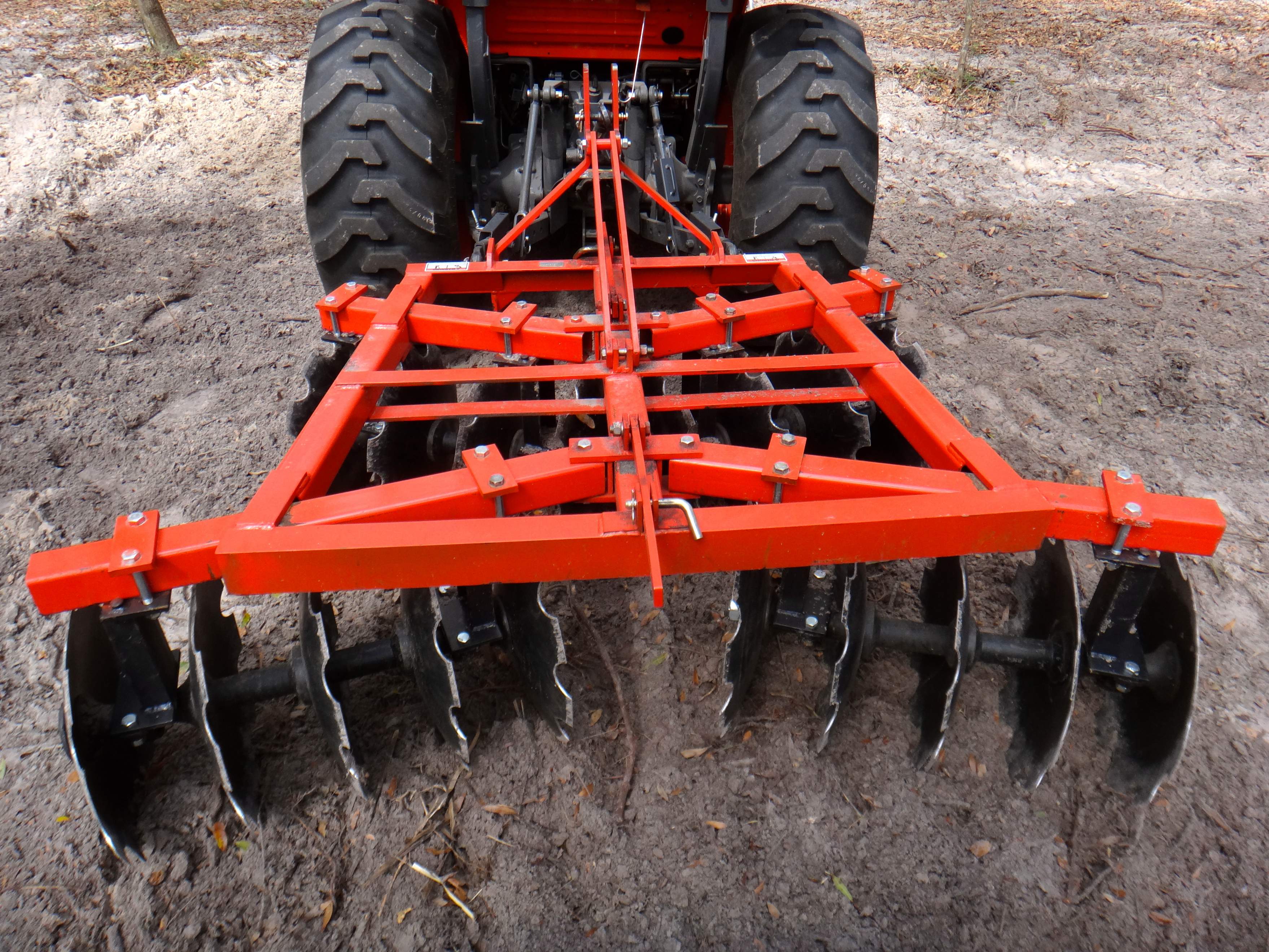

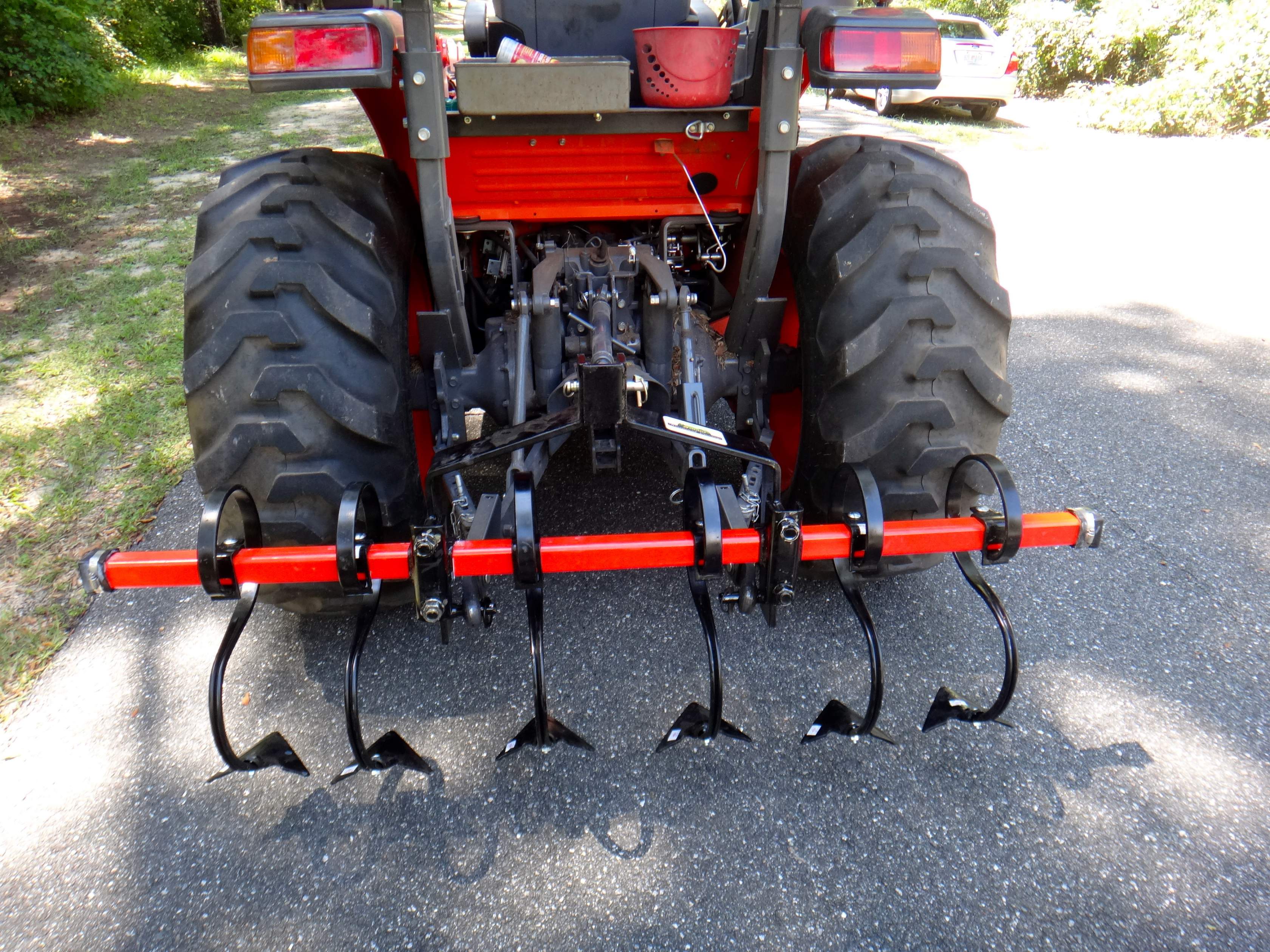

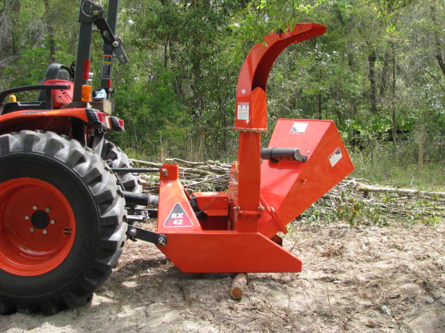

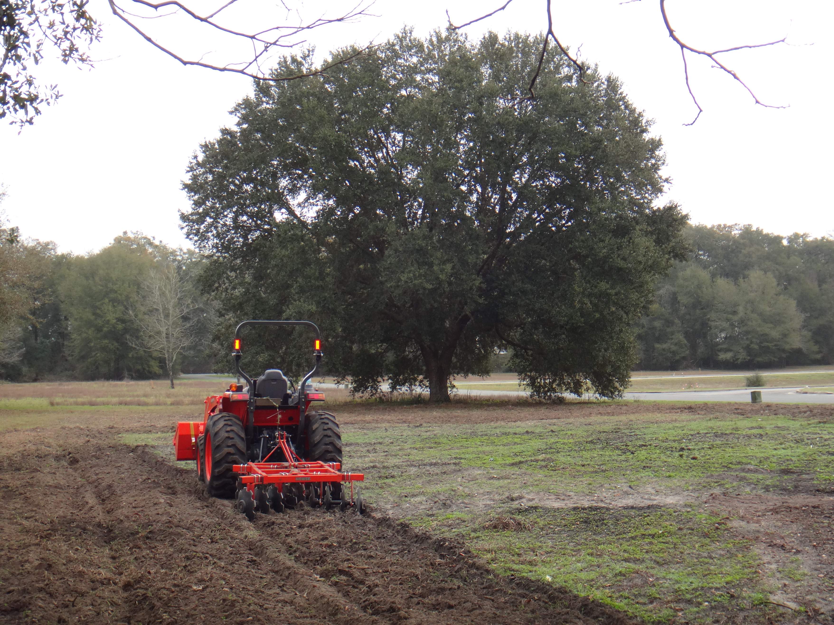

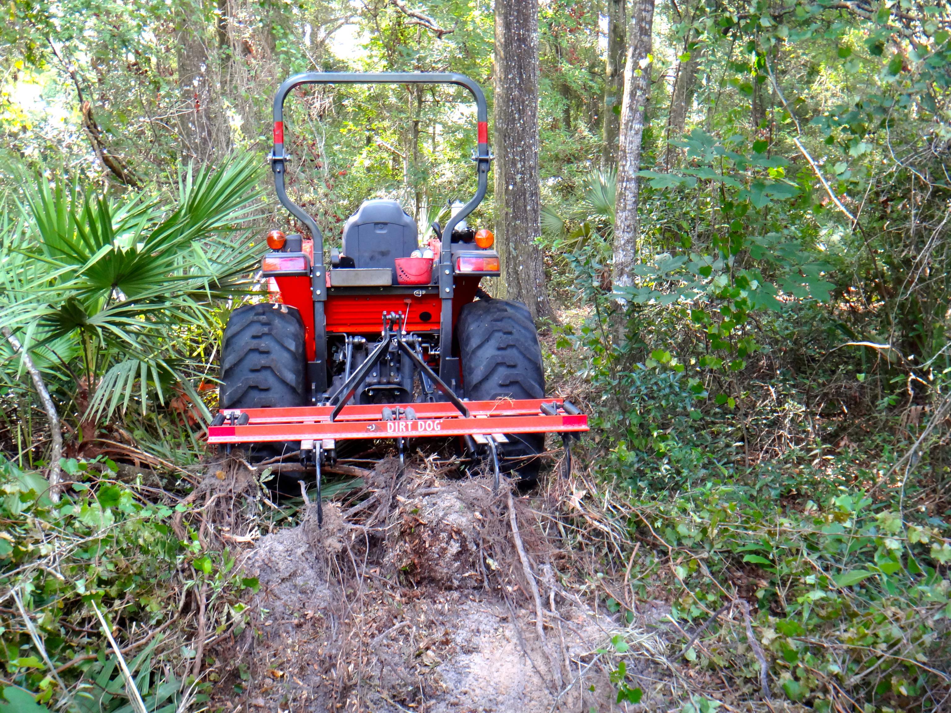

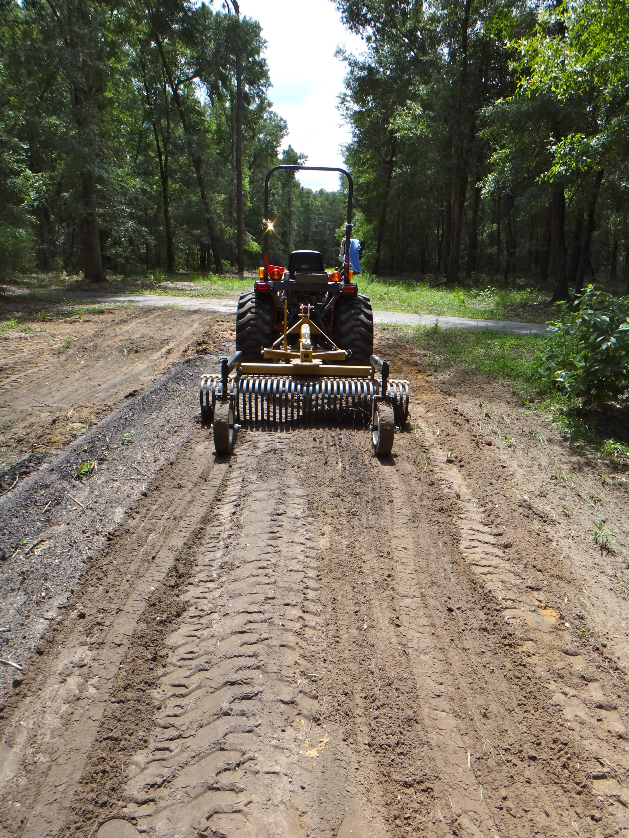

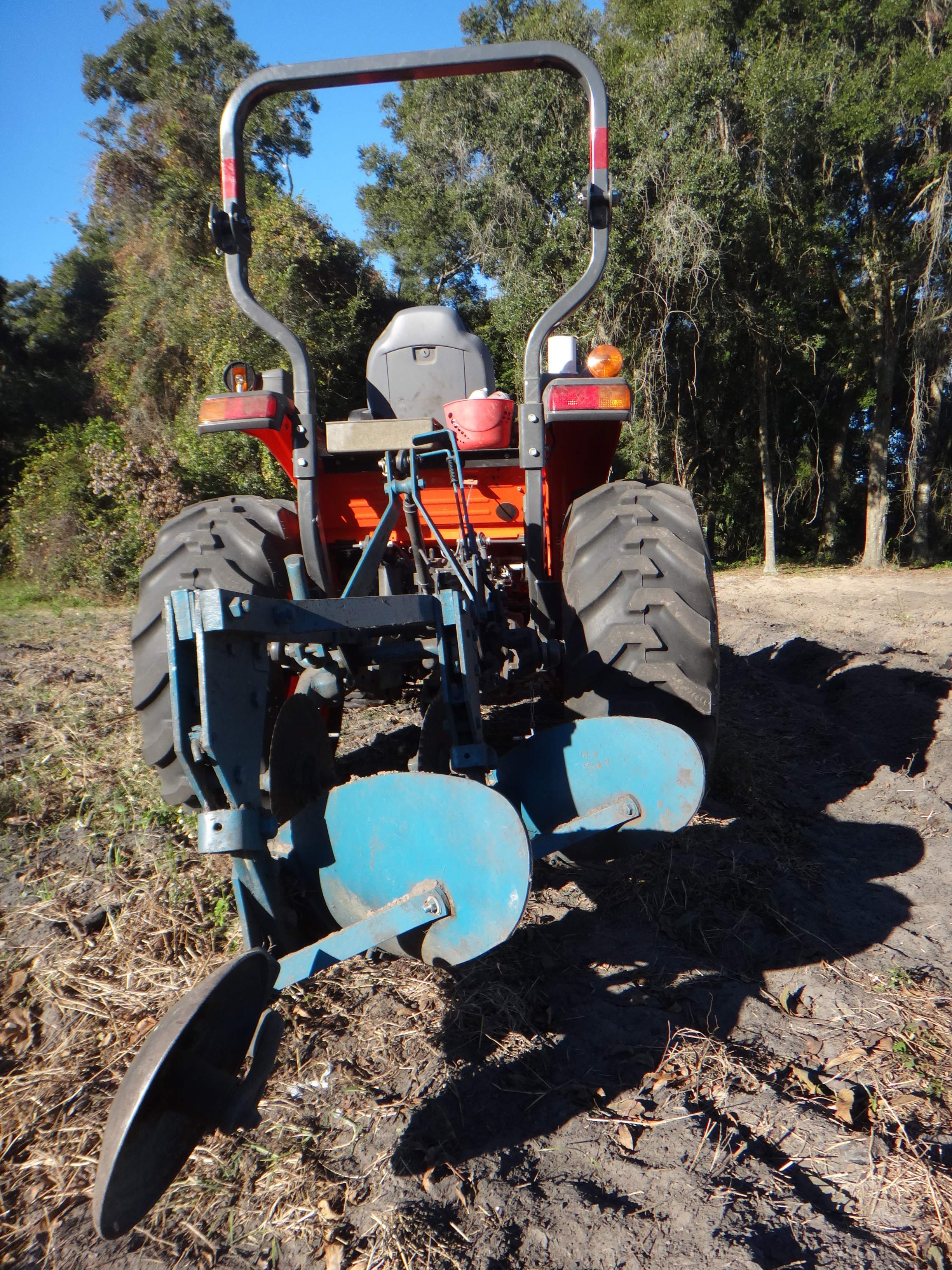

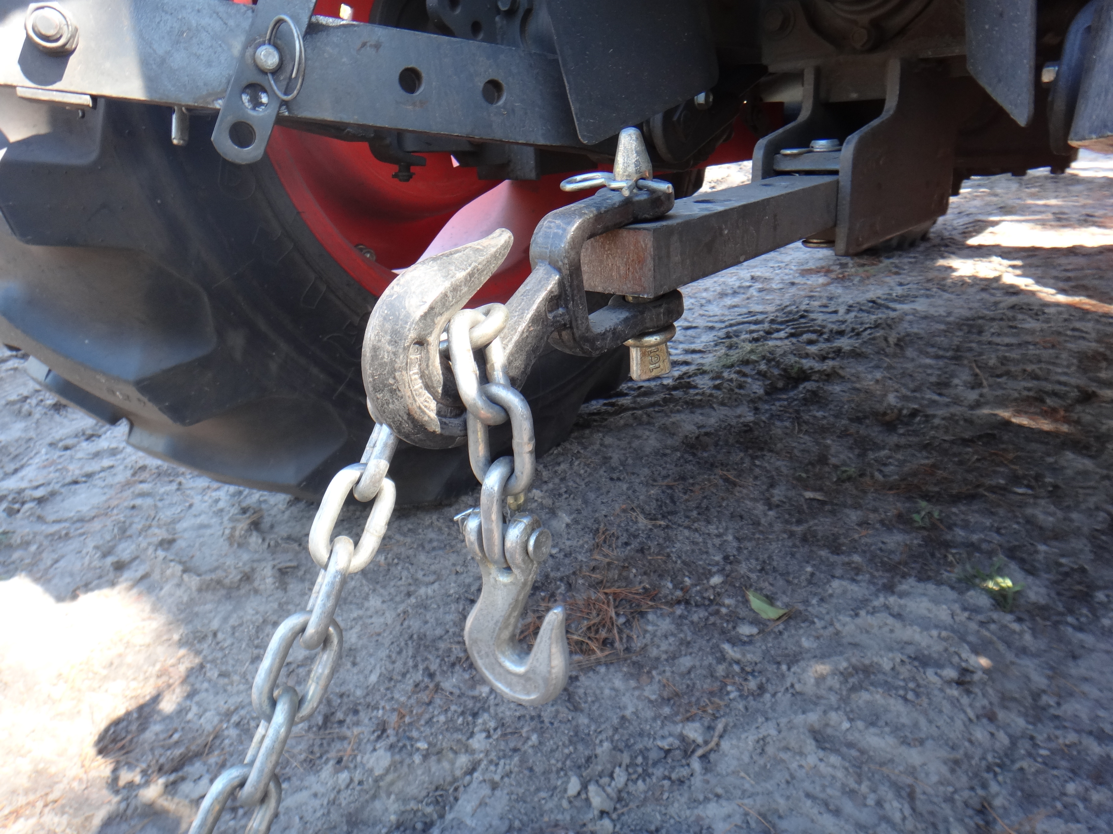

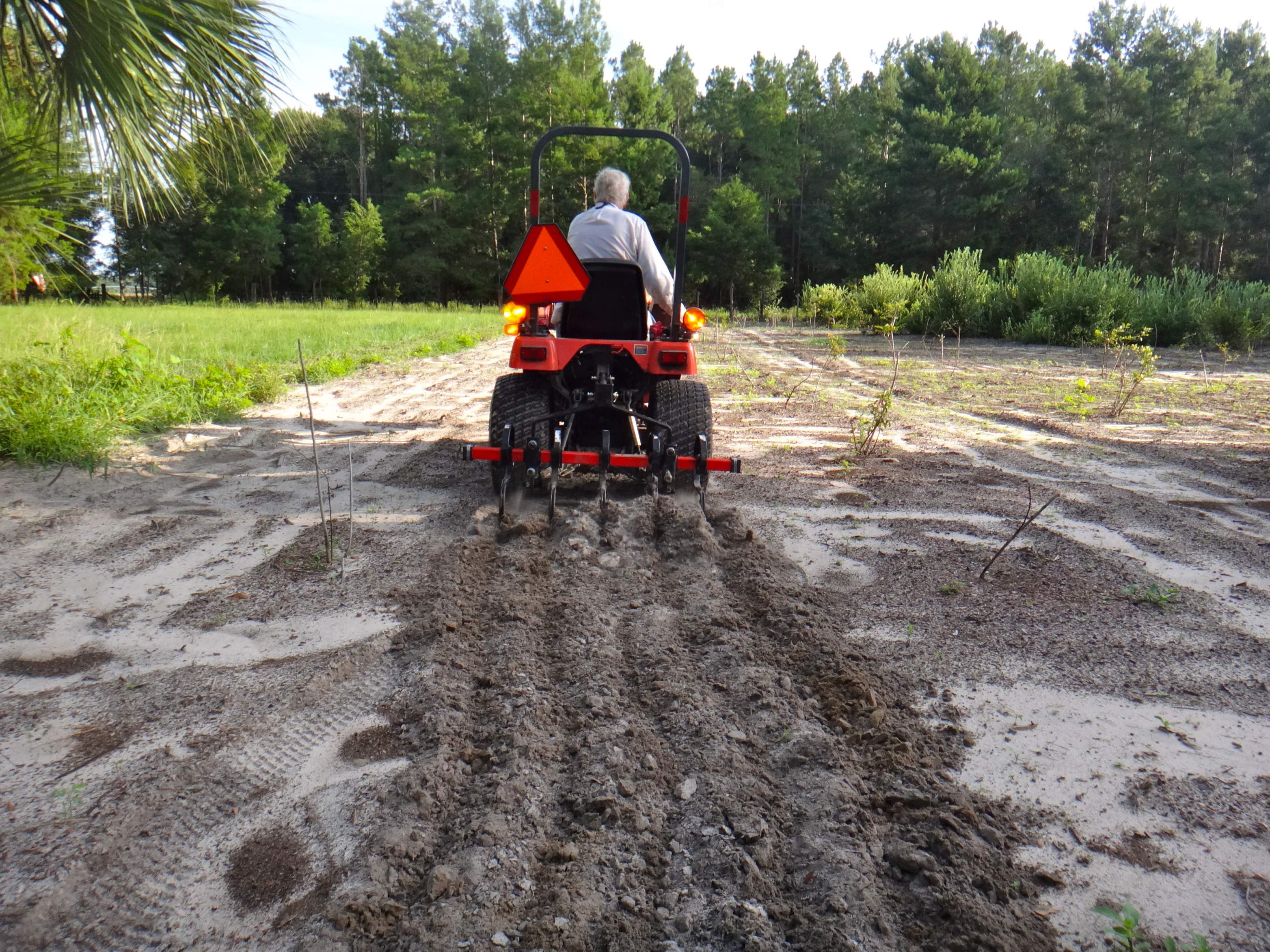

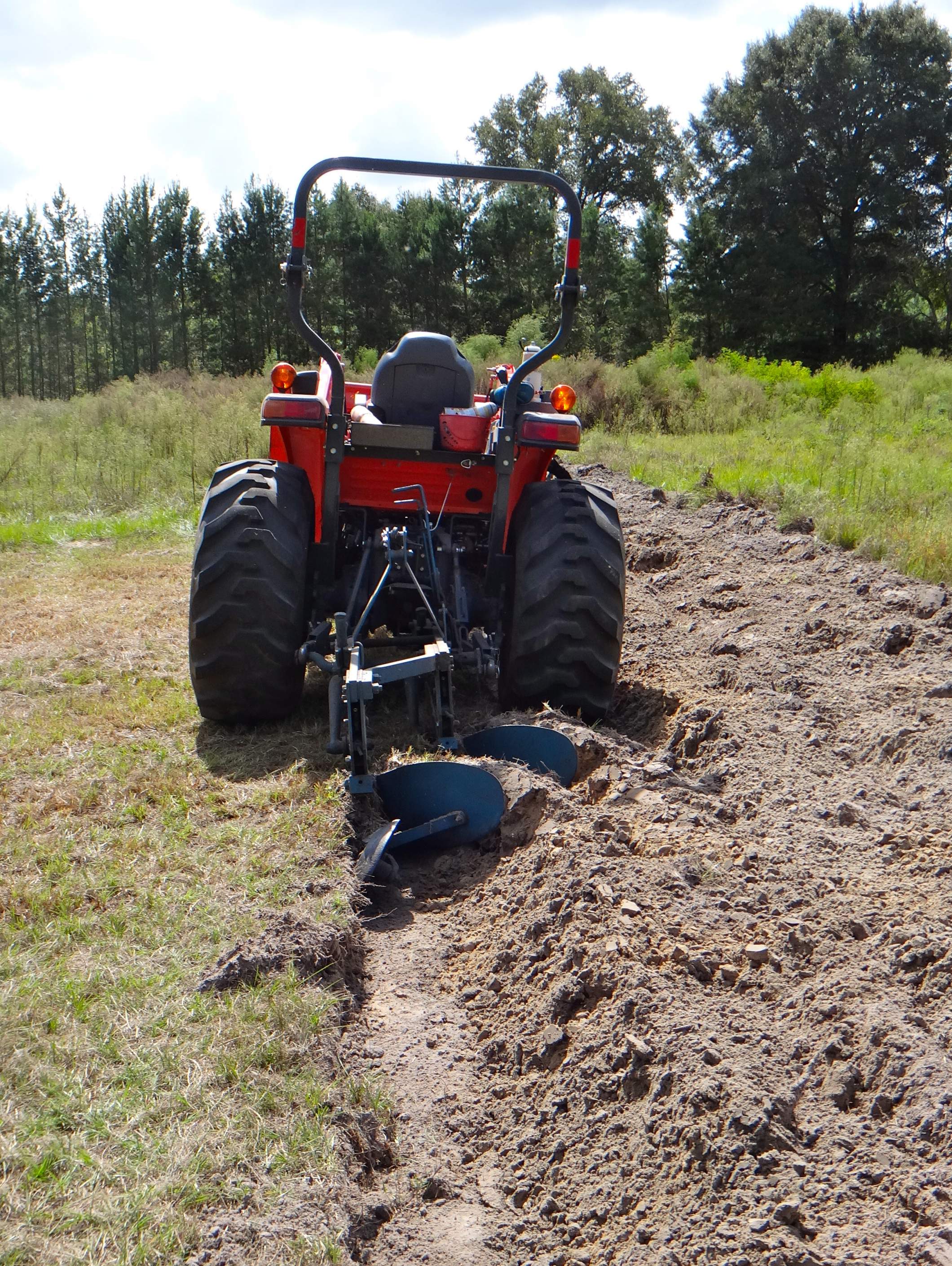

Tractors are designed to PULL. The primary tasks for tractors are performed from the (rear) Three Point Hitch and its associated Power Take Off (PTO).
Tractor Three Point Hitch: Since 1955 when Harry Ferguson's patents on the Three Point Hitch expired, no one has invented anything superior to the Three Point Hitch and Ferguson's design has become standard world wide.

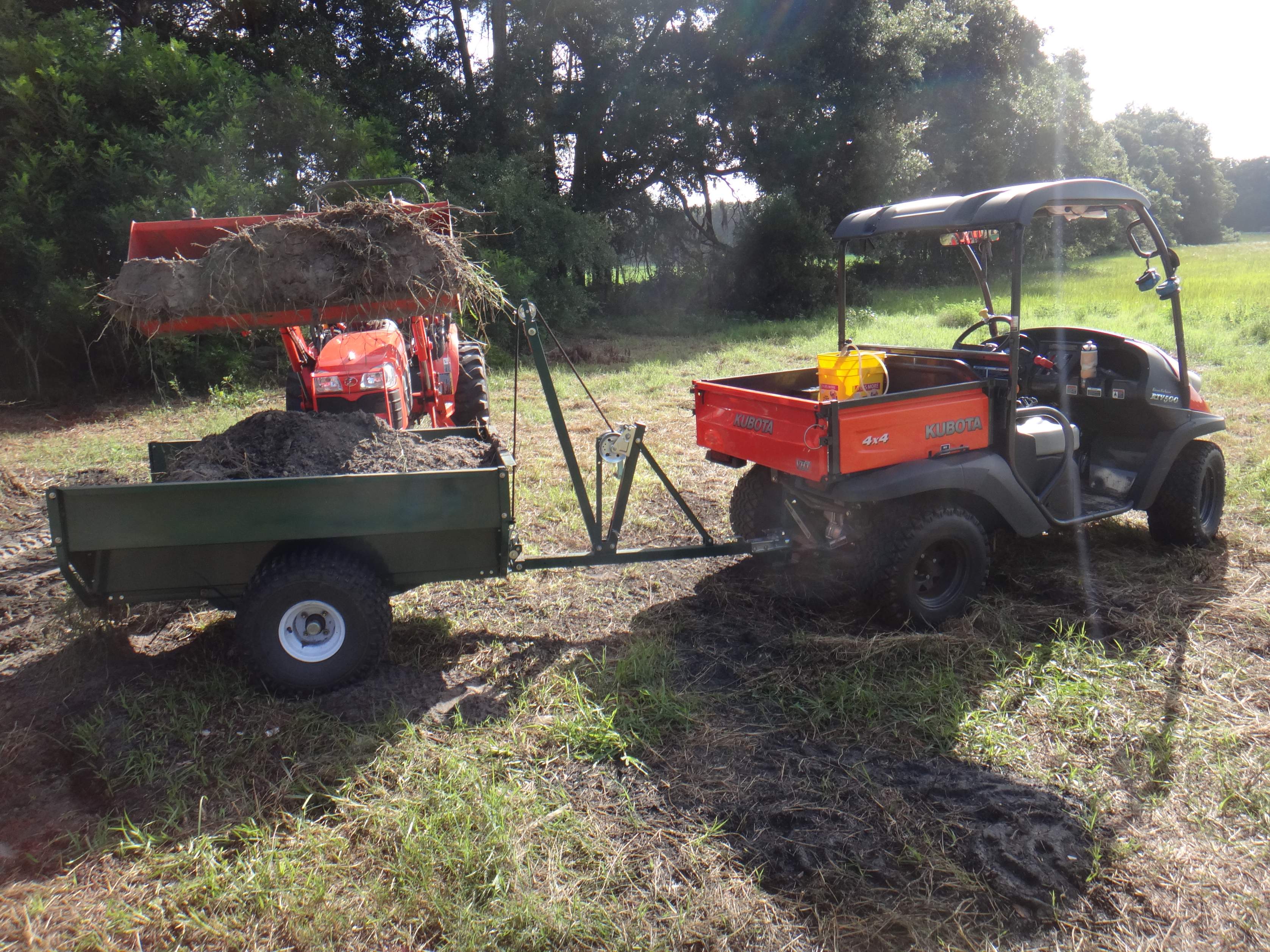

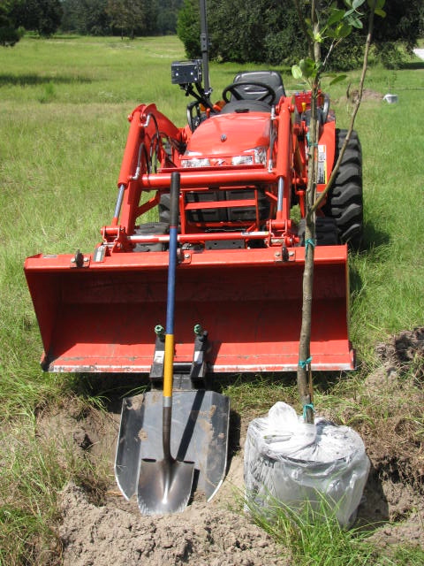

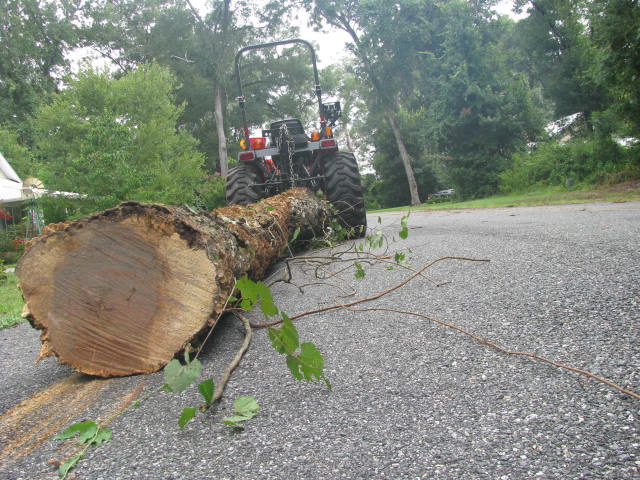

Secondary tractor tasks are performed with the Front End Loader (FEL) bucket, tertiary tasks are performed from the rear/center drawbar, mostly dragging.
All the tasks you have outlined are traditional tractor tasks for which refined implements and attachments are readily available.
For four acres of sloped ground you could use quite a small tractor, however I recommend a moderately heavier, wider, more stable small tractor like the Kubota L2501/HST, especially if this will be your first tractor operating experience. You might get by for a time with an L2501 for twenty-four acres ~~~~. To further stability on hills and slopes, order the rear tires filled with a freeze-resistant liquid.

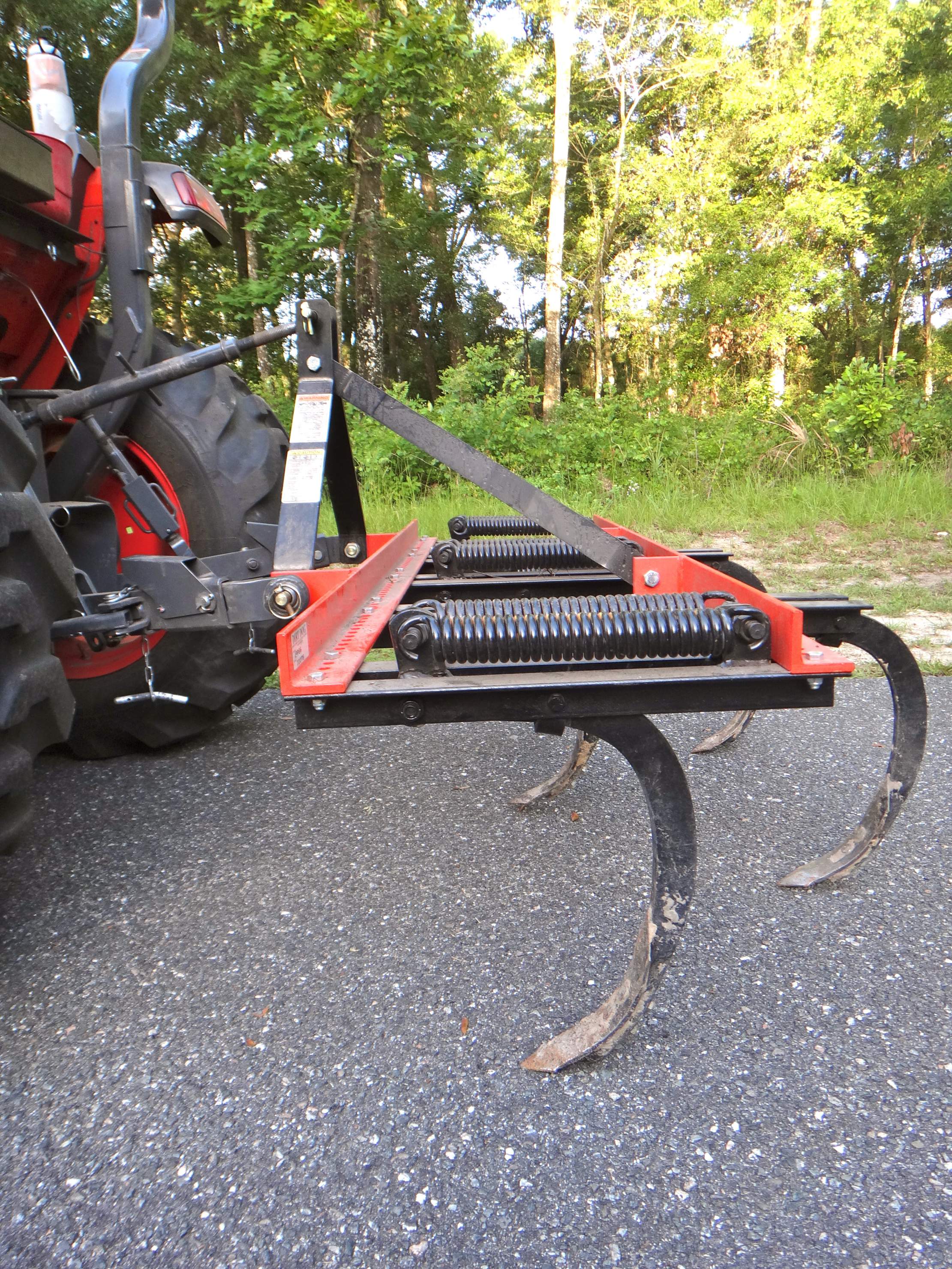

I would recommend a Ratchet Rake as your first bucket attachment and perhaps a Three Point Hitch Subsoiler as your first implement, for trenching, and underground water line and electric cable installations. Teamed, the Ratchet Rake and a Subsoiler will carry you awhile, in the tasks you have outlined, with minimal financial outlay.
