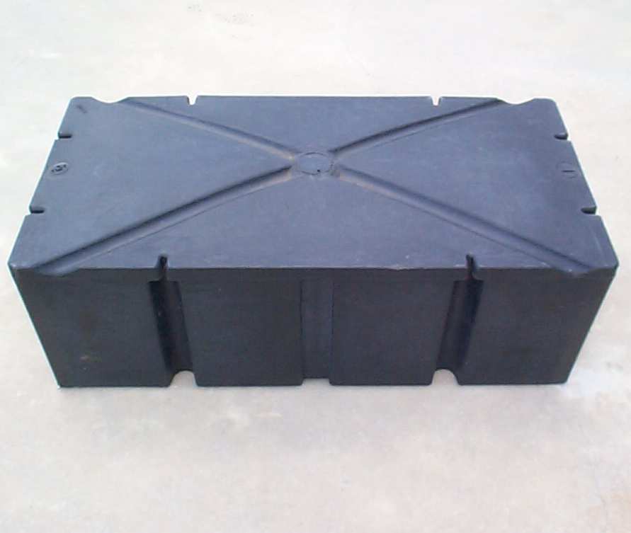

I've decided to go with float drums. They are easy to use and work well with 2x treated lumber. I've attached a picture of one. The only problem I have now is finding a local supplier as it will cost quite a bit to ship them. In fact, the shipping is more than half of the price of the floats.

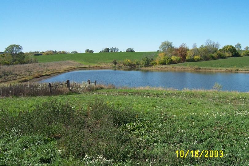

Attached is a picture of the dam area. As you can see, the water level is way down. We're behind 10" so far this year, and we only get 36" a year.

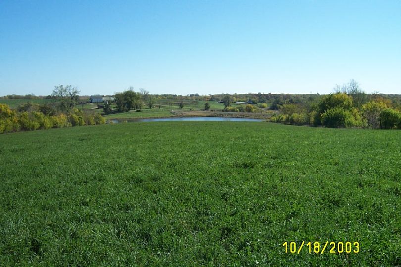

Here's a picture looking east. You can see about 50 acres here. The old homestead is there to the left. This was a dairy operation until just a few years ago. Still a few operating dairy farms in the immediate area.

Yeah, I did. You must be much closer than I am. The shipping cost for 8 of the larger, series 2 drums is $295.12, and the cost of the drums is $490.80. Shipping is 60% of the cost of the product. Ouch. We are talking about 240 lbs, though.
