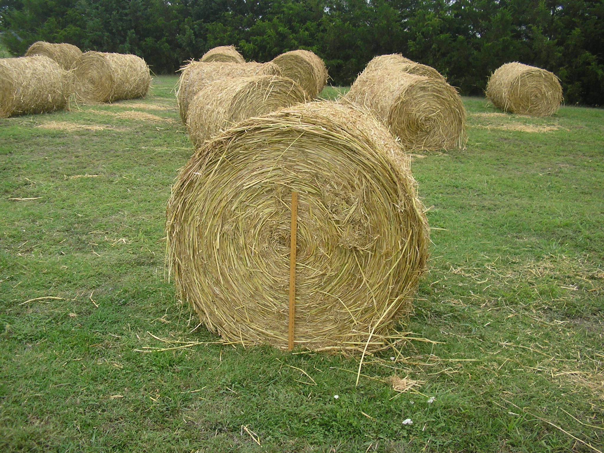

   / New Lacing on round baler belts: #6
Yes sir, thanks to you. Here's a couple of pictures of that crop:
   / New Lacing on round baler belts: #7
Your bales look much better than my neighbor's bales who has been custom baling for the last few yrs. I'm glad I could help you.Jim
   / New Lacing on round baler belts: #8
Thanks. Coming from a custom guy like yourself, that IS a compliment.
