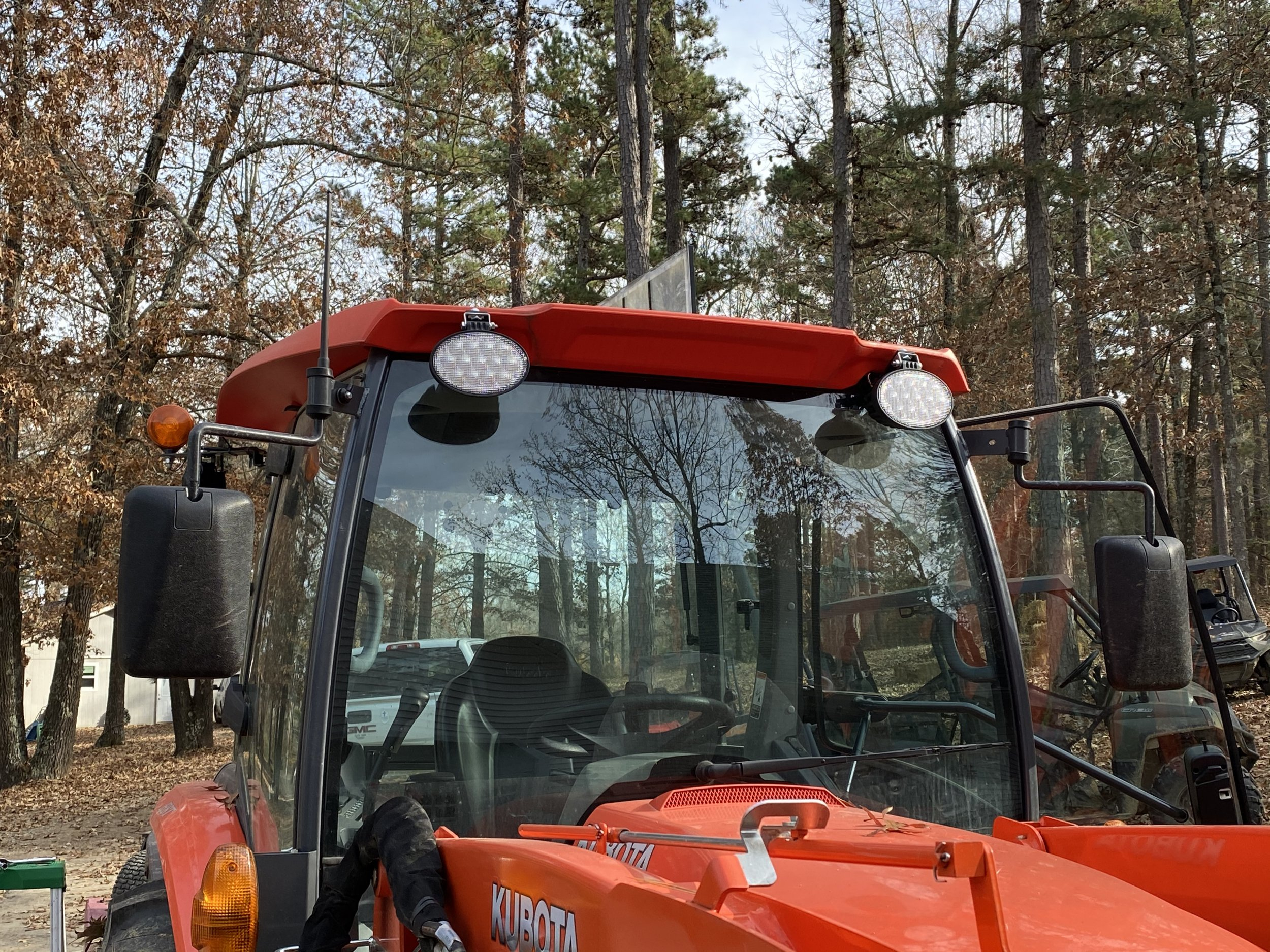

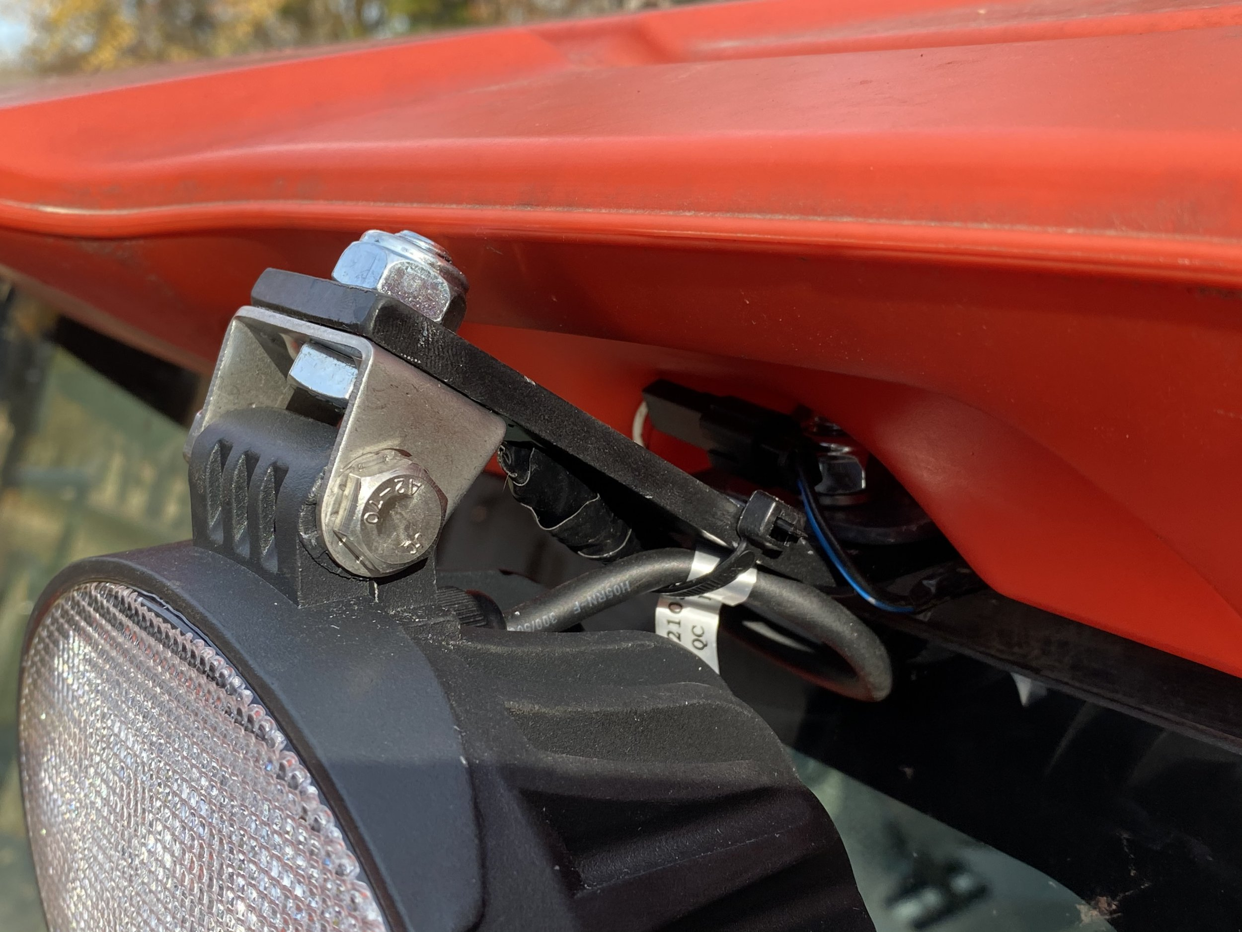

Had today off so was able to do some playing with the kubota. I ordered a couple LED lights off Amazon that got good reviews and seemed to be the right size for my needs. Big jump in brightness without a need to change any wiring.
I used some heavy flat stock to make extension brackets to accommodate the different light mount / bracket. One bend in the bracket and a couple 7/16 holes. New M10 bolts with nylon locking nuts.
Pretty simple.
