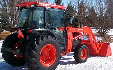

I am happy with mine. Get the bobcat style quick detach. It's handy.
Takes about 1 minute to dismount the loader and 2 minutes to put it back on. Just be sure you clean and cap the hydraulic couplers each time. You might want to add a tarp strap wrapped around the hose bundle and hooked to the loader frame. The hose bundle wants to rub the hood.
