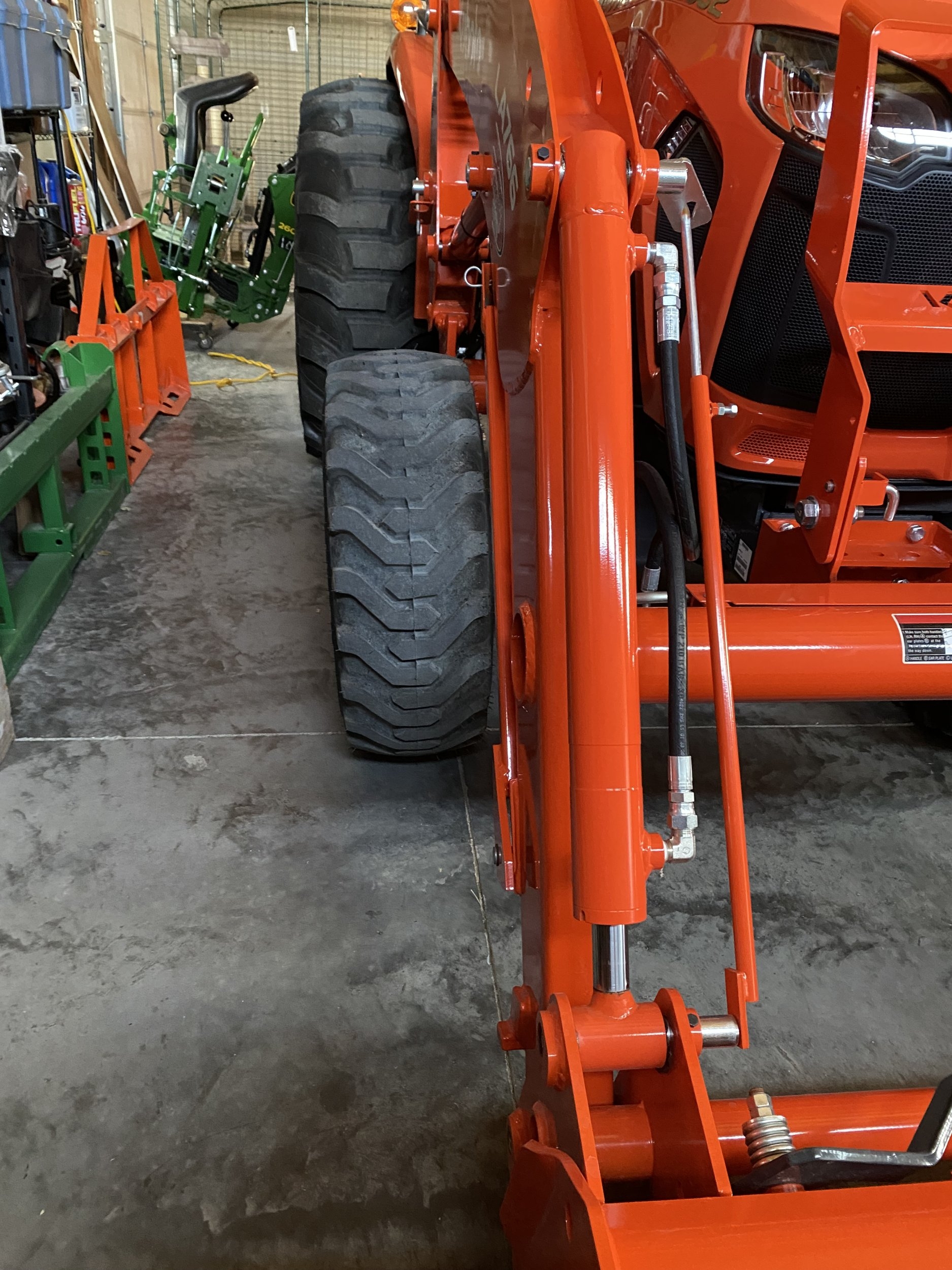

Well, I brought it to the dealer and they replaced the “hand valve“ in the steering column area, but it didn’t do much to stop the noise. According to the service tech, Kubota said the noise was normal. This was the only L4802 that the dealer has sold, so I don’t have another for comparison. just Doesn’t sound right. I’m going to check their inventory from time to time to check on others. Also, the wheels seem to be canted inwards a bit more than I’d ever seen on a Kubota. They said that’s normal too.
   / New L4802 Rumble sound when turning steering wheel #7
Can you share a picture? I've always felt my 4701 front wheels are angled a bit more inward than I'd expect, but I've never done anything about it (nor researched it).
Sure. I’ll take one tomorrow and post it.
#9
Here are two. I should have lifted the loader, but would have had to then vent out the shop… animals.

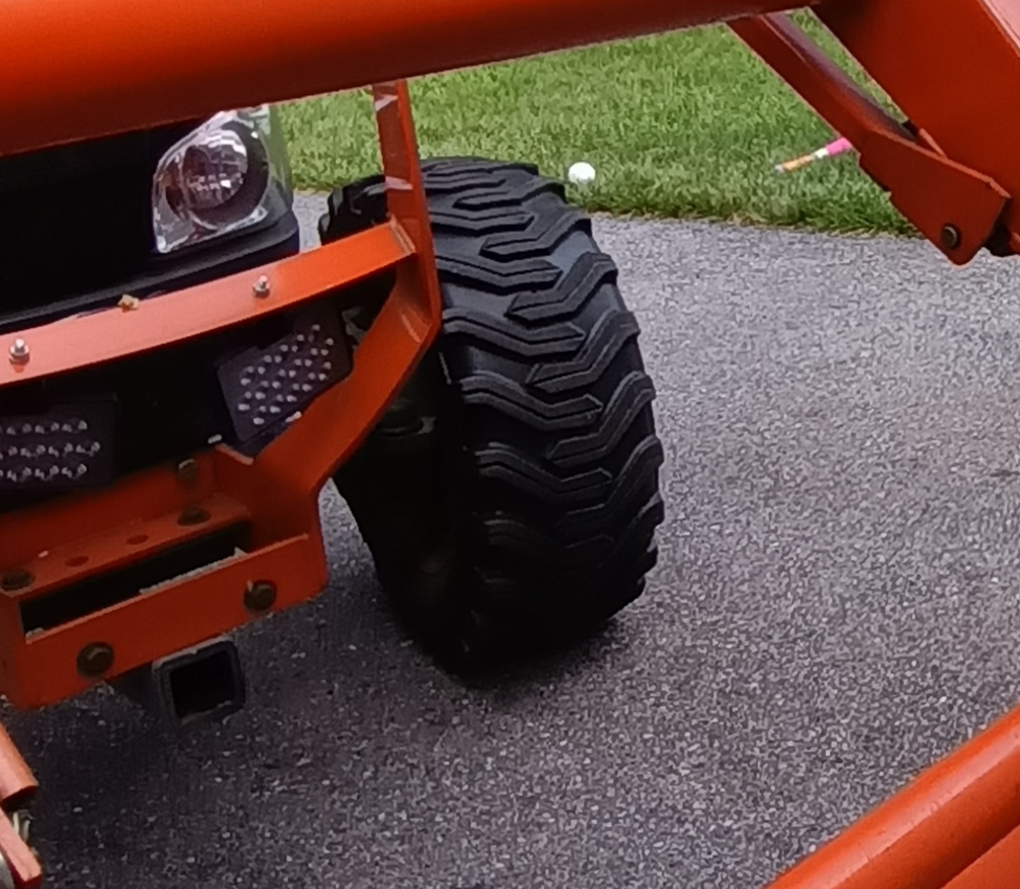

I've had a trio of 4WD Kubotae and a Ford. All have that what looks like way too much positive camber. Here's a pic taken recently that kinda shows the LF tire. I grooved them about 3 years ago. The tread is worn on the outside to the point the grooves are nearly gone, while the inboard side shows almost no wear. If it was easy I'd remount them on opposite sides. Most likely I'll just recut the grooves.
