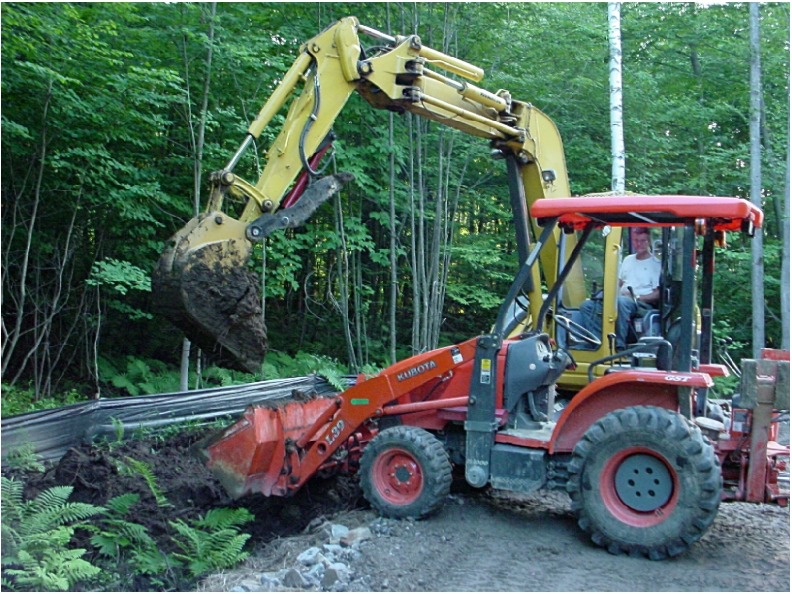

As an example of my 580 HP 1002 Mustang Cobra with +40K miles and original clutch, I may be hard on the equipment but not abusive and I take care of them.
My L39 has been reinforced and I try not to be hard on the engine and drivetrain. i tighten the frame bolts regularly and grease vewry often. Look at this way, my L39 is proven. It has a new hydraulic pump.
No plans to sell. It's better than new in all ways down to the protective layer of mud over the paint.
My B7200 has been through more as I look at as less of an investment loss if I wreck it. The B7200 still runs reasonably well.
