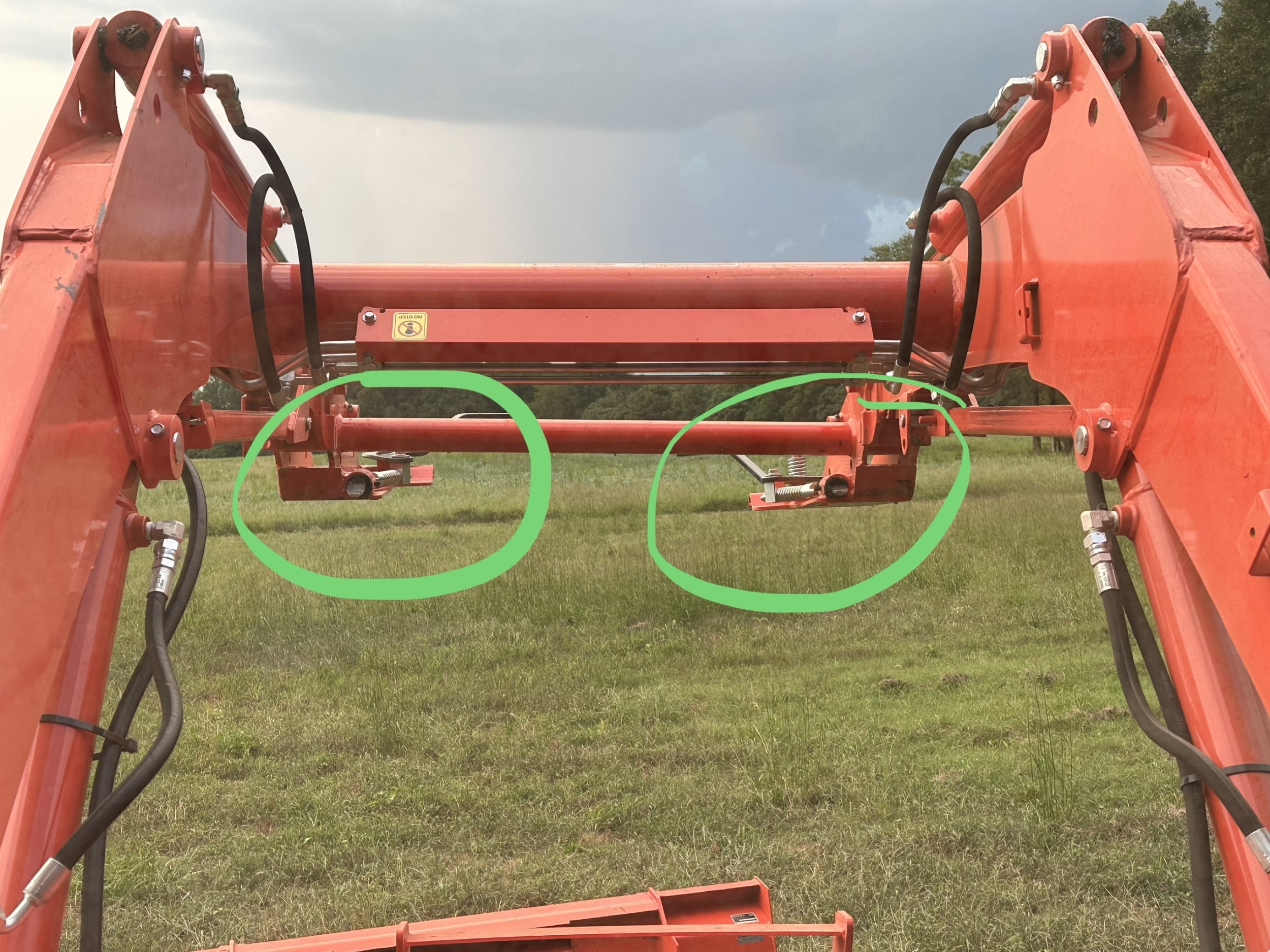

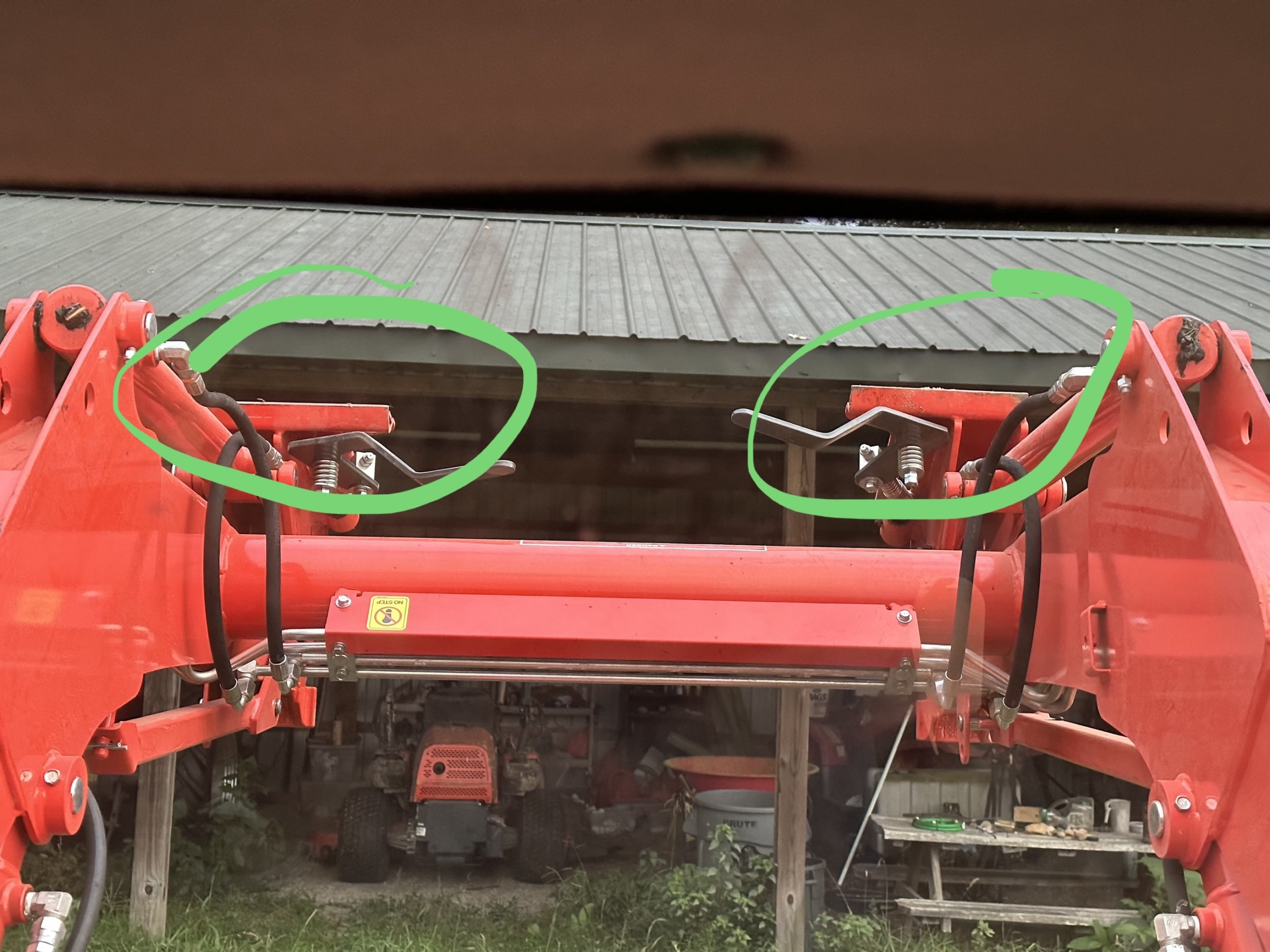

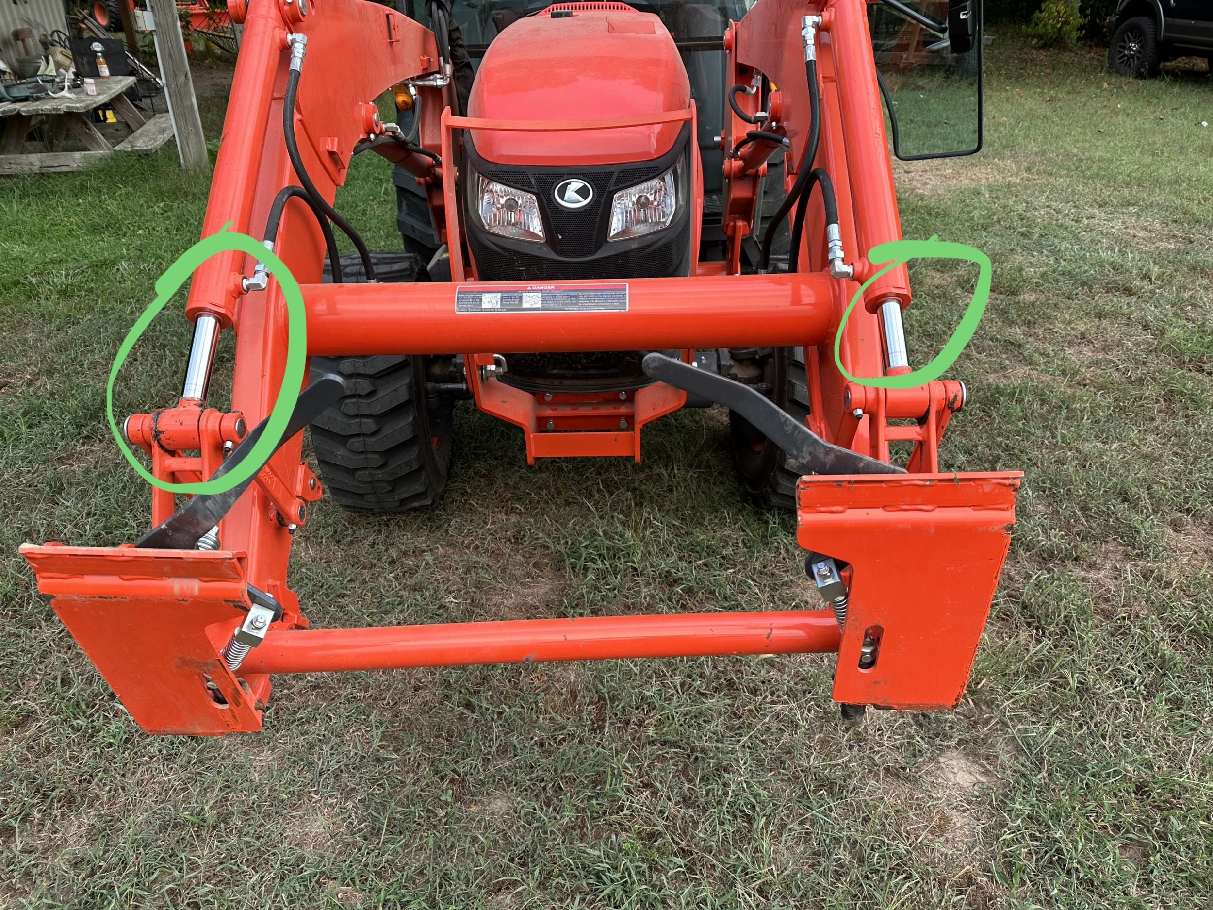

Brand new MX6000 with LA1065A Loader. Bucket came off on left side, seems the hydraulic on one side is not set the same as the other? Is there a fix for this? Need to get the bucket back on. Thanks

Agree with Gator6x4. The crosstube has twisted/bent on the coupler. Thst shpuld not hsppen....unless, you caught the rh edge under something solid and rolled it back. Just speculating.

You can see the damage on the passenger side mount. Looks like someone lifted without having a good lockup and the driver side popped out. Was it delivered with a bucket or something mounted? Did it take a lot of force to release?

Exactly the driver side had popped out and I did not realize it.

The SSQA mount is bent to hell...looks like they ran it over in the parking lot lol. I would require a new one. They can bend this one back until they get a replacement in so you can use the FEL.
