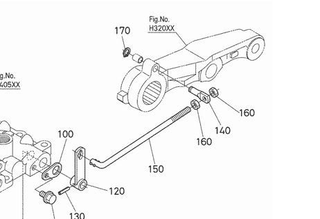

Is your 3-point hitch control lever all the way up? I discovered on my new L5460HSTC that if the 3-point hitch lever is moved all the way to the top of the quadrant, the hydraulic system stays on high pressure and all other hydraulic functions either don't work or are very slow and jerky. I adjusted the metal stop to where the hydraulic system raises the hitch to full height and doesn't continue to try to raise the hitch and stay on pressure. Move the lever back about 1/4 to 1/2-inch from its top most position and see if it changes the jerky steering.

You could adjust the nuts on the feedback rod so as rockshaft control valve neutralizes when RS reaches the top of it's stroke to eliminate the problem.
