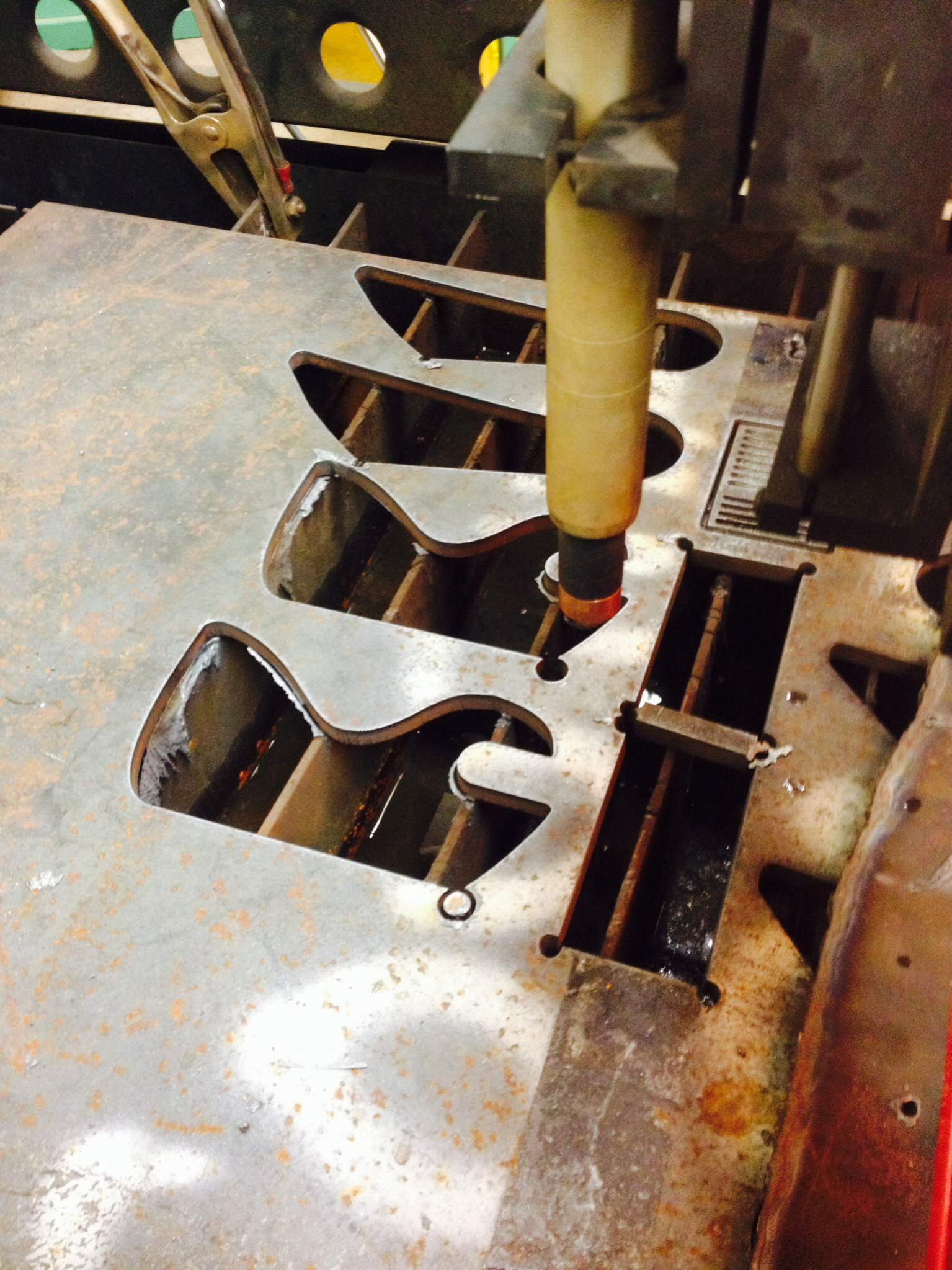

I know I am year late to this party, but I just got my bx about 3 months ago and have been working to replicate the kwik com. I love the mods 4shorts makes and have been working to install some of them. It still needs the crossbar piece and second layer over the holes. I used some design software to make the shapes and have the .dxl files or jpegs if anyone wants to use them. you could print and trace or I used my CNC plasma to cut them out. The problem with the CNC plasma is that the holes slightly bevel out, so I made the holes too small and bored them out on the bridgeport. I just realized my pictures are pretty small. I will remedy that later and upload more as it gets finished.

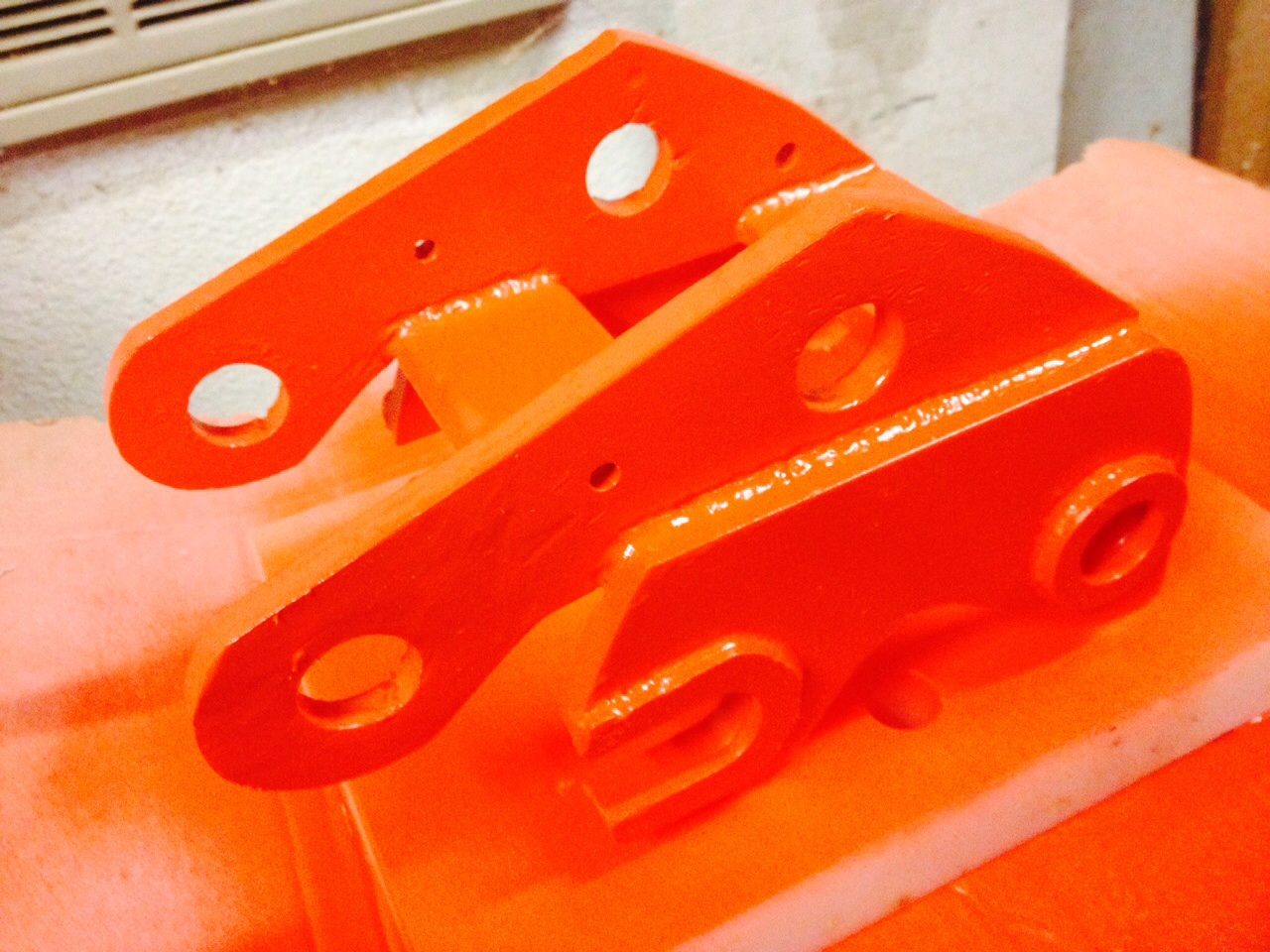

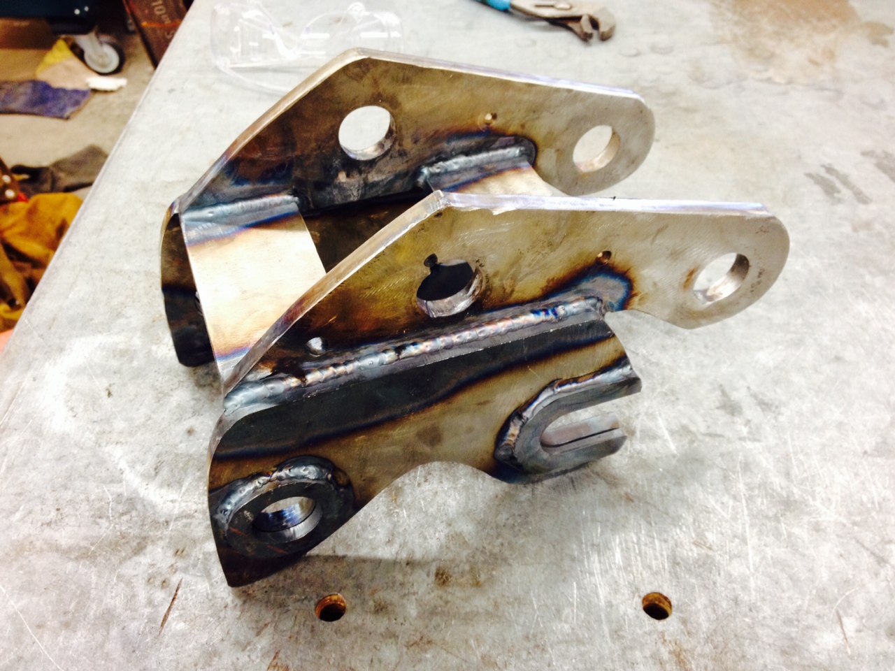

i can send vectors as .ai .dxf .eps and .svg other than that it would take a touch of work to import it into solidworks and export as a 3d object. Your 3d software should be able to import vectors and then 3d them later. I didn't need 3d shapes for this project. what 3d software are you using cschulz? I can't find a way to upload the vectors directly to the forum. I will keep trying to find a way.
Anyways, I TIG welded her up today and put on some primer.

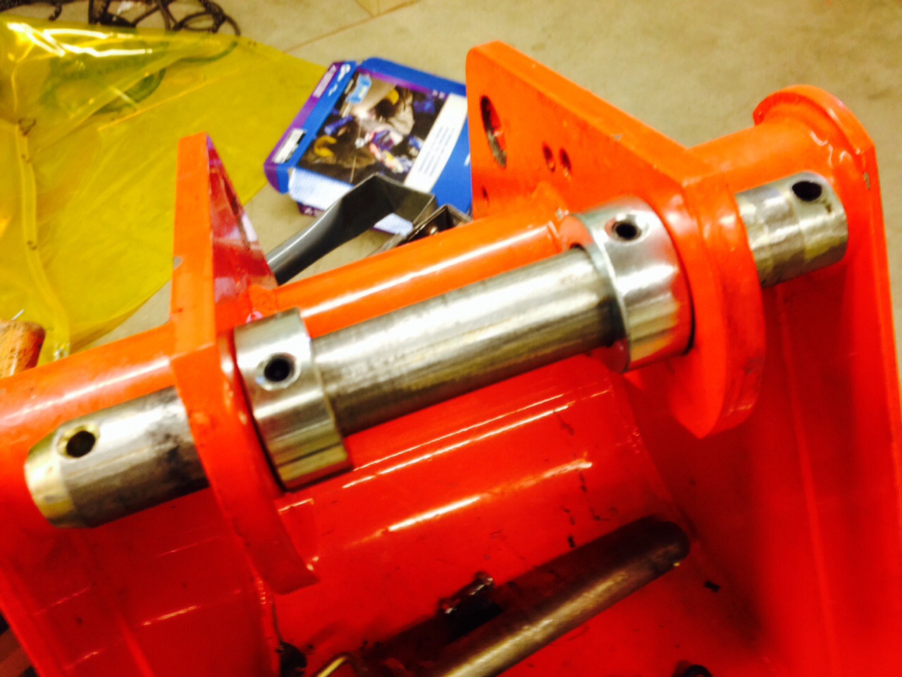

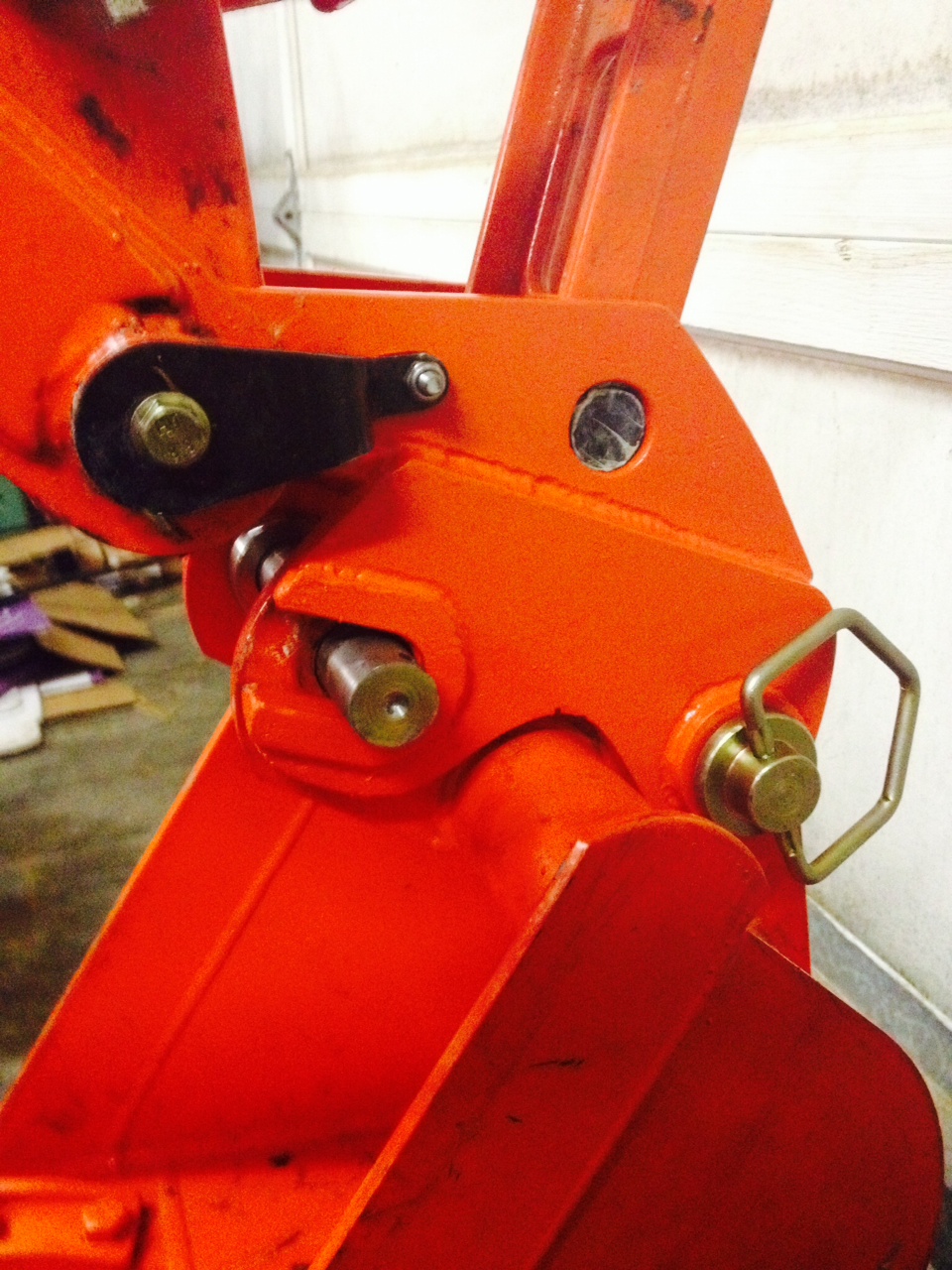

Finished the paint and heres a picture of the pin with 2 shaft collars inside the bucket part.
   / New Kubota BX25-D Mod #27
You Rock Marcus! Looks real good and I like the collar idea. Also send you an email about parts.

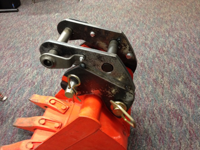

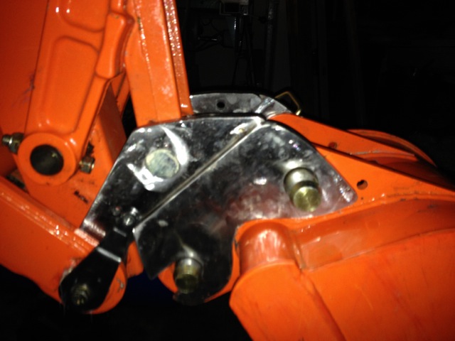

Finished up. A little tweaking, but it works great. Thanks Paul Short for the idea. Just like anything you do once, I know how I would improve it in the future.

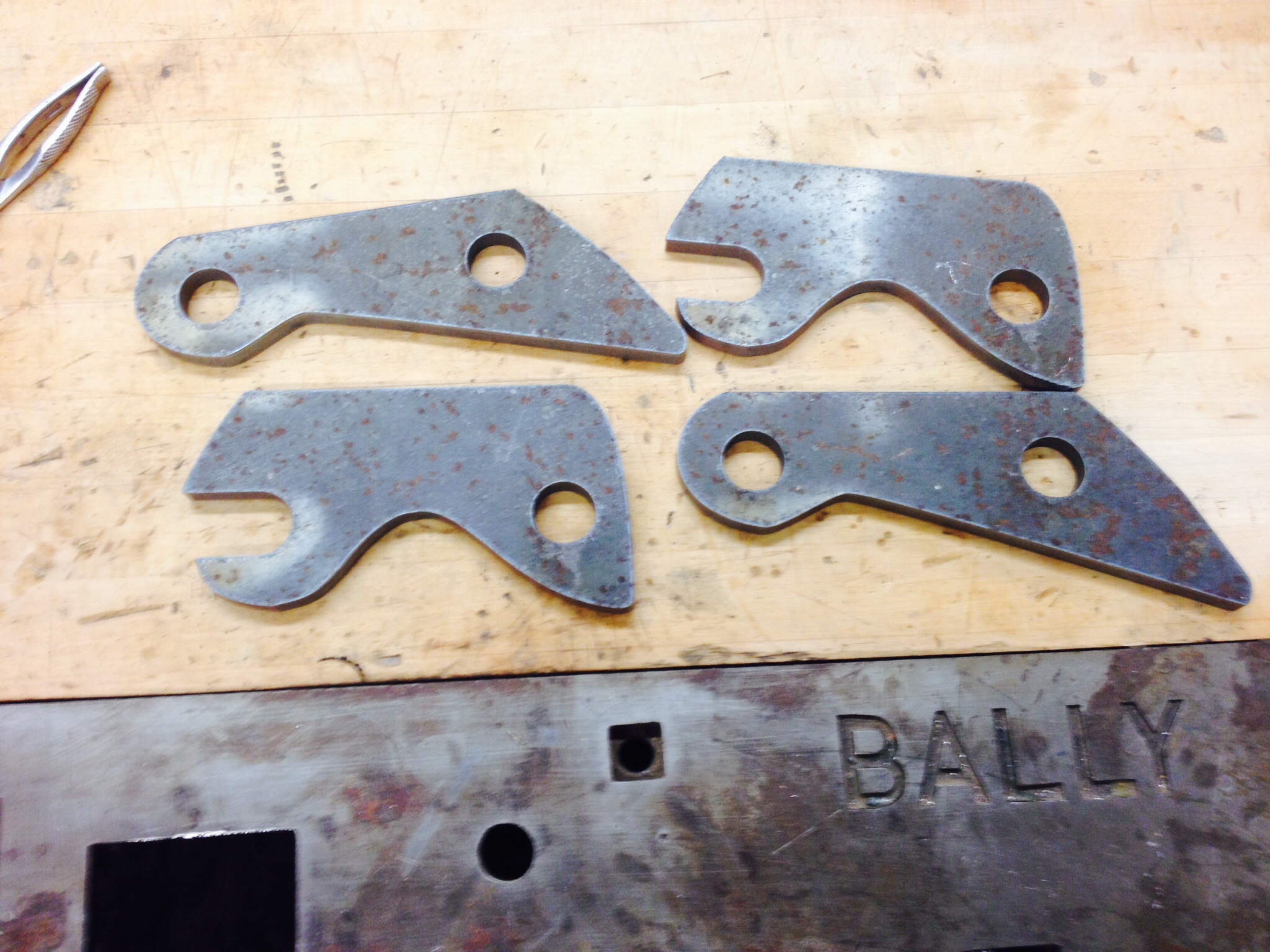

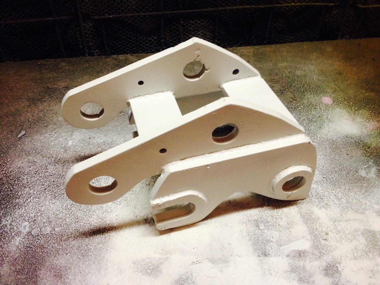

Cshultz. These are your parts. Since i didnt have pics of my individual parts i thought i would photo yours along the way
