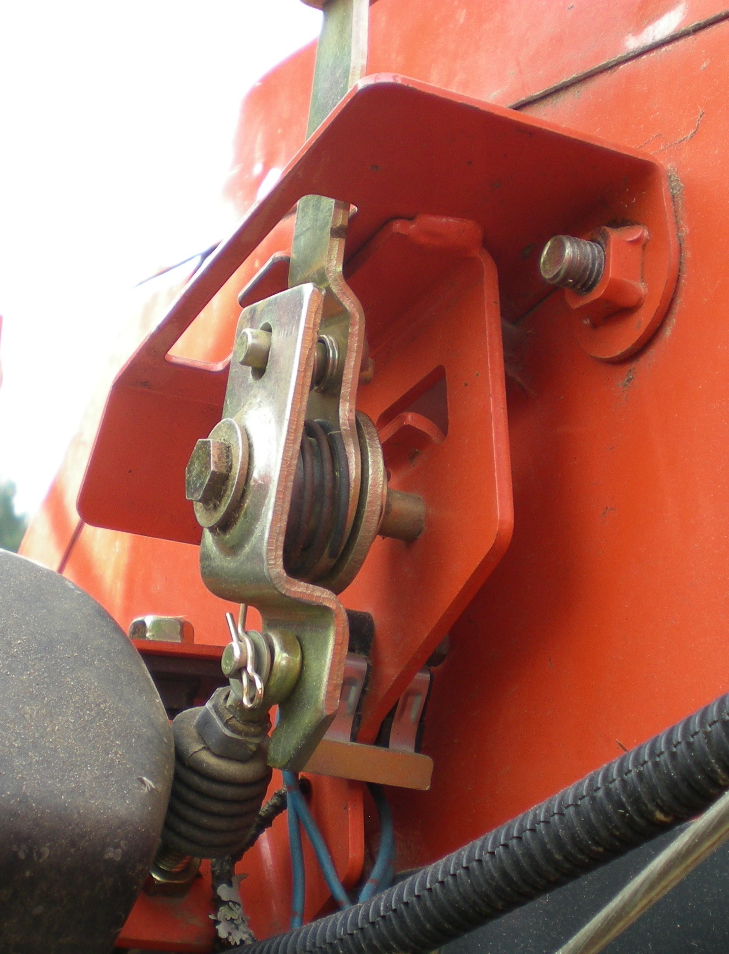

I was mowing today and went to get off to move something and the tractor shut down. I thought I had neglected to disengage the PTO and had tripped the seat shut off. A quick google search did not help so I called my dealer. He said while pushing the PTO lever to the disengaged setting firmly and I got it restarted but the PTO continued to run in both the engaged and disengage setting. So I didn't get off the tractor for 5 hours! I am assuming this will be a service call. What is the fix? I have owned it a year and it has 45 hours on it.

Not sure how yours works. On the L3200 I had there was a sticking cable / gadget under the tractor that was fixed really fast with some lube.
   / New Kubota 3901 PTO running in both the engaged and disengaged setting #6
Was just going to make the same point. The PTO cable mechanism is not something that gets "reinvented" every time a new model comes out. It's pretty foolproof IF it remains lubricated so dust, grass clippings, etc., doesn't bind it up. I always gave mine a shot of spray lube every few months.
I called the dealer today and they said the same thing. I just got done mowing 4 1/2 acres of weeds that were 8' tall and loaded with pollen so t\I bet thats what it is.

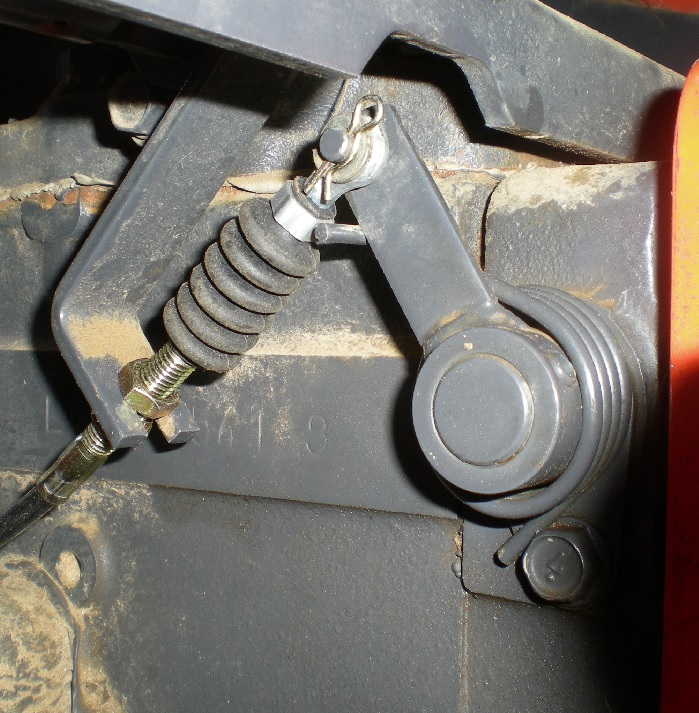

So how does one clean this cable? Do I just follow it to the transmission and clean and lube it? Is it obvious once I get under there?
   / New Kubota 3901 PTO running in both the engaged and disengaged setting #10
Hst you have to remove the cover under the seat... a few photos... You pull the rubber boot back and fill it up with lube on both ends... I would also lube the spring, too...
