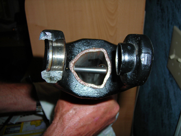

/ New King Kutter 6' Tiller
Another update on the saga. Dad and I found one of the two missing pieces off the female tube end yoke. Upon inspection, most of the broken area is void of metal. There is a large fissure in the area where the break happened. Dad is going to take the PTO shaft and pieces back to TSC. The Bondioli Pavesi PTO shaft is at fault. I hope TSC gives us another PTO shaft when they see the defect in the metal.
If you look at the attachments you will see that most of the inner metal is covered with black paint.

/ New King Kutter 6' Tiller #8
Todd, I think you are getting "TSC'd" in this deal.:mad:
My KK 6' tiller came with a PTO driveshaft that was painted yellow like the rest of the tiller. I've tilled my 1/3 acre garden with it at least 8 times and no problems with the slipclutch or any other problem. I know you said that they took the PTO shaft off another tiller, but it seems your TSC is PTO challenged.
I went back to TSC today and I showed the manager the two pieces that broke off the yoke and the yoke. He shook his head and within a few minutes, I had a new PTO/slip clutch that was yellow. The manager said he was going to send the broken PTO back to King Kutter and he agreed that this PTO was defective. When I purchased the tiller, the now broken PTO shaft came from a 5' King Kutter Tiller that was next to the 6' tiller I bought.
I got home today and put the new PTO on and I tilled several areas with no problems. I'm just glad this is over.
