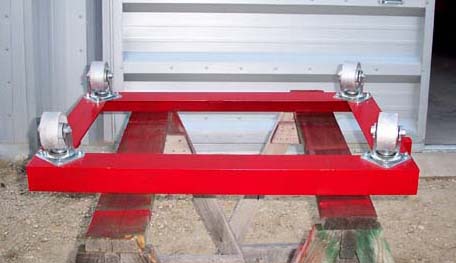

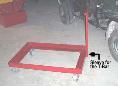

I'll post some pics of my dolly for you Drafthorse.
The support is a "T" that fits into a receiver slot on the dolly. The chipper feed tray sits on the top of the "T" .
I made it removeable for storage purposes and it allows me to use the dolly for other things. It also makes it easier to set the chipper onto the dolly using the 3PH.
In PIC 2 all I am going to do is to extend one side of the feed roller handle downward and attach a foot pedal at the bottom. It will look like an elongated "L"
Here are the pictures.
Pic 3 shows the T-Bar clearly. It is made from 1" square tubing. The sleeve, hard to see, is a 3" piece of 1 1/4" square tubing.
Pic 4 just shows the 400# steel casters.
