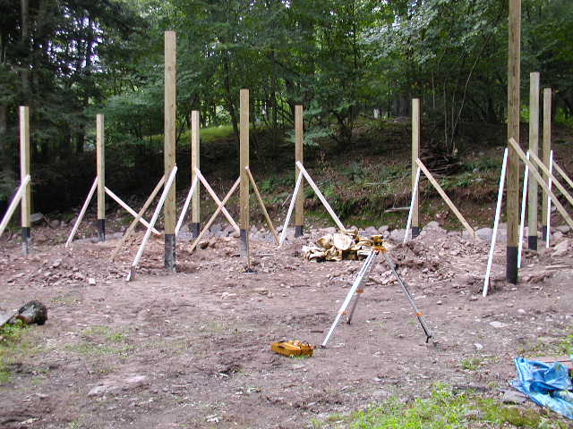

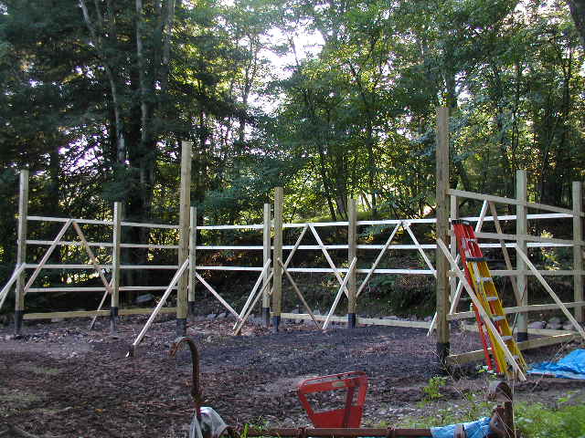

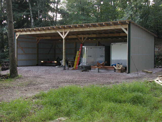

A few pics of the implement shed that a few friends and I built over the last 2 weeks. This all started when I purchased the new McCormick this year and did not have enough space in the garage. I also had several items that I was storing under tarps which my wife just hated. So what else to do but put up another building!

Looks good! 16x32?
/ New Implement Shed
Thanks! 20x40

Looks good, what did you coat the bottom of the posts with?

Good looking shed. I built a 20x28 ft version a few years ago for my haying equipment.
Russ
I wrapped them with 90# felt paper and used ice & snow shield on bottom of the poles. I figure they will be around longer than me!
Thanks for the compliment!
Ice & snow shield is a tarpaper like product that has a sticky side and is designed to adhere to the plywood on a roof and stick fast. The sticky part seals around the nails that would be used to put shingles on. It is used on the bottom 3 feet or so of the roofs in northern climates that are subject to ice dam buildup.
I just had some left over from the house that I built 3 years ago and felt that it would be a good product to use on the bottom of the pole. Just trying to do what I could within reason to make the poles last as long as possible. It is much easier to take a few minutes and prep the pole before it goes in the ground than digging them up later!

Id love that but would want doors on front. Now if I knew how Id be in business
#11
I can always add them if need be. I would put slider type on and make each door 10 ft if I decide to go that route.
