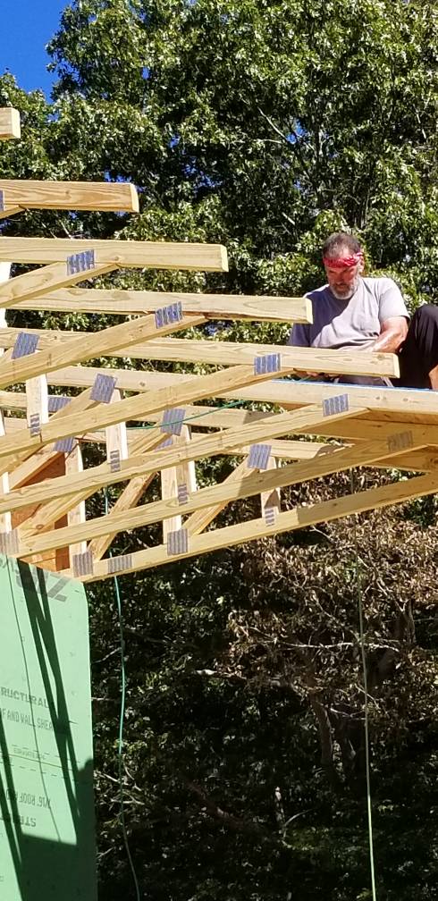

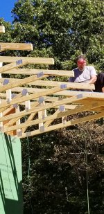

Here's my buddy J perched on the porch overhang. He got a roofer friend out today to install all the roof sheathing for $500. Gladly pay that so I could stay on the ground.
A few more sheets of zip, a little more blocking and hurricane clips and I can get rough framing inspection. Have to get inspection before 11/10 or my permit expires. Once I get an inspection I get a 6 month extension on permit. 20181021_140247.jpeg

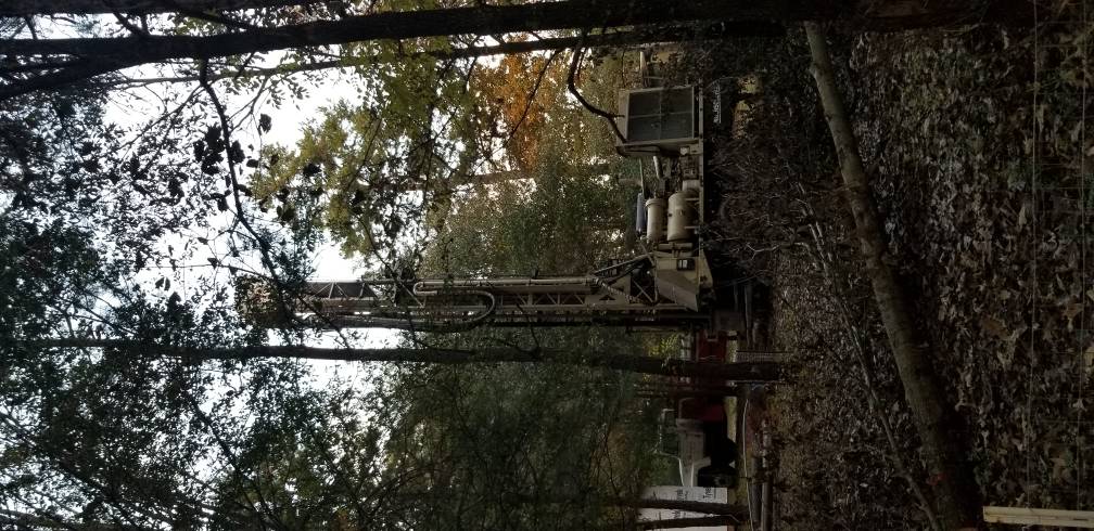

Well driller finally worked me in. The went 88' to bedrock and started casing yesterday. They're now working on casing and sealing, then start drilling rock.

Anxious about the well. Hope that goes well (pun intended).
I'd be a nervous wreck to be that far along and not have water. We don't any aquifer to hit here. Just try to hit a vein that adequately produces.
