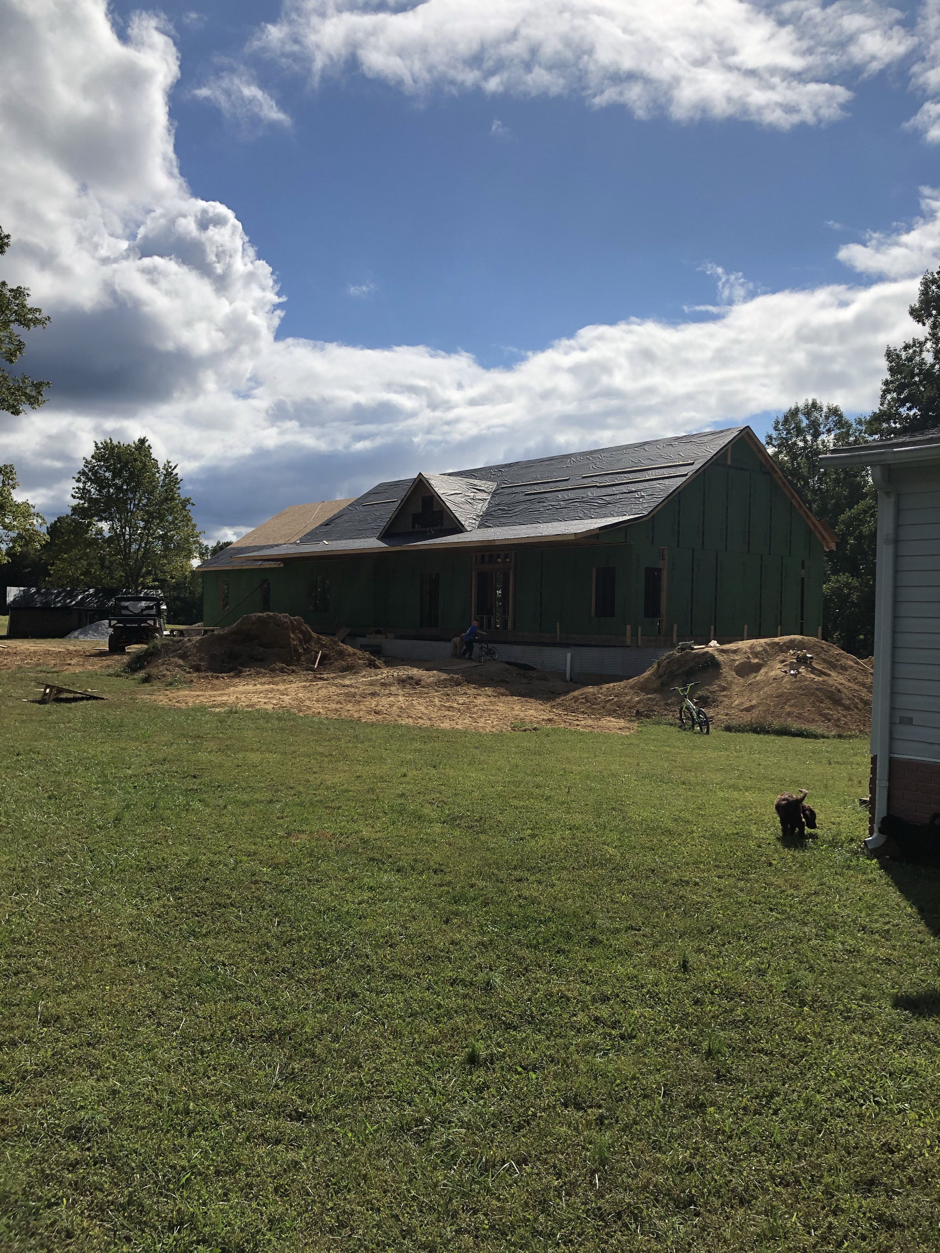

Not a great picture due to the sun, but we did finally get the roof covered with synthetic underlayment this afternoon. Man does it feel good to have all that wood up there and done!
In the picture you can see one of our 7 week old pups. She goes to her new home tomorrow and is the last one to leave. We agreed to meet the new owner in Morgantown, so I will take tomorrow off from the build to go with my family to to deliver the pup. Her new home will be in New Jersey.
Maybe I’ll get some dirt moved if we get home in time, but it’s 3 hours each way, and we will make a few other stops along the way. After 7 straight days of daylight to dark work, I’m kind of looking forward to a little break.
Sunday morning, I hope to get the posts marked for the back porch and get ready to start building it. It is the last major piece of the framing. Need to get utilities hooked up in the near future as well.

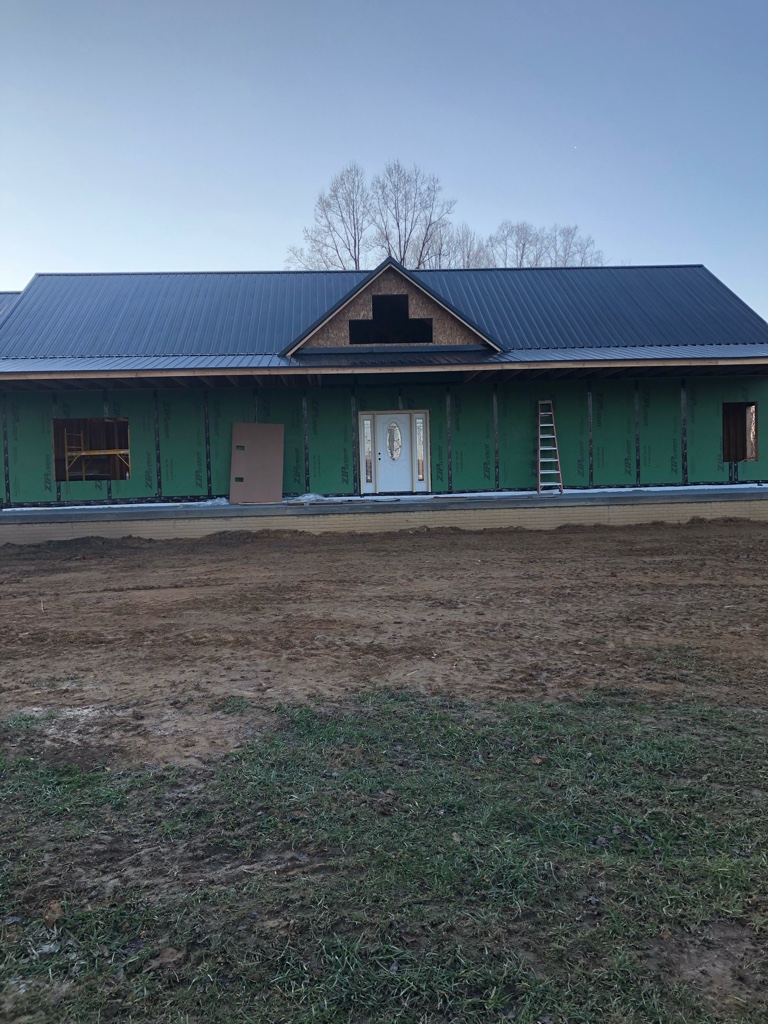

I did finally hire a roofer. Going with black metal. If he can get Metal cut today, he is going to try to get his guys to work over the weekend, so he can fit me in between other jobs he has going. If not, it’ll be later next week before they get started. Back of the house can’t be done until the porch roof is tied in, so that has to take priority.

shingles are $100/square here at the box stores. Metal is better. Never seen a black roof. Are you going to have a way to keep the heat out of your attic when the son shines hot?
   / New House Build in WV
#87
Shingle prices are crazy high, thousands more than metal, and everyone says I’m crazy to not go metal from the start, so hopefully it works out as good as everyone says it will.
I’ll have ridge vent and soffit. I can add venting if it’s needed. Didn’t put much thought into it since most shingle roofs are black as well. Open to opinions on it for sure.
I chose black because I don’t really care for most brighter colors on a roof, and it matches pretty well with the other colors we will use. A couple houses close to us recently put black metal on and it looks sharp.
