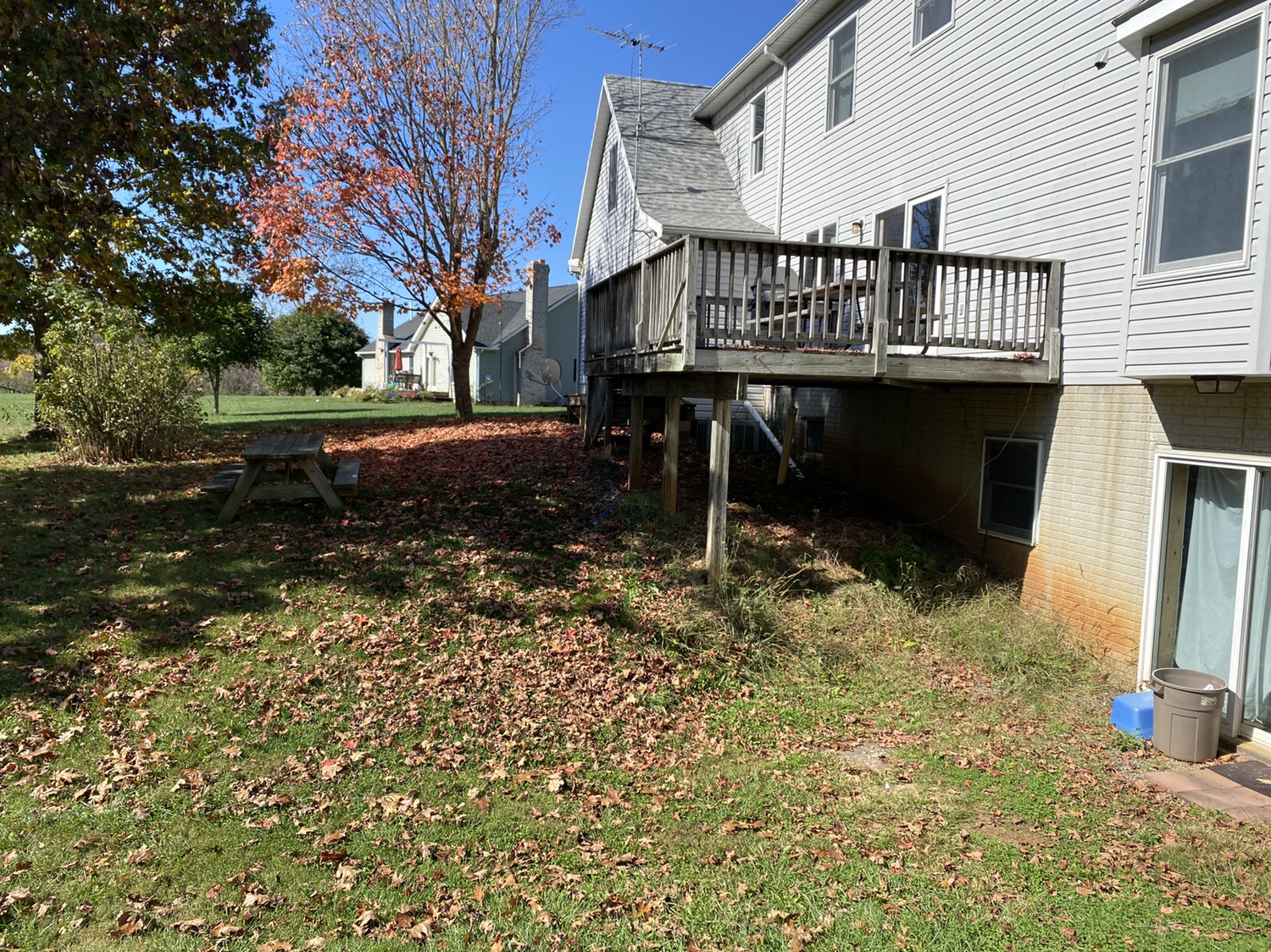

Love the deck and railing. Makes me want to replace my crappy looking PT railing. To do that, will be a major deck rebuild as I would want to do new flooring also. How do posts attach to deck?
Didn’t mention year on purpose!
The posts are regular 4x4’s with post covers. I cut a hole in the decking, ran 4x4 to the bottom of the joists and added framing between the joists where needed to level them. I initially screwed the posts into the framing with 3” deck screws, then added 3 1/2” structural screws after railing was up and I knew I didn’t have to adjust the posts. They seem very sturdy with very little movement at all.
Rail sections were 8’, actually 91 5/8”, and I cut equal amounts off both ends to fit. Worked out very well.
Railing wasn’t cheap, but it’s the look we wanted and should be fairly low maintenance other than cleaning.

Did you put a joist 6” from the end of deck to support the edge piece of trex? Assuming end piece is 5.5” wide, it looks narrower.
   / New House Build in WV
#484
I did. The 4x4 on the end section is actually notched to go over it and then fastened in through both sides.

Is deck joists 12” or 16” oc?
#489
Mine are 16” on center. It works fine but, if your at eye level with the decking, you can see a small amount of sag in a few places. If starting over, I’d go 12”. 12” was recommended to me by other posters but I was too far along to change it, and just didn’t have time to redo as I was on a tight timeline with the roofers coming.
   / New House Build in WV #490
I asked because mine is 16”, and changing to 12” would be more work than I want to put into it.
I was at Lowe’s tonight looking at trex ( they carry toasted sand color)$40 each, $90 for 6ft rail kit, $35 and $41 price on post sleeves, the boxes look identical.
I would like to put a roof over the deck, it was in my original approved plans but I never built the roof. My deck cantilevers a couple feet past the bottom beam, the issue is where and how to support the roof posts.
Wonder if I could fill between 16” joists with 2x6s to help support? Thinking out loud.
