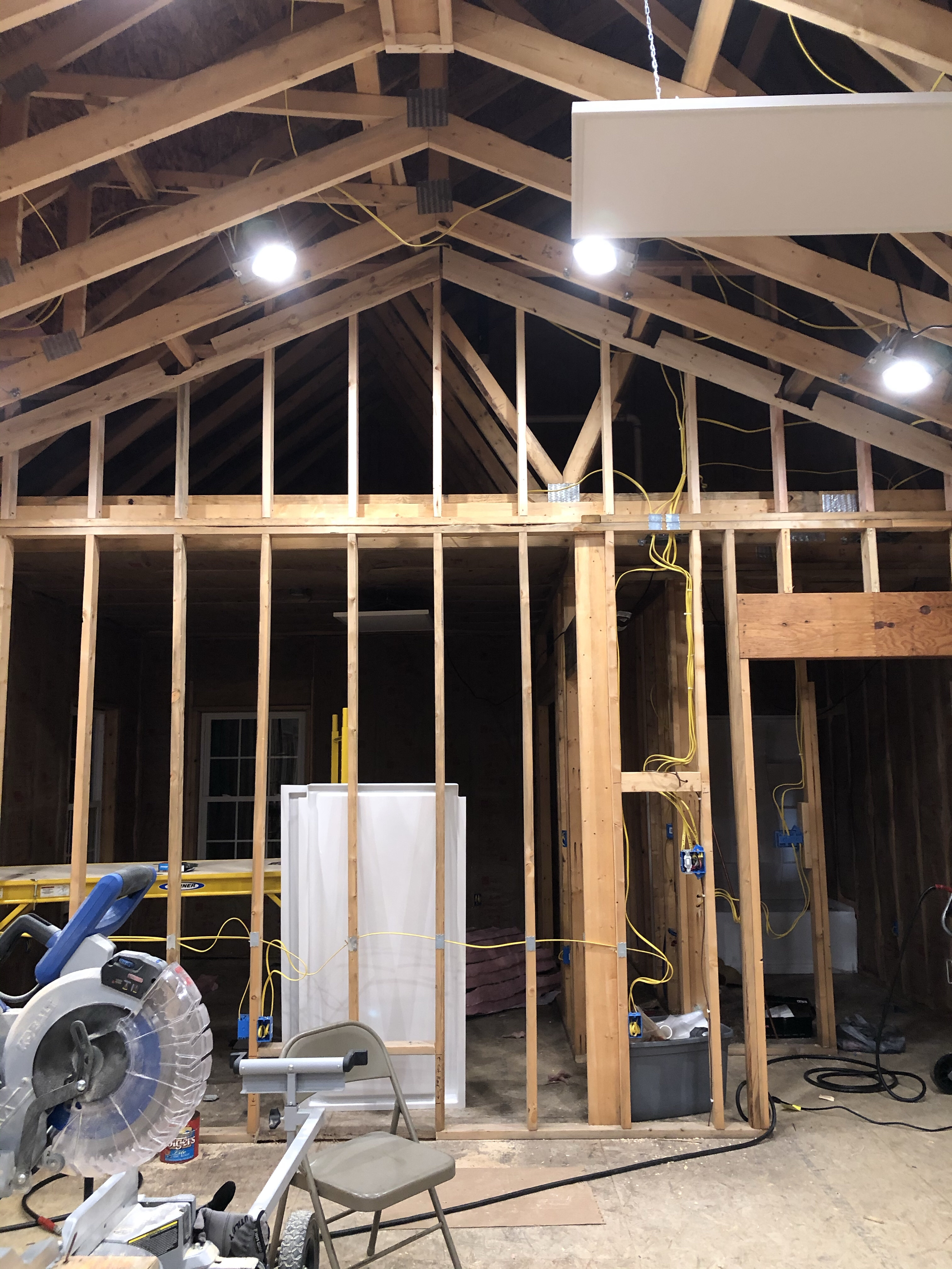

Made good progress this weekend, but it’s never enough.

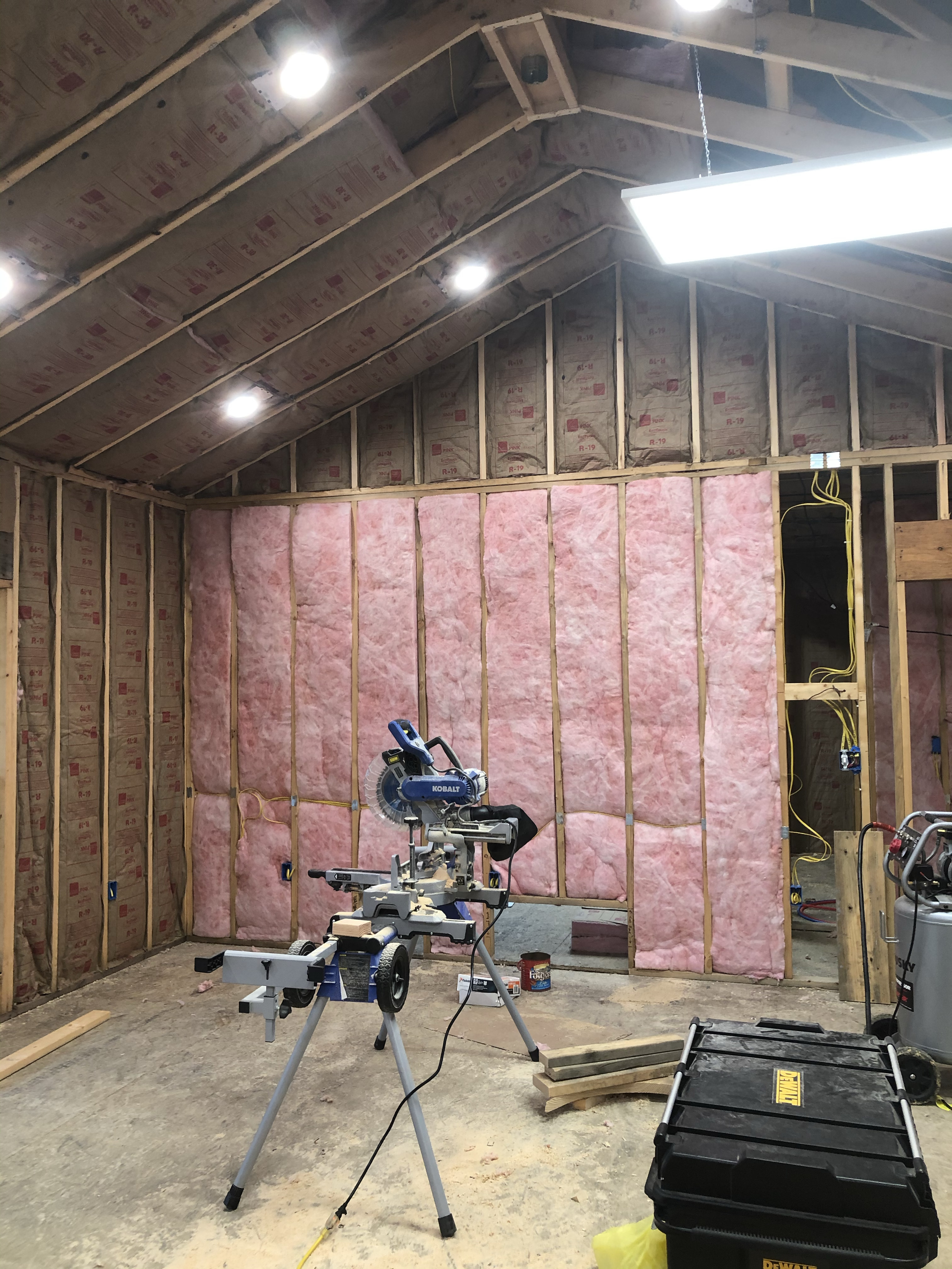

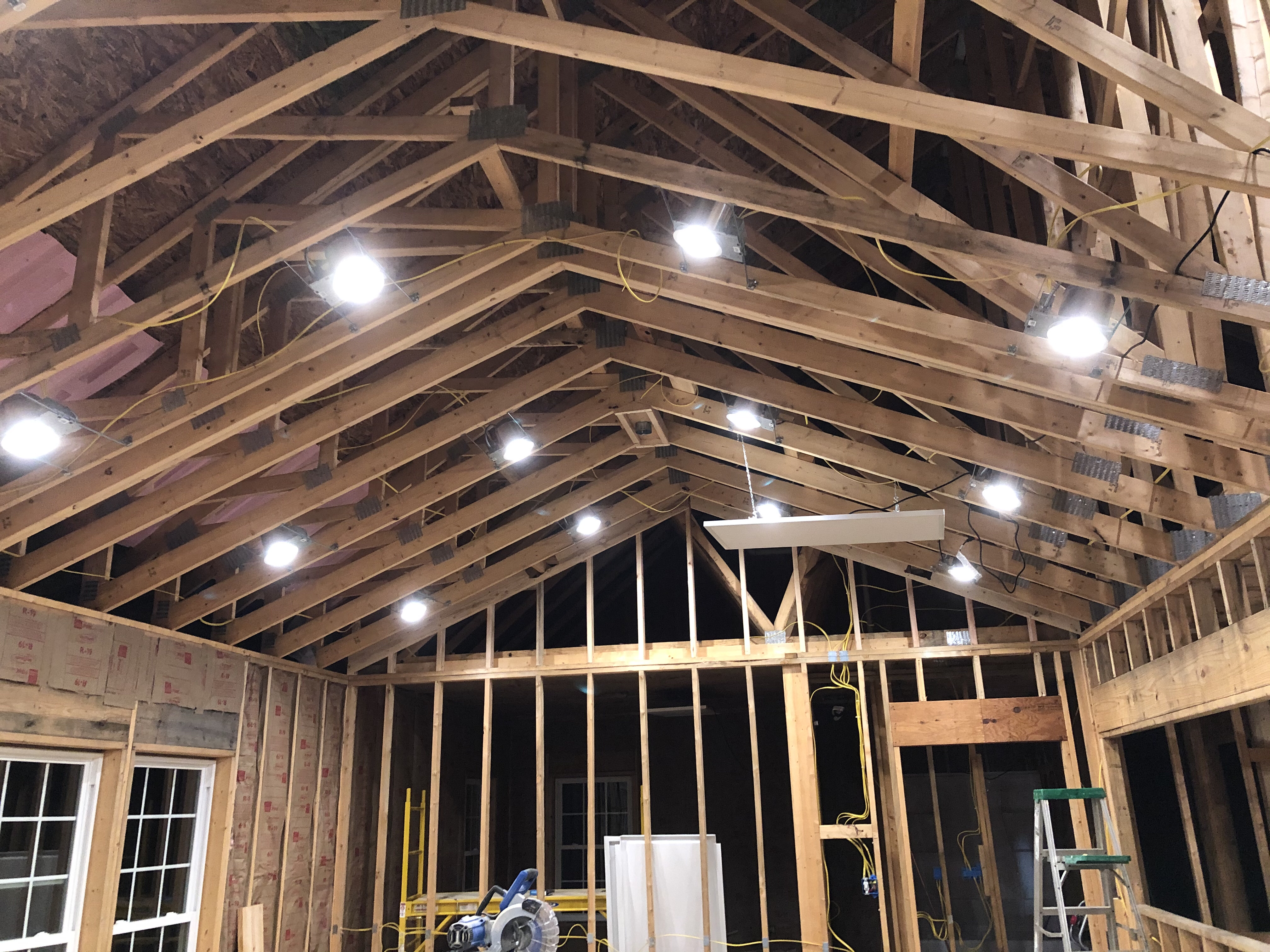

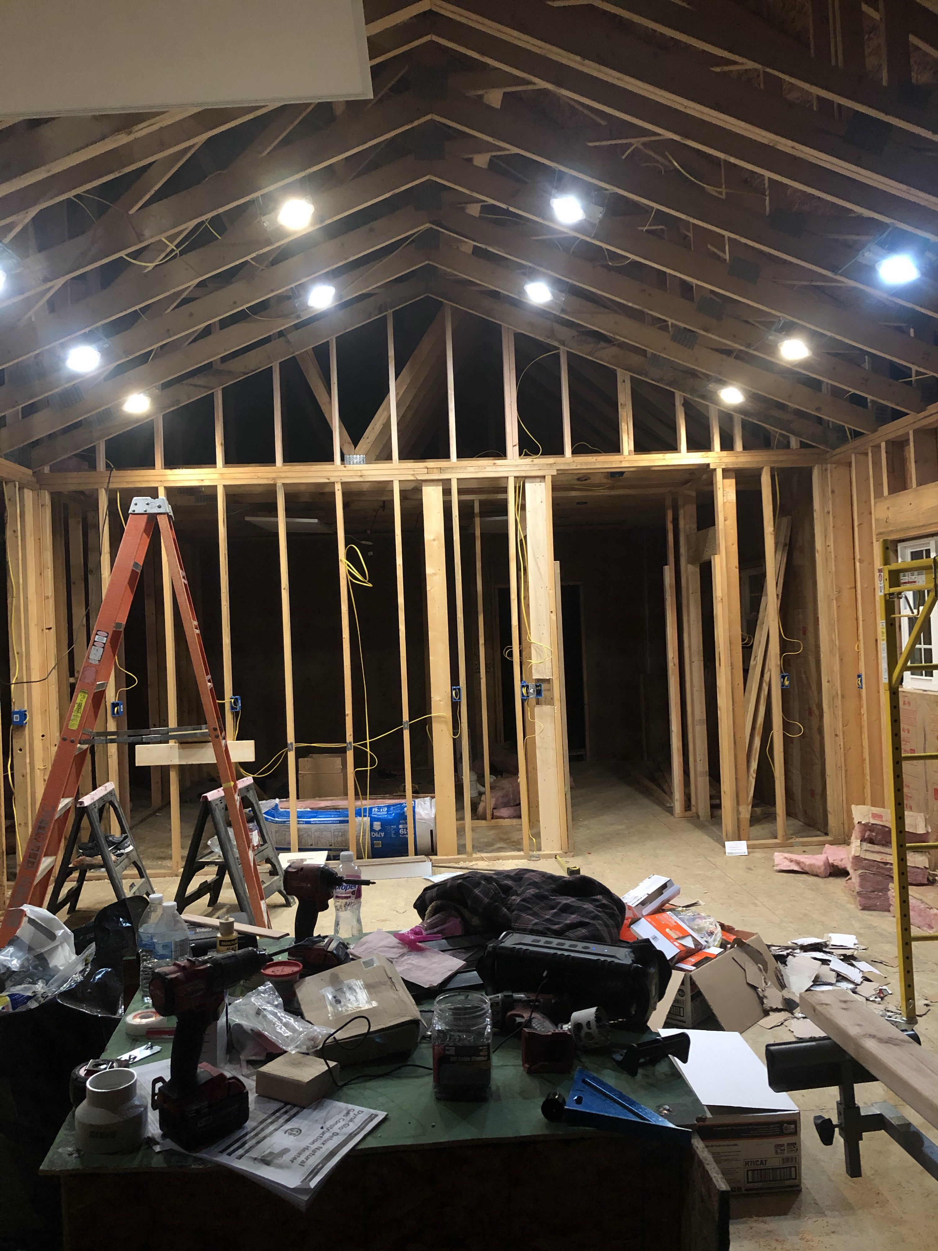

Kitchen lights functional, and I believe provide good coverage. There will also be two pendant type lights over the island. Cans are on a dimmer if full power is t needed/wanted.
Same with living room can lights. There will also be two ceiling fans/lights. All on 3-way switches and cans on dimmer. We wanted plenty of light when needed.
Also got the gable on living room side of cathedral ceiling framed including ceiling nailer.

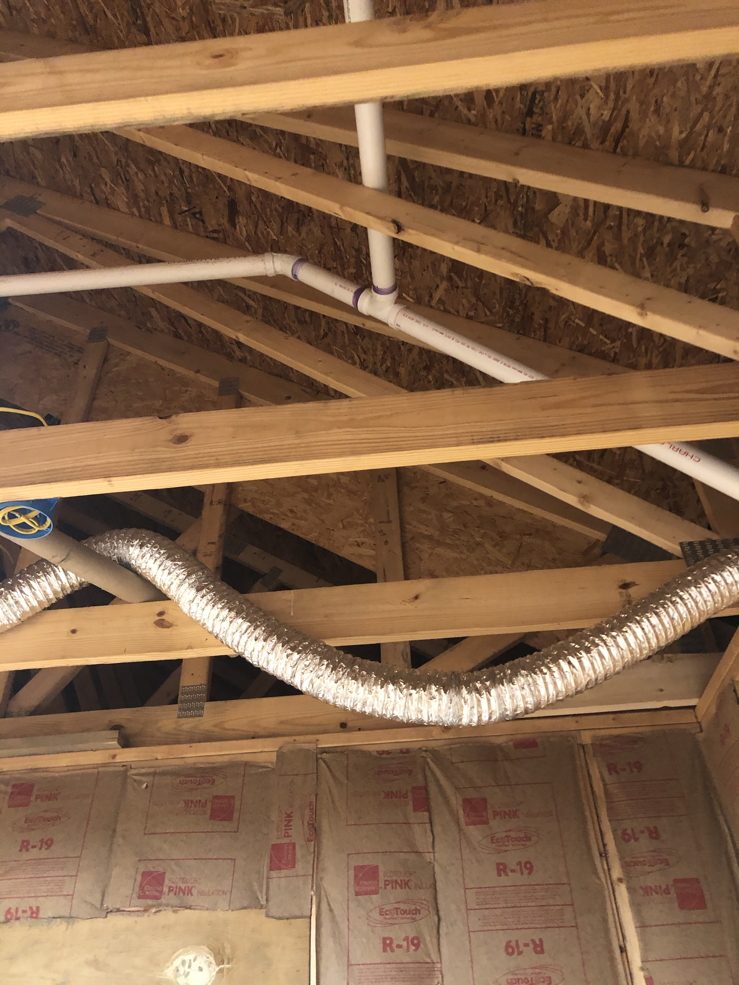

In addition, I also managed to get the 4” plumbing drains in on the kitchen, side of the house. Kitchen sinks and vent connected, washing machine and vent connected, still need to connect the master toilet, bathtub, shower and sinks connected but all tee’s are already on the 4” drain.
A second drywall contractor showed up this morning right at the time he said he would. Being on time is something I hadn’t seen too much of, so bonus points for that. I liked the guy, and know 2 people who used him on new houses and were very happy with his work. He was about a $1,000 cheaper than last guy too, so hired him. He can get to it in 3 weeks. That works well for me, should have no issue being ready by then.
Pretty good weekend other than the purple primer I spilled on my concrete floor. Mostly came up without issue, but some staining before I got it cleaned up.....adds character I guess.

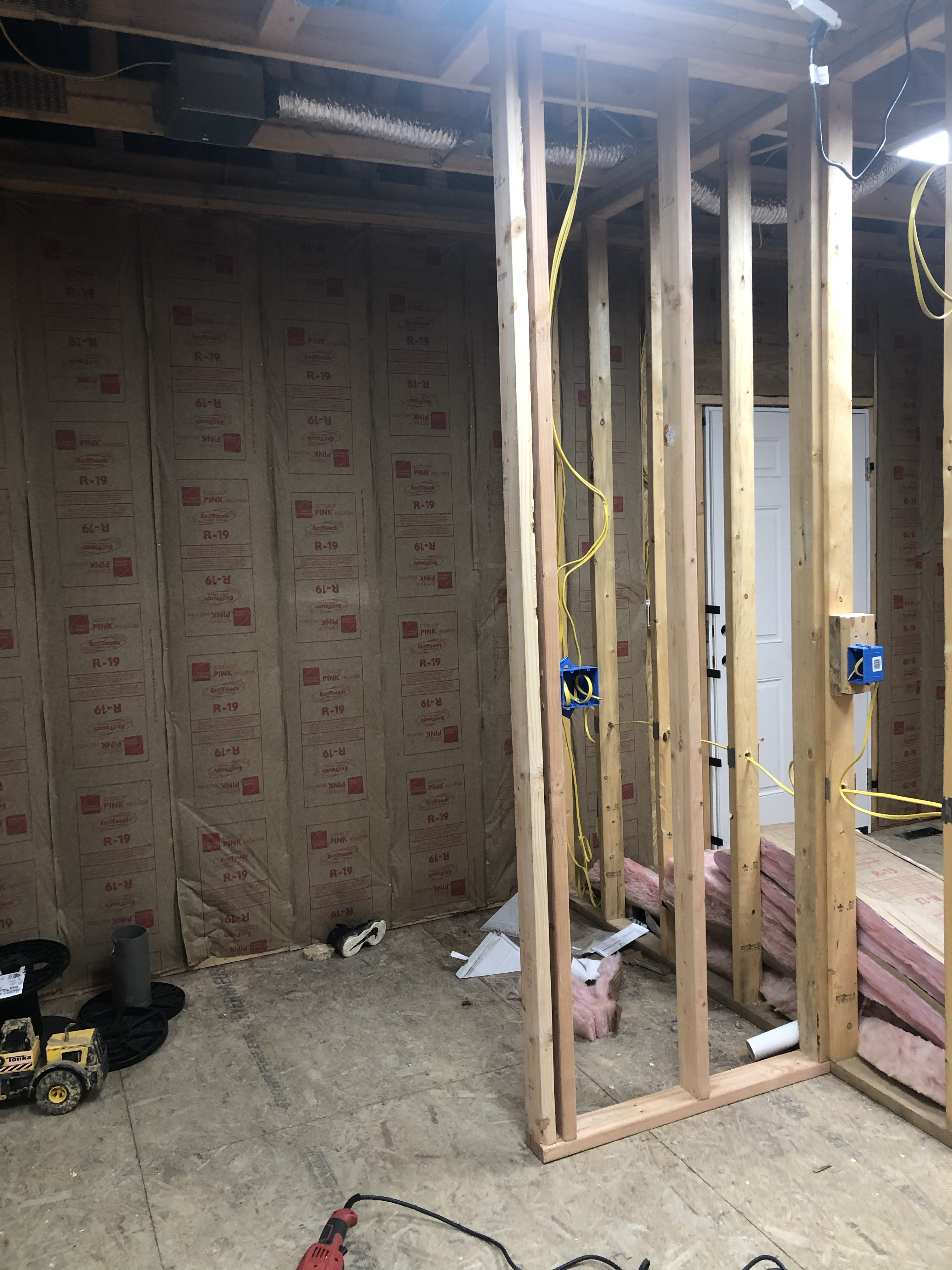

Work continues. Got all of the plumbing vents completed and the last toilet plumbed into the main drain. All lighting is complete except garage and porches. Finished running wires for the front and back porch receptacles. Built the master shower wall, wired the master bathroom, and installed the door from mud room to the garage. Got more insulation in as well. Moving along, but not fast enough. Going to take Thursday and Friday off work to make a 4 day push to finish all the electrical and plumbing, including gas lines.

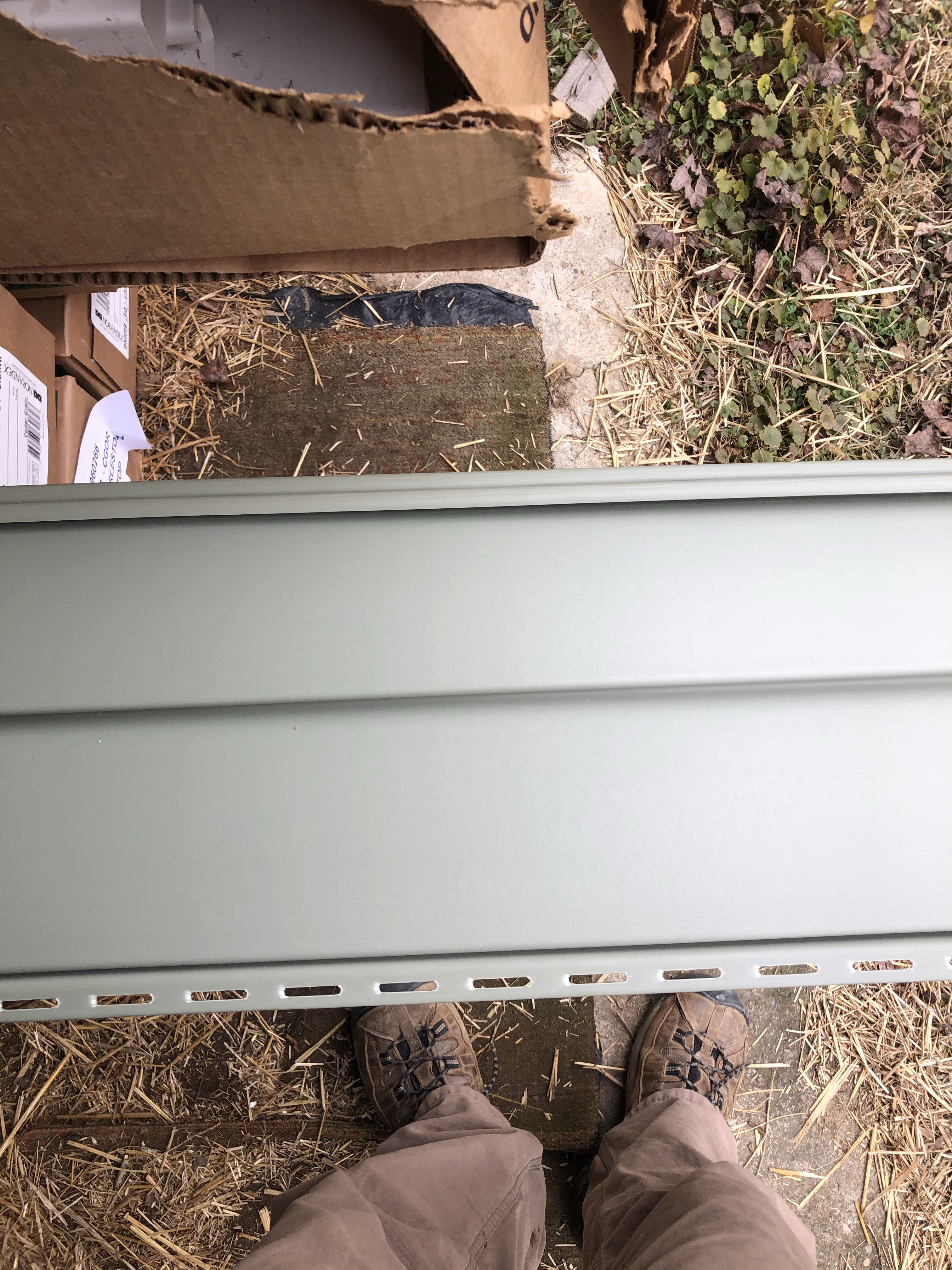

Siding was finally delivered last week. Color turned out exactly as we had hoped.

Looking at your outlets, I thought of another issue that I've dealt with a few times. I've had installers cover up outlets and leave them covered up. It's extremely frustrating looking for an outlet box when you connect all of your outlets and there isn't power after one of them. Since it's cheap and easy to take pictures, I always make sure to take them of every room, every wall, before they hang the sheetrock. 90% of the time, I do my own sheetrock, so there is never an issue, but when a crew comes in there, you never know if one of them has issues that day, or what's wrong with his head. Having pictures will make it a lot easier to know if they covered up an outlet, and where to find it if it happens.

I definitely agree. Back when I worked as an electrician, I had that happen many times, very frustrating. I’ll be sure to take pictures of every wall before drywall starts, so I have a good reference of where all outlets all.

I take pictures of walls and ceilings prior to the drywall going on, and refer back to them year after year. It's always nice to know where wiring and plumbing is before I need to saw/drill/nail into a wall for later upgrades/renovations. Sometimes those pictures are the only clues I have to wiring or plumbing mysteries.
I have heard of drywall guys covering up can lights in the ceiling and nobody caught it until years later.
