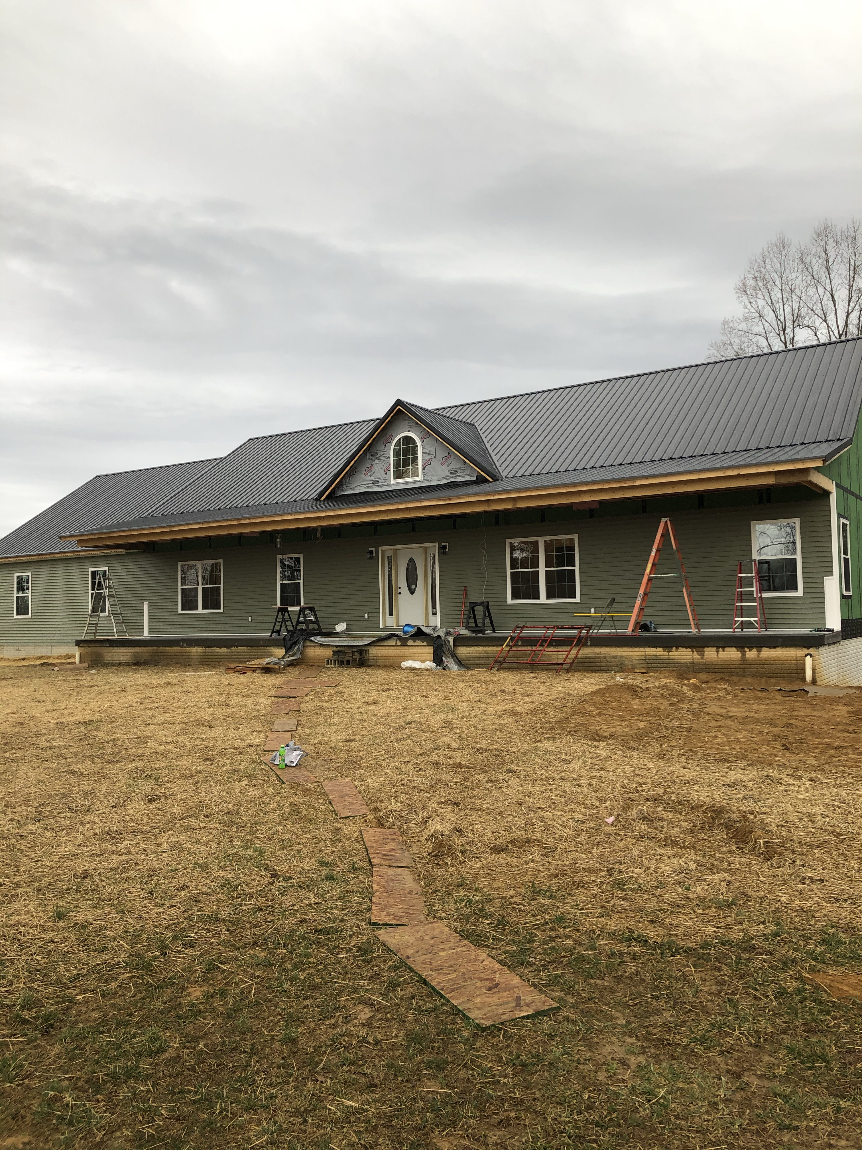

I'm dying to see what your window above the front door is going to look like!!!!
Eddie, the ordered window is different than the opening, it’s a 3x4 with round top. It was going to be 3x4 with 2x2’s mated to each side, but that one window was going to be over $1,500, and I just couldn’t do it. Should still look nice, just not as “fancy”.

That decking looks great. I've had mixed experience with the first generation products but the newer products seem pretty good. The test is how it looks 4-5 years from now! I haven't kept up with the cost -- has that stuff blown up with lumber pricing during Covid?
When I bought it, wood was at its peak. 16’ wood deck board was 28.95, and the composite was 28. Pretty much a wash after adding stain for the wood and hidden fasteners for the composite. Just figured the composite will be less maintenance long term. Not sure I’m 100% confident in the fasteners though, the screws strip easy, either the head or in the wood. I absolutely hated installing it. My knees have never hurt so bad in my life. I hope those clips surprise me on their durability.
I told my wife, knowing what I know now, I would have spent a little extra and done suspended concrete and stamped it. That said, we are really happy with how the composite turned out, especially compared to wood.
