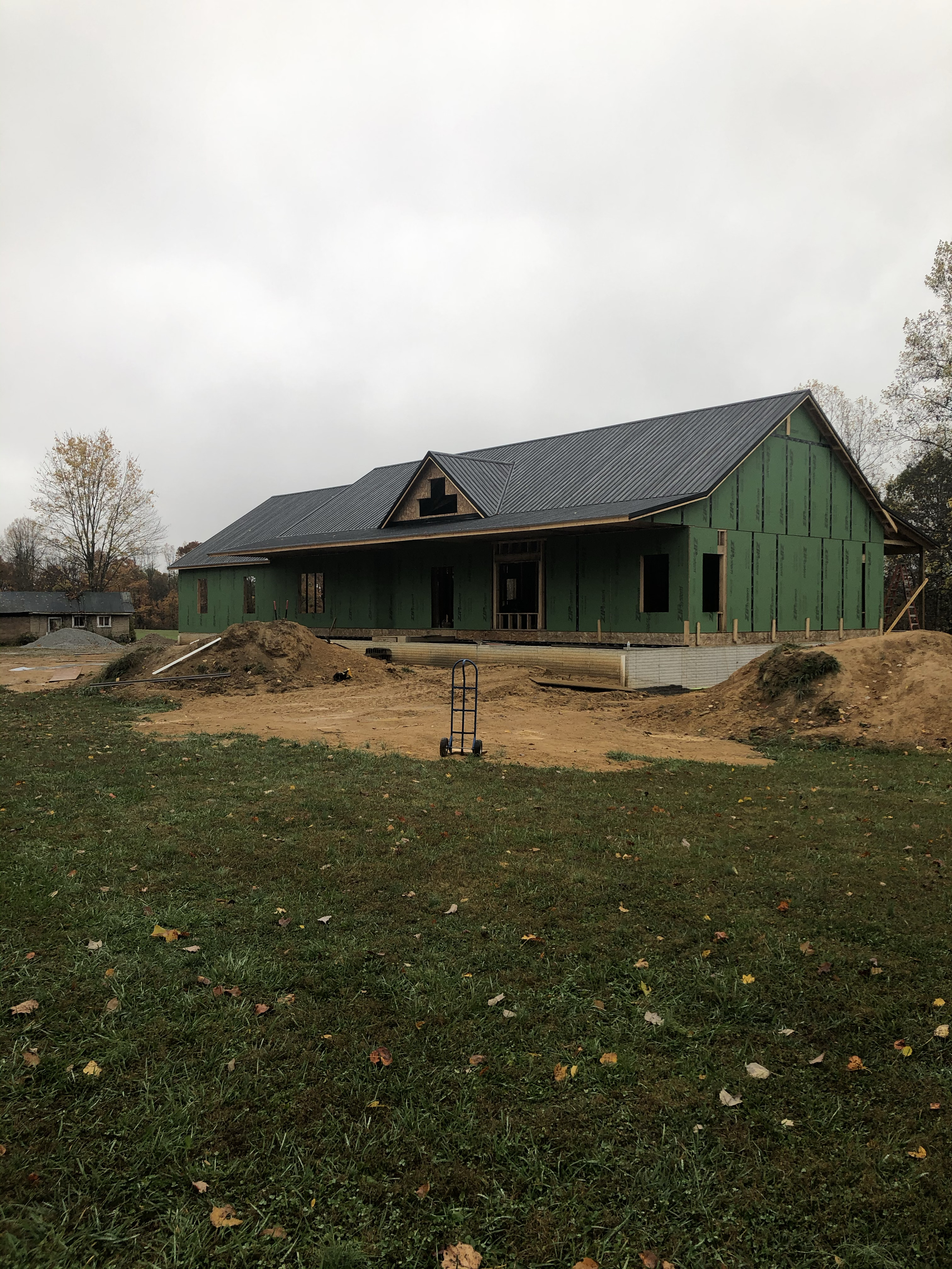

Roof was finished last week, definitely happy with how it turned out. Best part is, no more water in the house! Getting under roof is a huge accomplishment, but I can’t help to think of all the work still ahead.
I’m currently working on forming up the front porch for concrete that I hope to pour in about a week. Progress has been slow due to me nursing a bruised rib. Took a fall about 2 weeks ago that has slowed me down and certainly made me more careful.
Waiting on 40 more tons of fill for the garage, which should be the last of it. Getting ready for, and pouring, concrete will be the priority over the next couple weeks, got to get it done before winter really kicks in.
I’ve had to purchase some more lumber this past week, man are lumber prices crazy high right now. Budget taking a hit for sure.

Your roof looks really nice!!!! Have you bought all your windows and doors already? For me, that's the next big step, being able to work inside without the wind blowing through the house.
   / New House Build in WV
#120
Thanks Eddie.
Yes windows and doors are ordered. Who knows when they will show up, lead times are insane. No one stocks any doors for 2x6 walls around here either, which is crazy as most new homes are built with 2x6 walls.
I’m hoping windows show up in about a week, but that’s likely optimistic. Craziest part is they are built a little over an hour away and I still can’t get them quicker.
In the mean time, I’ll get concrete poured and decking installed while waiting.
